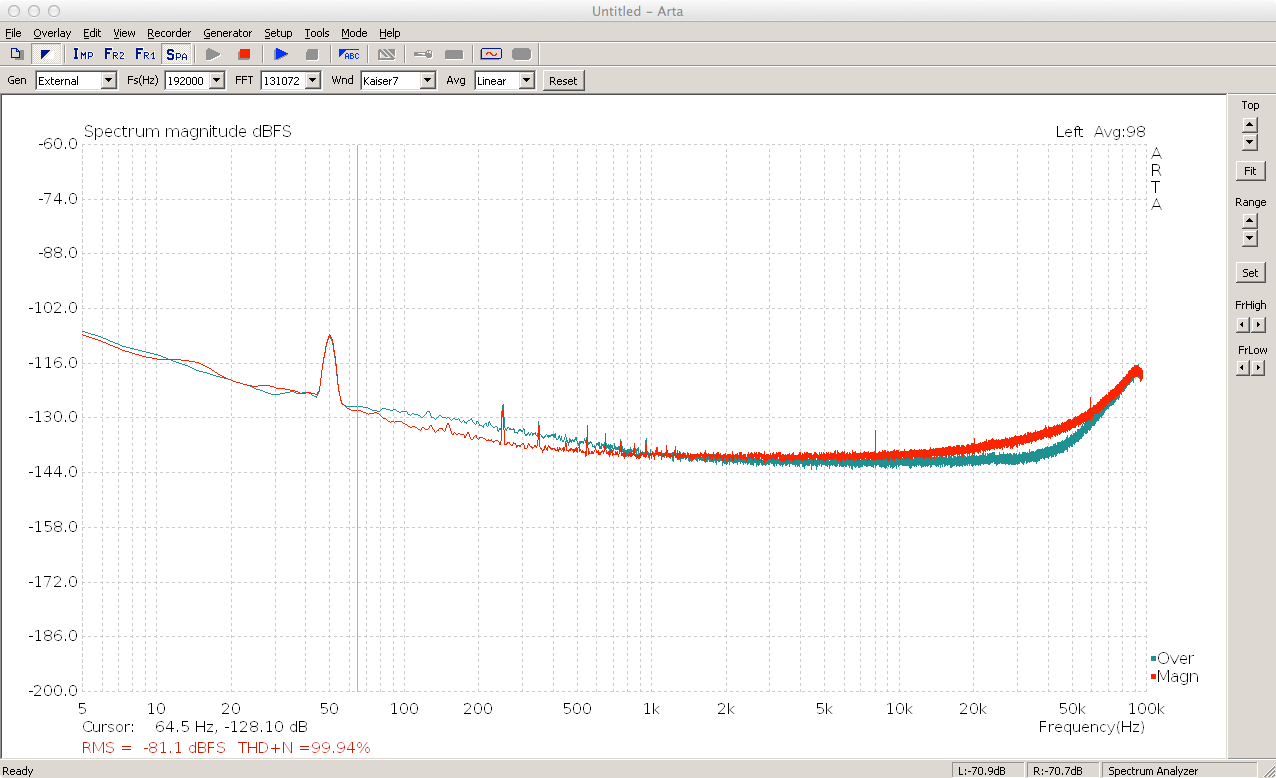

Before modding I first did some measurements of the current configuration (plus some additional bypass capacity). Which lead to a remark and a request:
Firstly, it is possible to measure vref with a sound card if it supports Pro audio levels or is AC cupeled (I however take no responsibility for fried cards).
This gives you, in the audio frequency range, much more detailed information compared to the mV you get from a scope.
For example here the Vref with a white noise signal (fs=384kHz) with additional 1000uF (red) compared to the stock configuration (green).

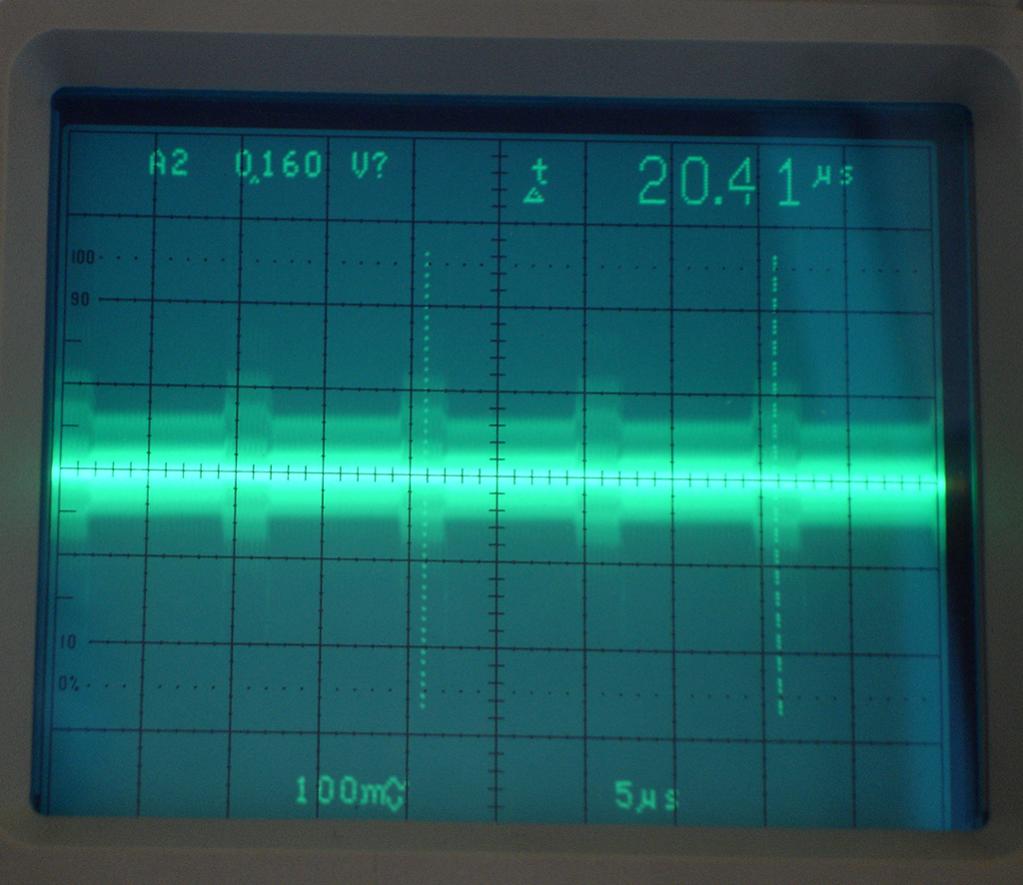

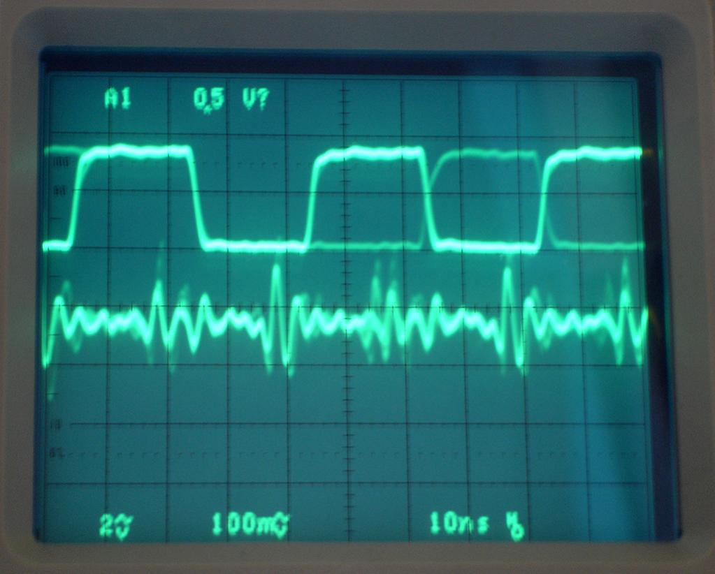

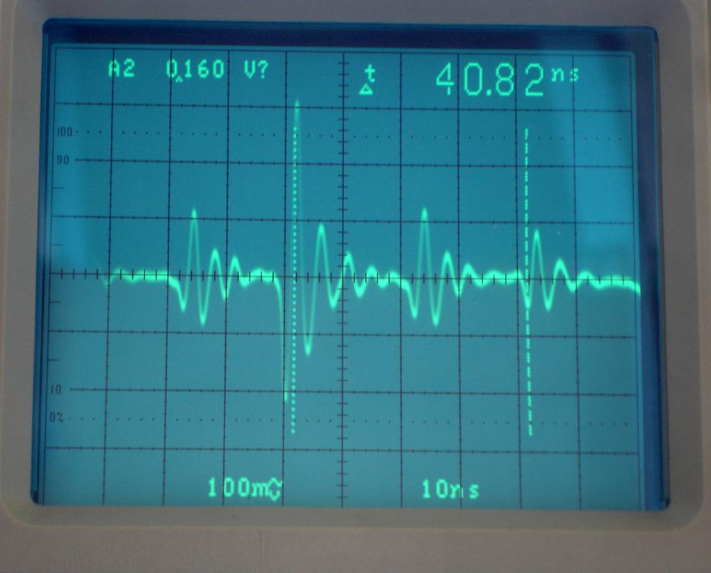

Secondly a request to someone with a fast scope to verify the following measurements (my scope is getting old and I do not trust it entirely when pushed to the limits).
The measurements were made between ground- and Vcc-pin of the MSB shift register. Measuring Vref somewhere else works too but the "signal" is weaker.
I measured a 96kHz sine recorded with fs=384 kHz and the NOS filter (this does not realy matter, at least for the two last pictures) without applying the bandwidth limiter of the scope. And I see peeks of 100-200 mV magnitude but oscillating fast.
Zooming in, shows that the main oscillation pattern repeats (twice?) with the shift register clock input (upper signal, ~24.5MHz, in second picture) but has a faster oscillation of ~ 4nS or 250MHz.
Putting a fast capacitor (Wima FKP, Mica) over the ground- and Vcc-pin tames the magnitude but the signal is still there.
The big bypass capacitor has no influence on this signal. The fast capacitor has no influence in the audio range.

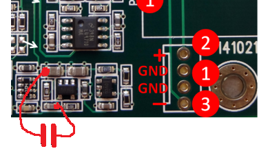

i have proposition to mod this. this is not ideal approach but...
resistor ladder drawing current around 5mA. So, try to connect the 3 kOhm resistor to the legs of Vcc-Gnd. possibly it will decrease the oscillation. please see the attachment.

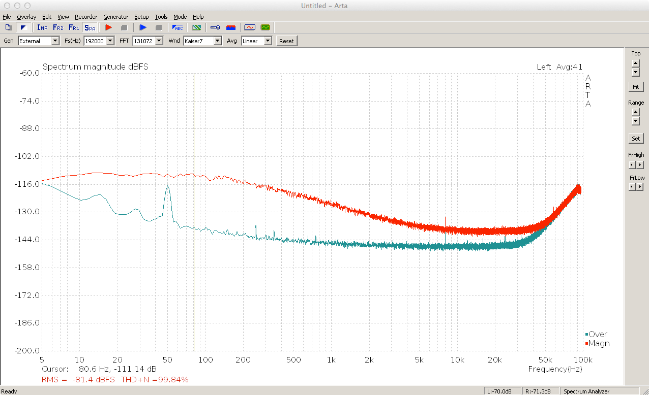

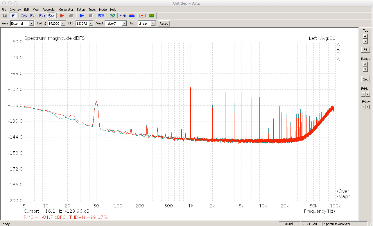

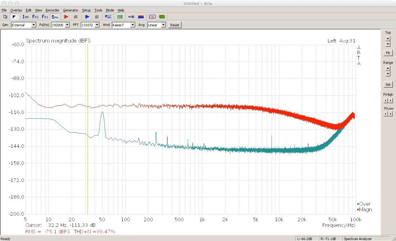

Some "sound-card measurements" of Vref (4Vpp would be -7.5dBFS).
First, to compare, Vref when playing white noise in the stock config (green) and stock plus 1000uF (red).

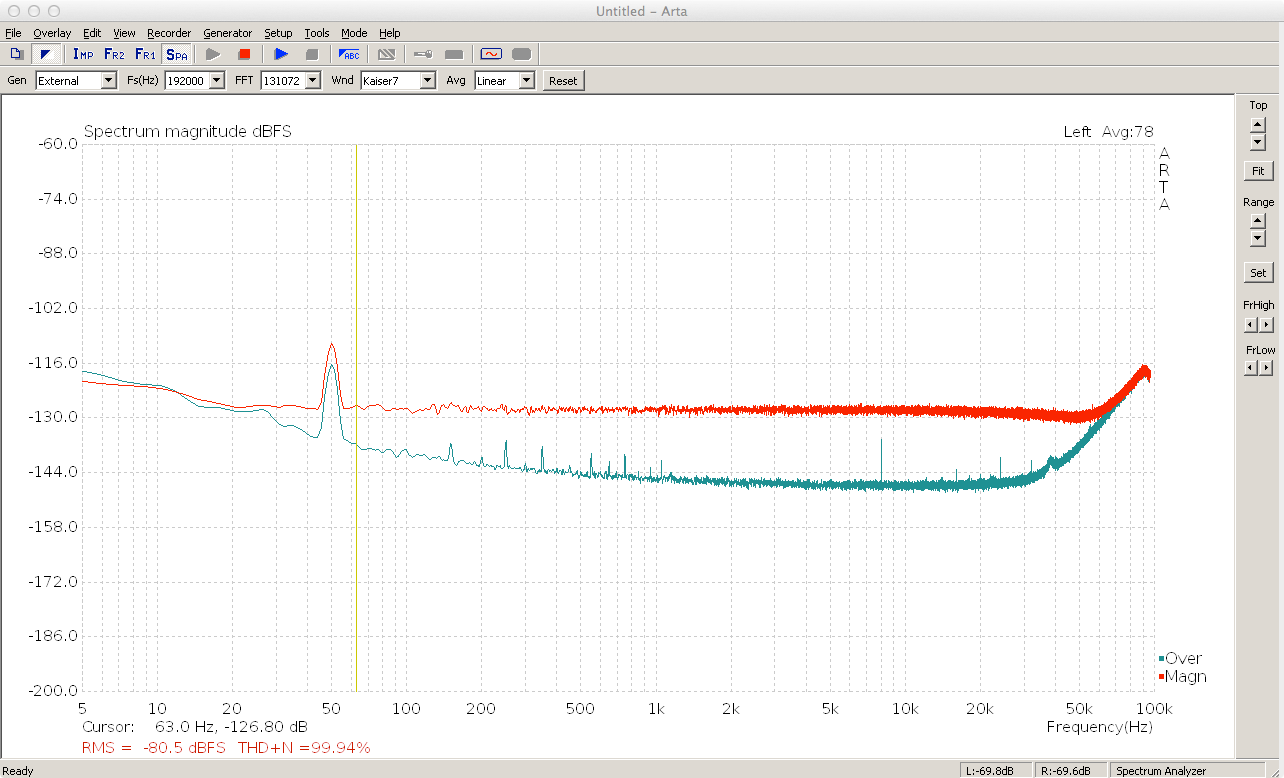

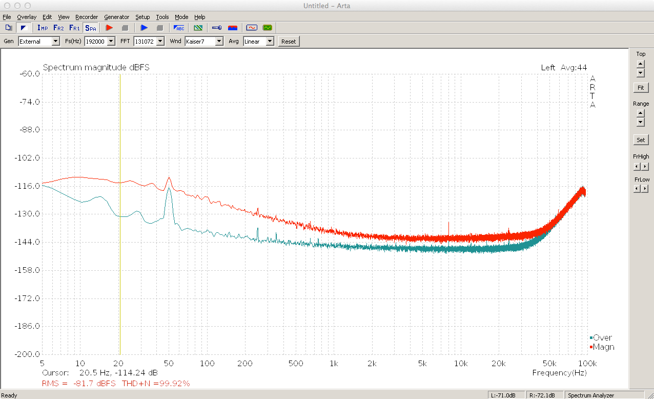

Next the "factory mod" and variants:
The red curve is Vref when playing white noise, the green one (if nothing else said) Vref when no signal played (which coincides more or less with the noise floor).
1. a) factory mod, b) factory mod +1000uF, c) factory mod +6800uF (over 1000uF green), d) factory mod +17000uF (over 6800uF green)
1a Mod wnoise over nosig.png1b mod wnoise1000u over nosig.png1c mod wn 6800u over 1000u.png1d mod wn 17000u over 6800.png

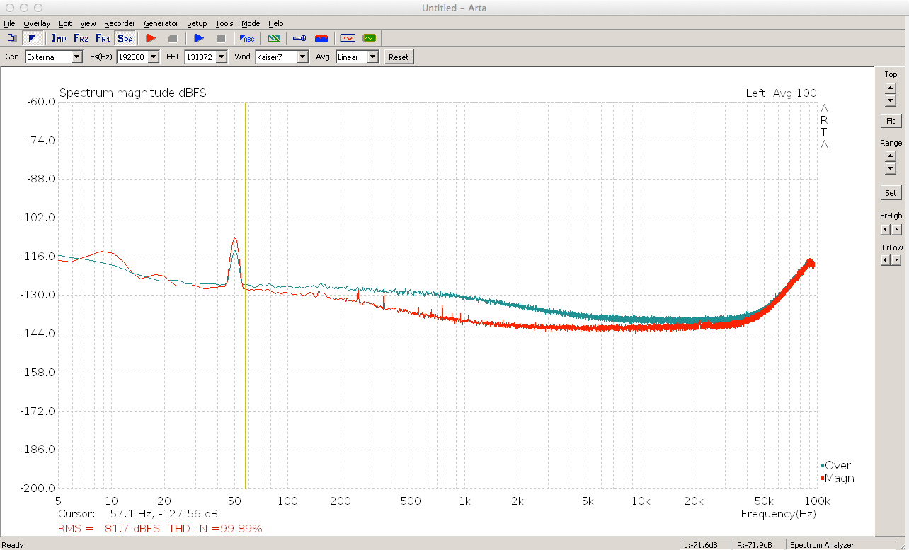

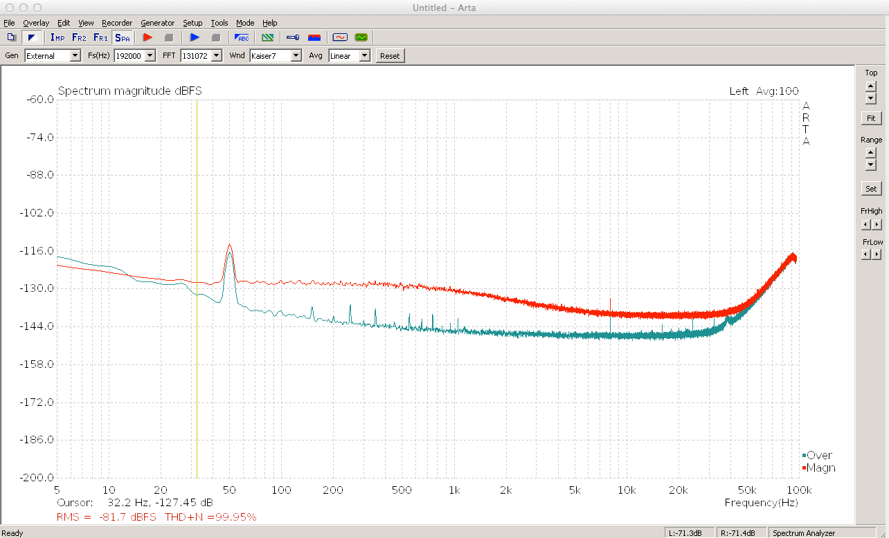

2. A variant of the factory mod using 1 Ohm as load resistor instead 0.1 Ohm
a) 1 Ohm factory mod, b) 1 Ohm factory mod +1000uF, c) 1 Ohm factory mod +6800uF
2a Mod 1O wn over nosig.png2b mod 1O wn 1000u over nosig.png2c mod 1O wn 6800u over nosig.png
P.S. the high frequency behavior on the oscilloscope does not changed due to the factory mod. But as I said, I am mot sure if this not an problem of my oscilloscope. The high frequency behavior needs to be verified by independent measurements.

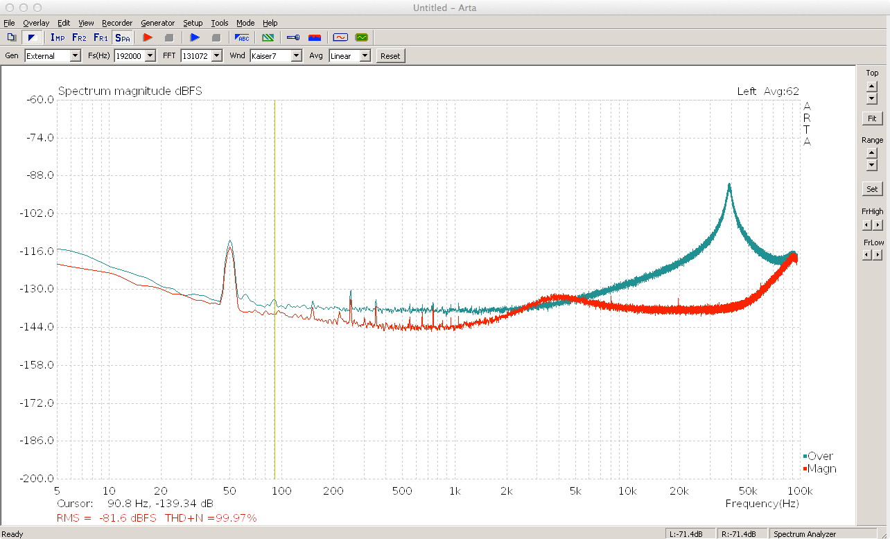

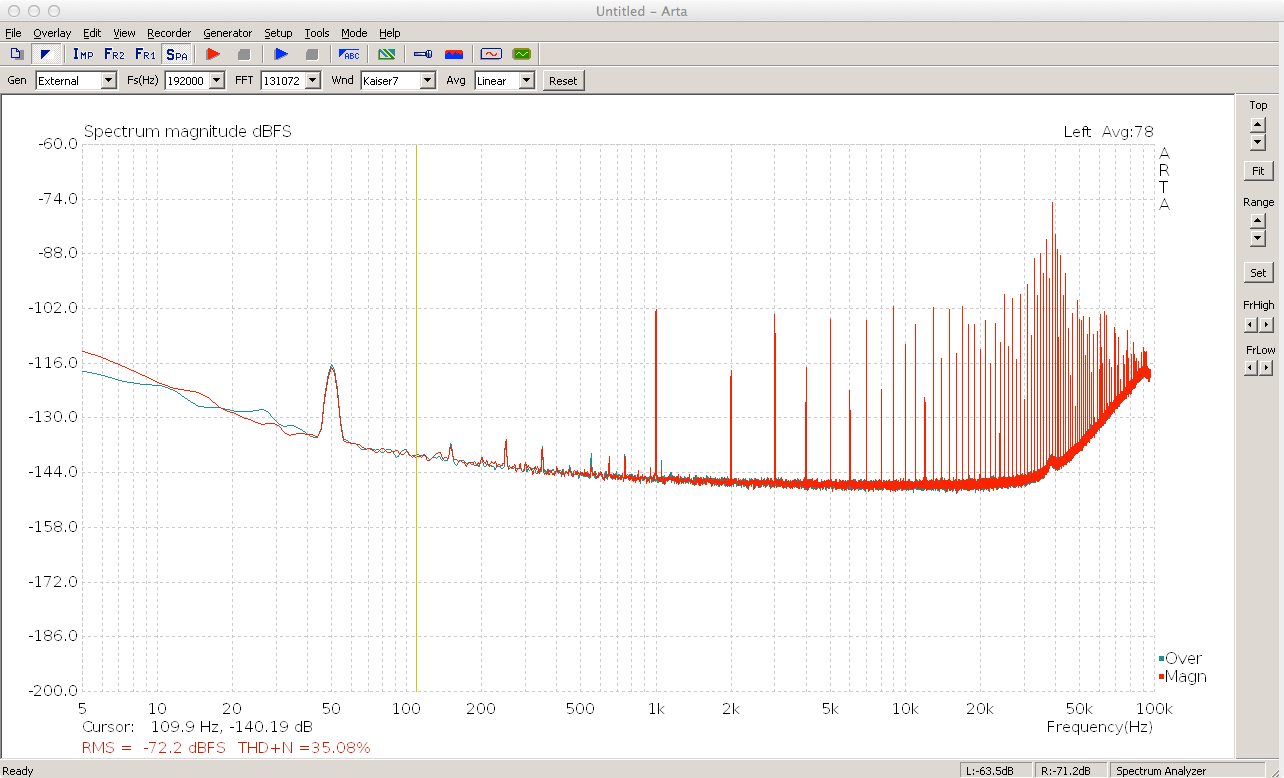

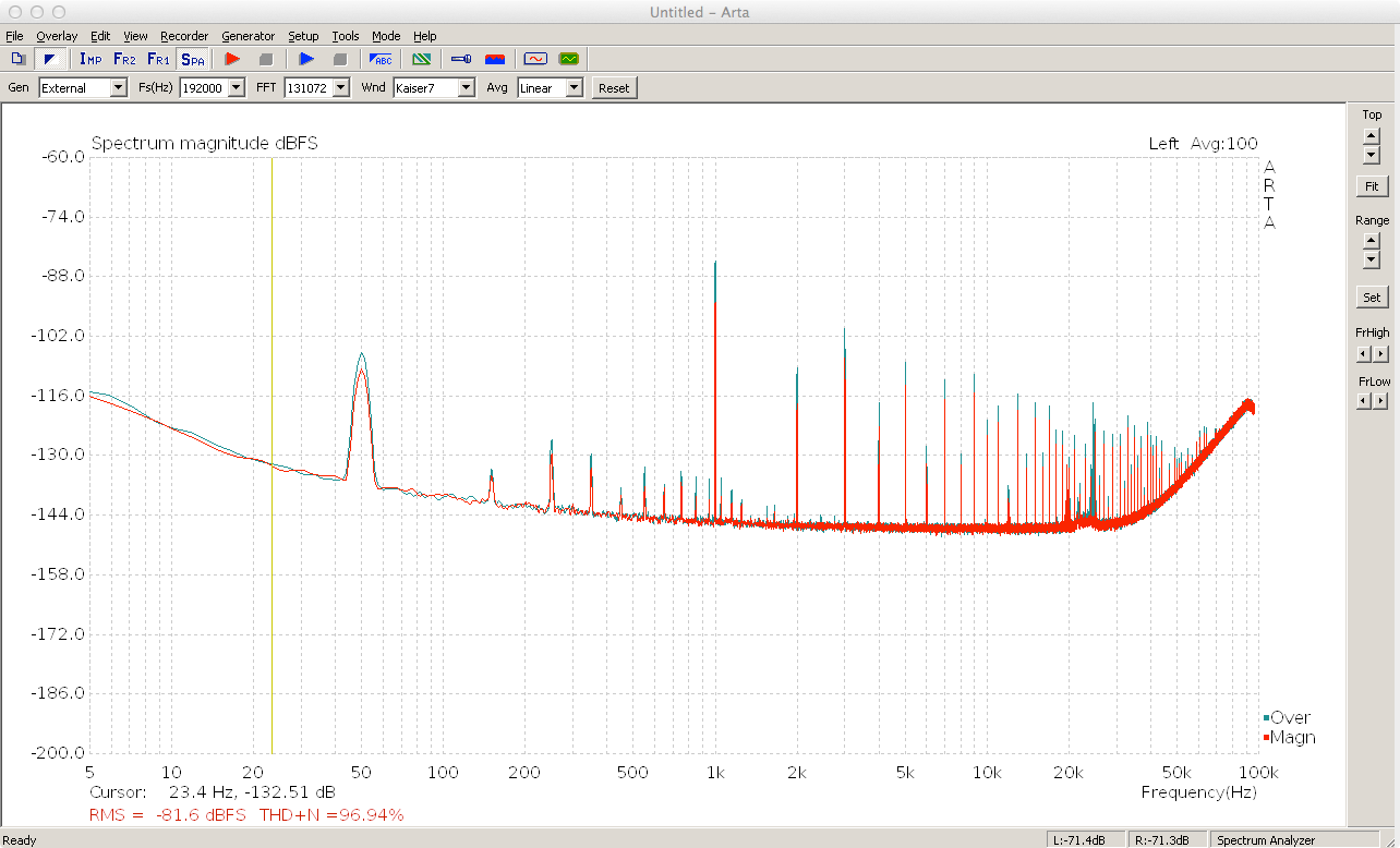

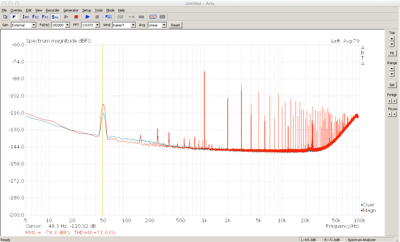

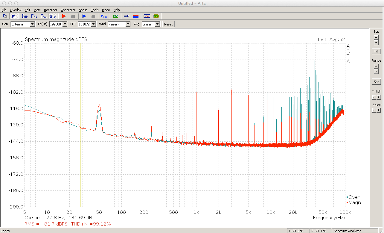

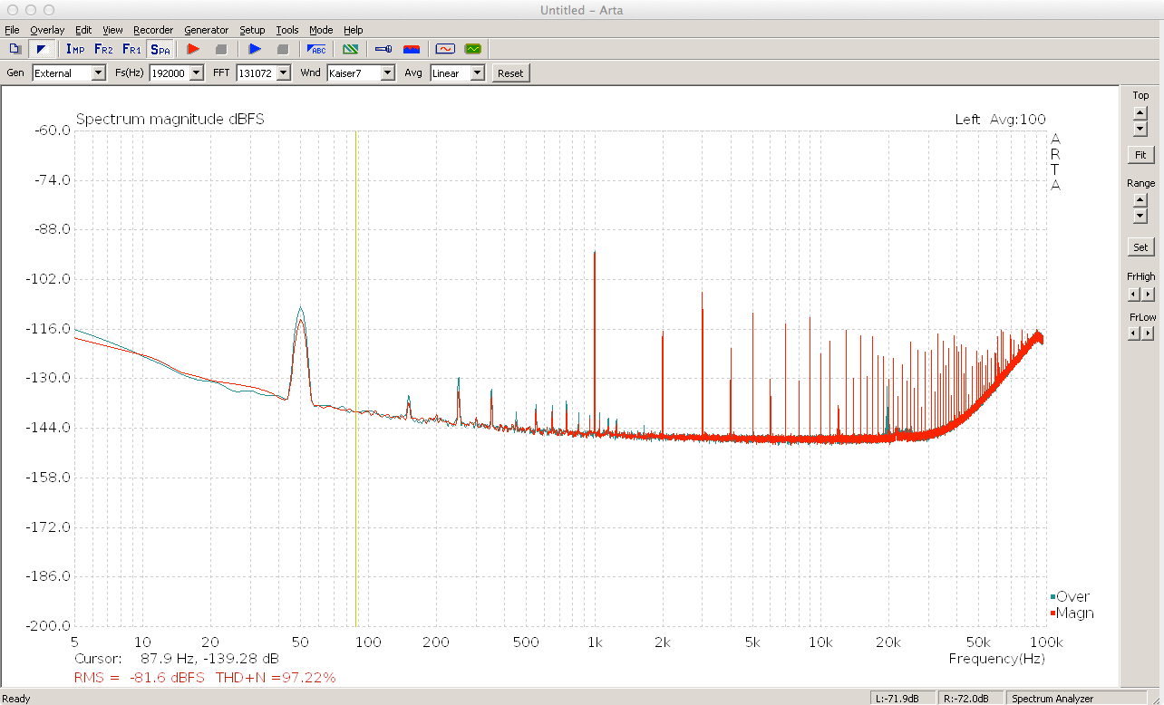

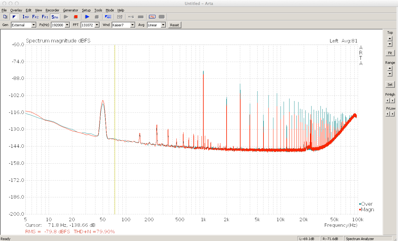

And "sound-card measurements" of Vref with a 1kHz signal playing:
First a) stock (red) over no signal (green), b ) stock+1000uF (red) over stock (green), c) stock+6800uF (red) over stock+1000uF (green)
Then a) factory mod (red) over no signal (green), b) factory mod+1000uF (red) over factory mod (green), c) factory mod+6800uF (red) over factory mod+1000uF (green), d) factory mod+17000uF (red) over factory mod+6800uF (green)
4a mod 1k over nosig.png4b mod 1k 1000u over 1k.png4c mod 1k 6800u over 1000u.png4d mod 1k 17000u over 6800u.png
View attachment 495821View attachment 495822View attachment 495823
View attachment 495824View attachment 495825View attachment 495826View attachment 495827
why there is a strong peak of 50Hz?
