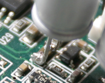

So i soldered some conventional 220u electrolytes on the ceramics and ruined those and the ones next to those (shorted).
It was the first small smd i ever touched.
Is 250 deg really too much? I have a large flat tip, maybe it has too much heat capacity?
Can't imagine you getting your solder to melt at all at that temperature.
And the stuff they use for production is even harder to melt.
You will need a small tip.
How I did it:
First tin the ends of your caps and put a little of your solder on the ends of the SMD caps - you can tack one end on and then be able to make a real solder joint on the other end. Then go back and resolder the first side.
Don't be tempted to use too much solder. You will just have to go back and clean up the mess. In this case, better to heat a little too long than not long enough. You want that minimal amount of solder to spread evenly.
How I did it:
250 is way too low, for leaded soldering (the easy stuff) I use 320°C, for leadfree soldering (the terrible stuff) I use 350-360°C.Is 250 deg really too much?
This DAM board is probably leadfree.
Pretinning both the dam and new cap leads are a must. It makes it all the easier as things simply melt together when you mount the caps.
250C is way too low given the amount of ground planing in the board.
Use lots of flux and desoldering braid to fix that. 280 degree would be fine. Suggested 350 might irreversibly damage smd components.
I selected caps with 3.5mm lead spacing, cut leads to comfortable length (could be shorter...)
Then made sure polarity orientation was correct and bent leads 90 degrees for 1 to 1.5mm such that they aim away from opamp.
Then narrowed them slightly so that the snugly fit over SMD cap and would free stand without my having to hold them.
Then I pre-tinned cap "feet" and put them back in position.
Heating one side while holding the cap down, allowing to cool completely before heating the other side.
