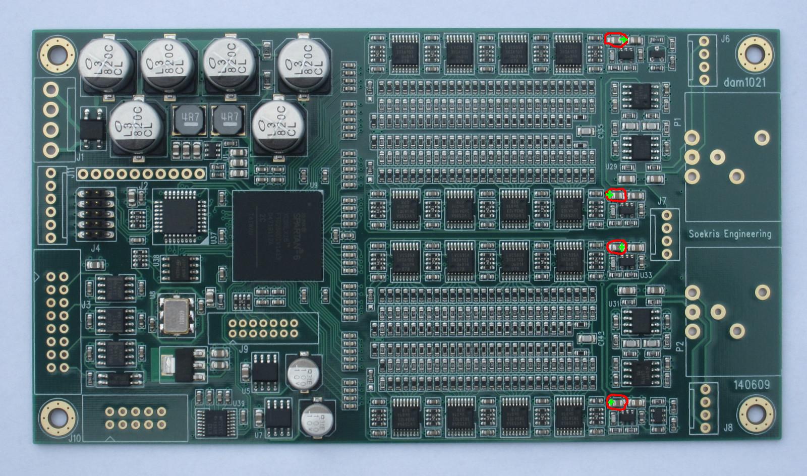

A Couple of notes:
1) The vref buffer design are unconditional stable with large capacitance, so you can hang on as much as you want, but 220uF to 470 uF low esr / polymer on each of the four vref supplies is a good choice.
2) It's unnecessary to add multiple smaller capacitors as the PCB have power planes with smaller ceramics at each '595.
3) You can also get 47uF X5R 6V3 ceramics in 0805 size, easy to stack on top of existing capacitors....
4) Please don't try external vref supplies, they're not needed and the risk to ruin your board is great.
The vref power supplies is something that I'm already looking at for next rev, will advise recommended modifications when I'm ready....

To make it easier to add capacitors to the vref supplies I added some markings to the dam1021 photo.
The red markings are the four main capacitors on the vref lines, the green plus is the polarity.
Note that polarized electrolytic capacitors need to be mounted correctly and they need to have very low esr, less than 50 mOhm, around 20 mOhm would be really good and that usually mean polymers.
Ceramics capacitors are not polarized and have very low esr, so those I will recommend, 1-2 pcs 47uF X5R 6V3 0805 added to each rail will make a large difference in noise/ripple on the vref rails.
Personally I don't believe that removing the op-amp load should make any difference, there I agree with rickmcinnis about own perceptions....

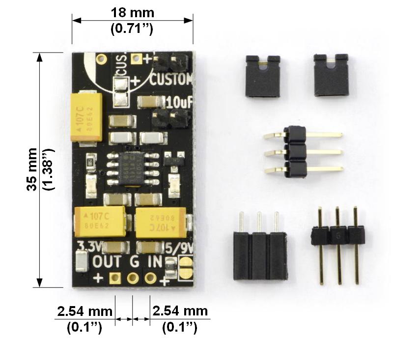

445380d1414356975-pulsar-clock-ultra-low-noise-ocxo-pulsar-power-board-items-package-dimensions.jpg
https://drive.google.com/file/d/0B4JU1DLmHzHsaklCMDl6bWFuNmM/edit
I like this one very much.But here I have close to Soren's opinion on achievements and not waiting for the same level of progress in comparison to mod 2-3.
