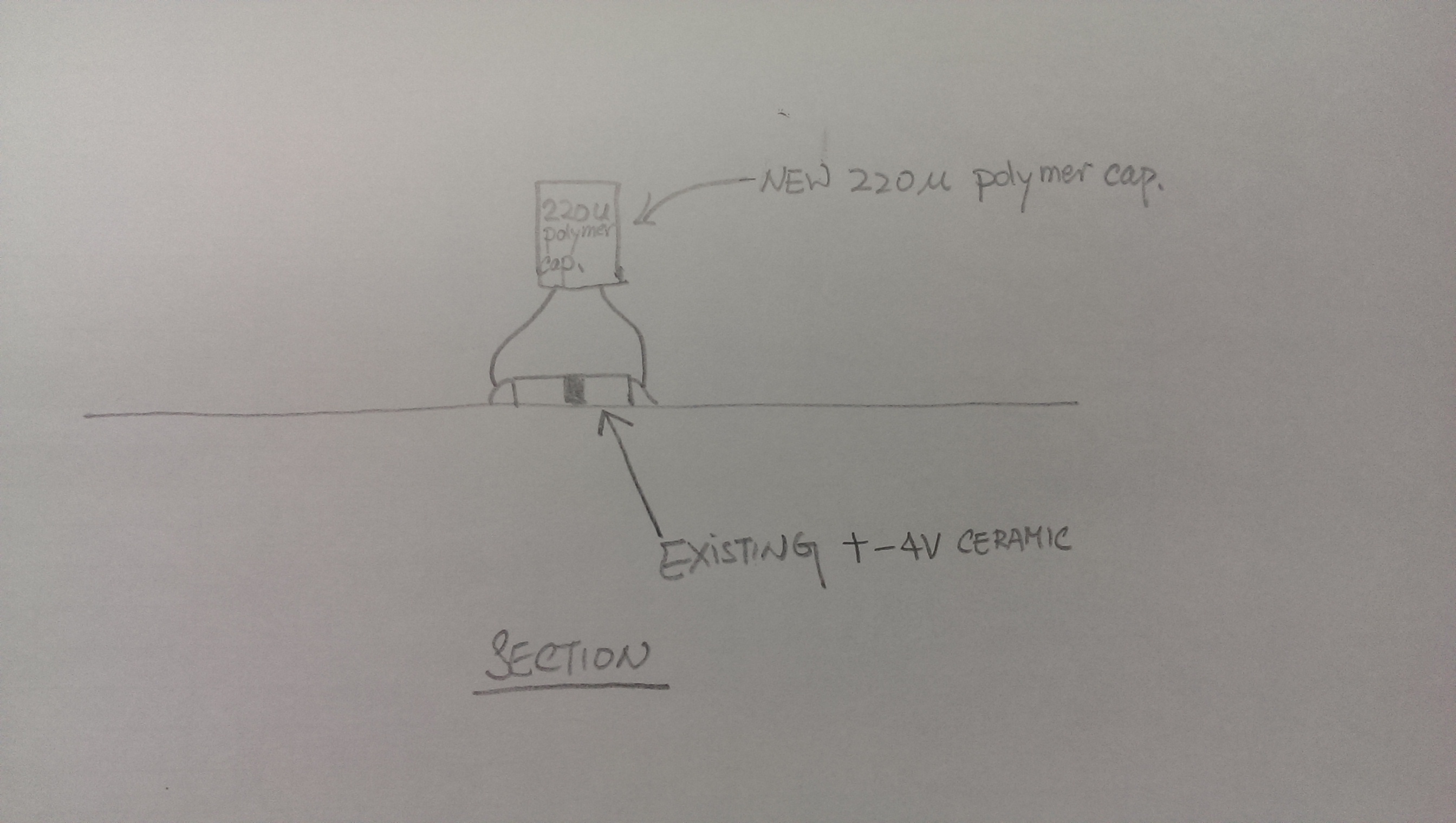

.... but the exact value will be random according to the actual vbe of the device used. Hence all the good work done by the circuity to this point to keep both +/- rails exactly the same will be undone and additional distortion will be end result. I agree with Soren that the main source of this temporary fix is the 220uf capacitor and not the transistor.
A transistor influence on the Vref is the subject of theoretical disputes! I prefer to check everything on practice. From practical point of view, the distortions are not changed significantly without capacitors. More truly, they are changed by the shape more than by the size. Sure, the biggest influence to noise reduction done by additional capacitors. I already supported Soren’s proposition to check the impact with capacitors only (without using transistors). Now I have no nearest plans to check it again due to the soldering complexity.
So I propose you to start implementing Soren’s proposition in practice and see the shapes of signal on register’s legs, for sure it has to be the 12 KHz (full scale) to the DAC input. And pls check the AC part of +/-4 V on the register's legs. And again, put 20 Hz to the input and check Vcc again. As well please public the pictures in both cases. 🙂

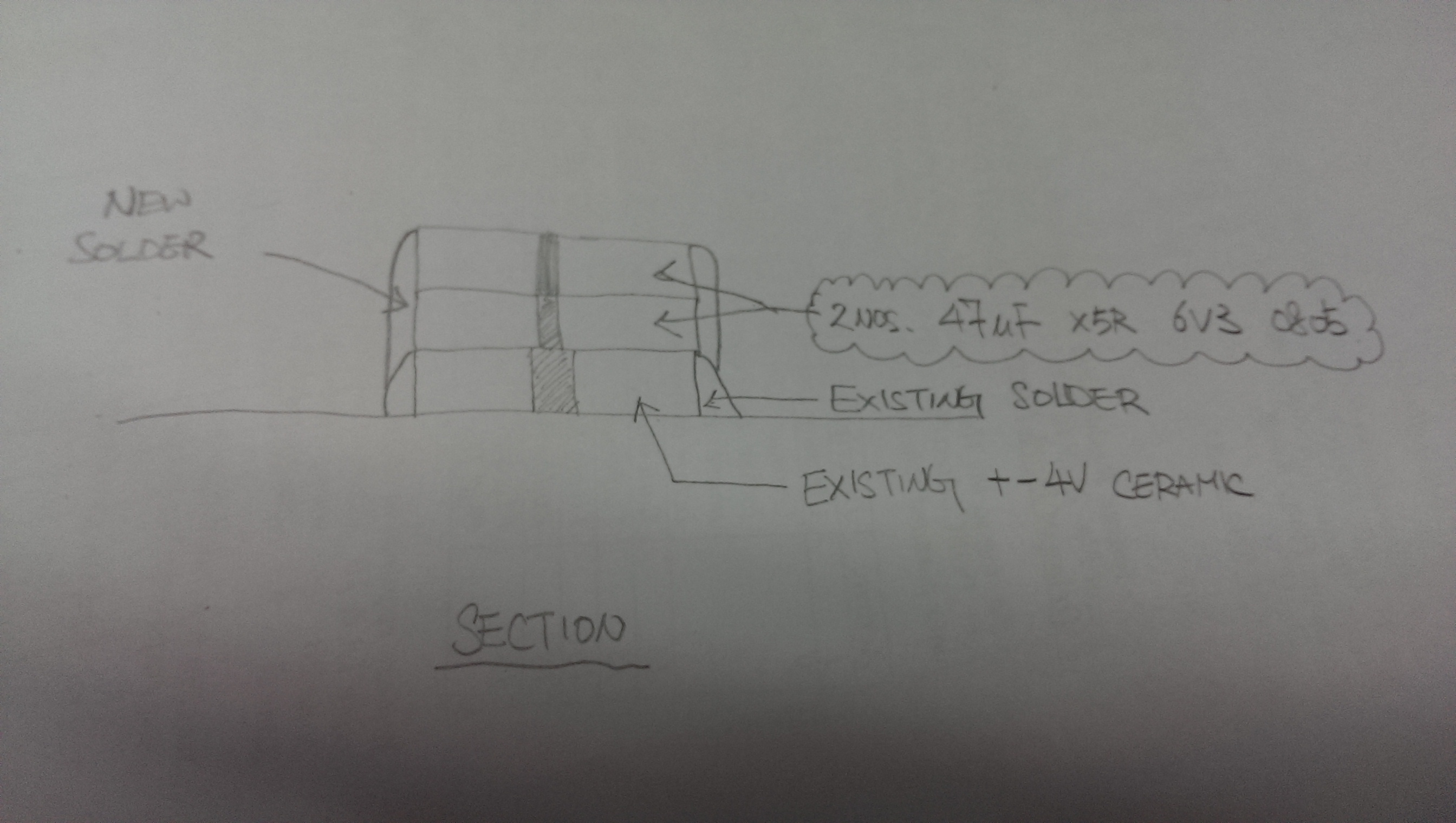

From Soren recommendation to use 47 uF x5R 6V3 0805, the connection will be like as shown picture??
Thanks so much
Exactly.

Correct. And these caps don't have polarity to worry 😉.From Soren recommendation to use 47 uF x5R 6V3 0805, the connection will be like as shown picture??
Thanks so much

Increasing cap capacity didn’t affect significantly to Vref frequency with maximum distortions. 12 KHz still is 12 KHz, even after adding 220uf.
Seems that digging process going in wrong direction…
