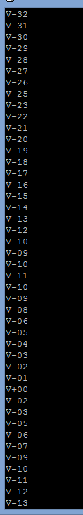

Well it did not work out via the GPIO headers direct.
I guess the dam umanager doesn't wake up with 3.3v (I think Søren said this before) but needs 5v? - it is supposed to work with a later firmware.
Connect the brainbox usb-serial into the rpi and connect that to the dam1021 works just fine 🙂
Just testing the 10k linear pot when connected to the umanager with the rpi. Output is as this:
It should not be a problem really connecting it to a small lcd display controlling with a motorized potentiometer?
Does anyone know of a "cheap" remote controlled linear 10k (or can I use other values?) motorized volume control potentiometer kit?

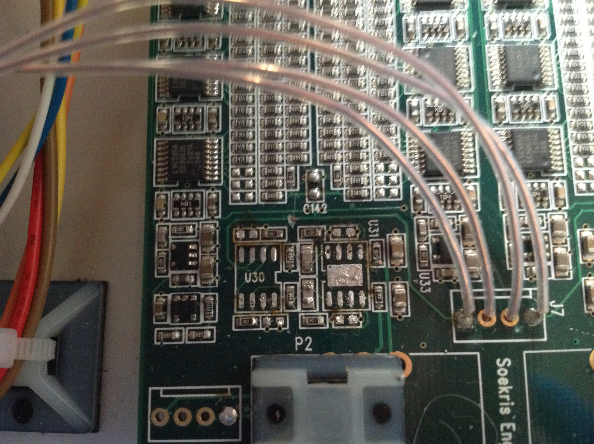

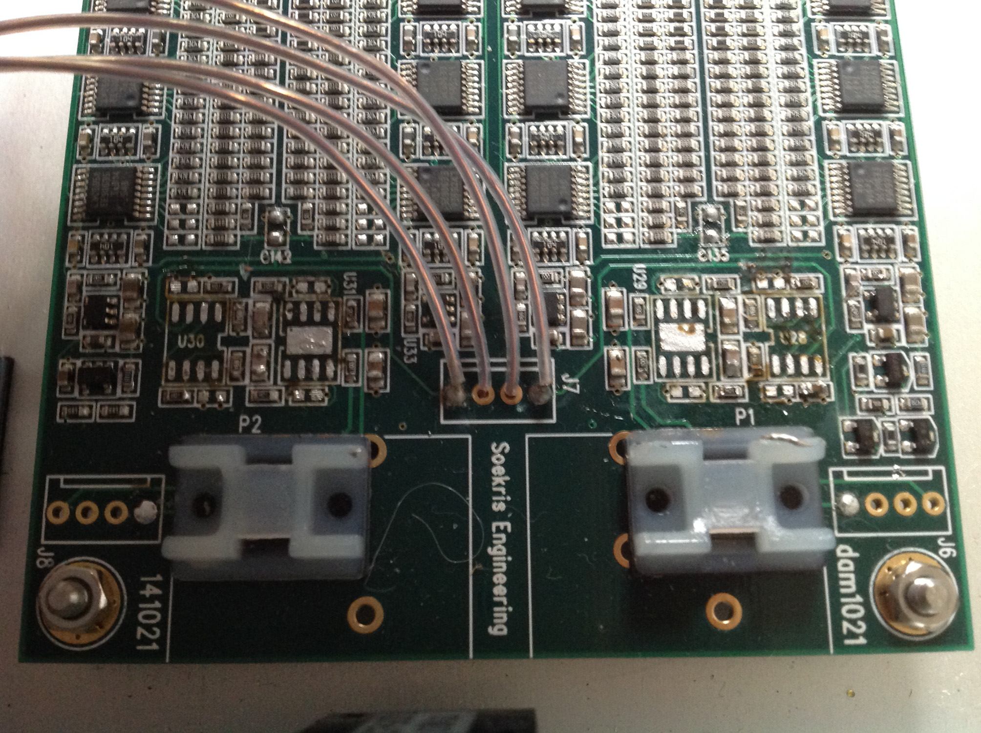

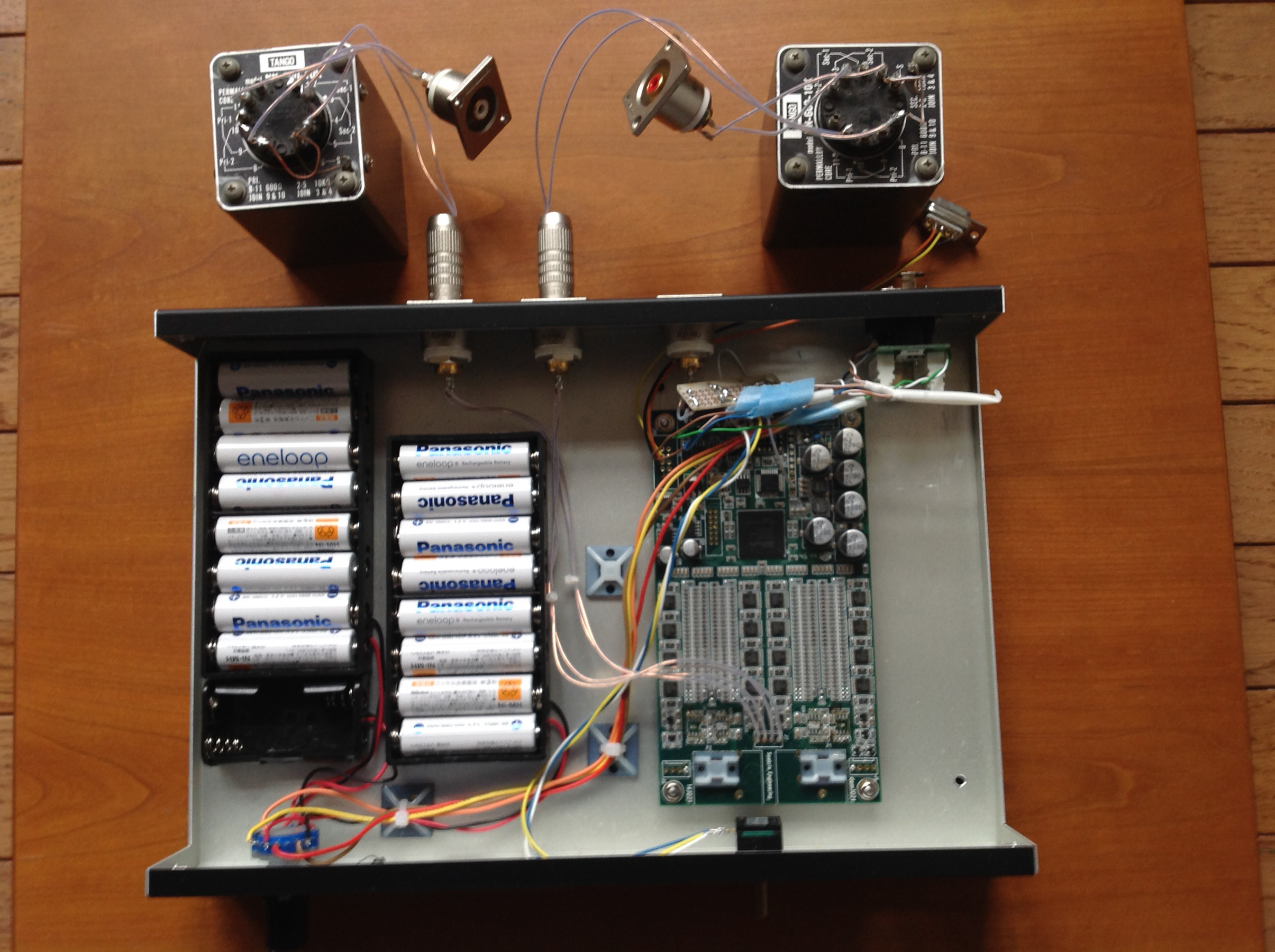

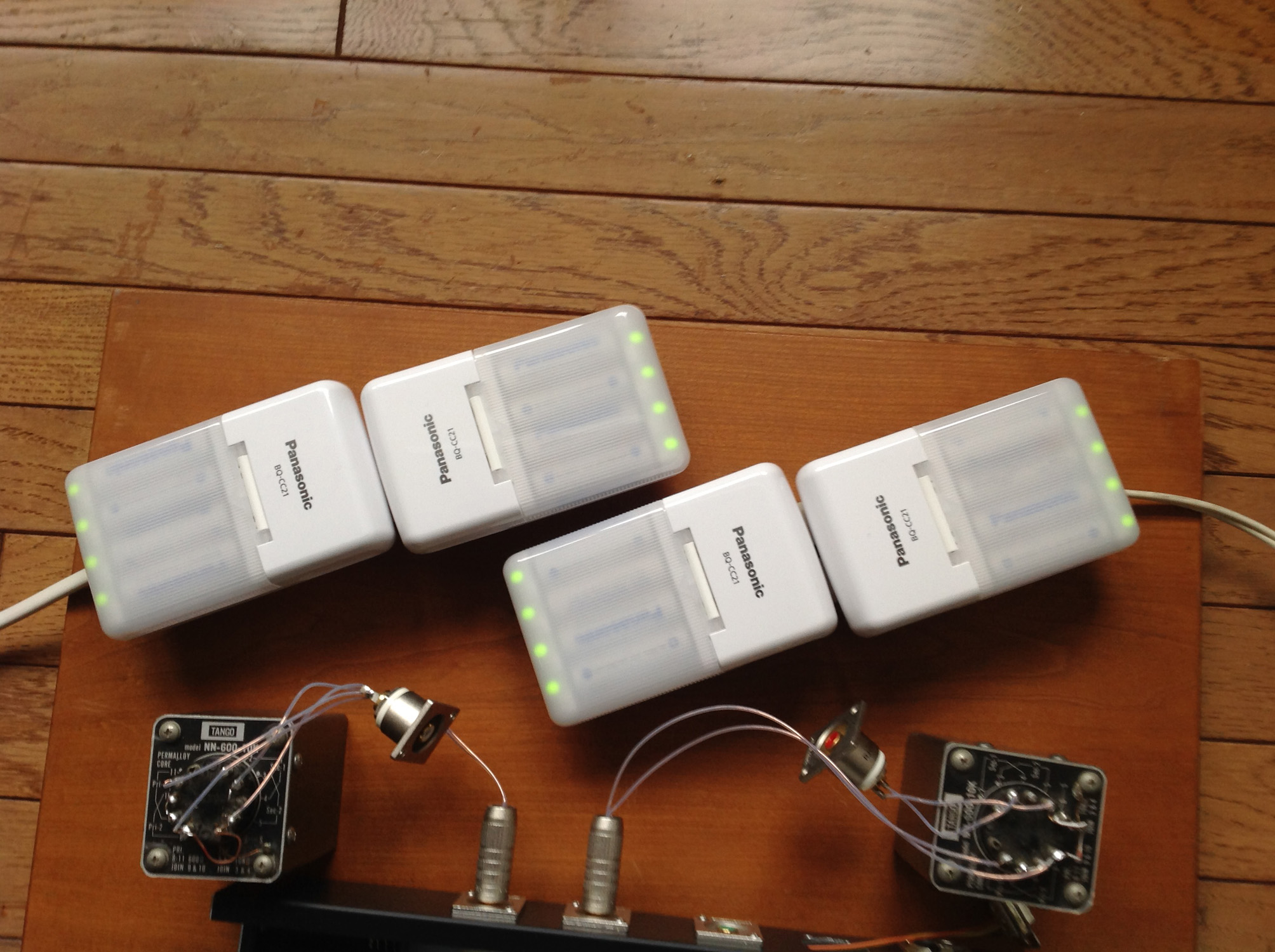

DAM construcion - yet another way
Here's some pictures still under construcion.
I've chosen a battery operation for better quality taken a diode bridge off bypassed.
I prefer raw output then cut off the strip lines to a buffered output.
I had sent the DAM to one who's ears are top grade🙂
He said the sound from the raw output is much better than opamps.
So I followed it.
Raw output goes to the transformer direct (600:10K) made by TANGO (not available any more)
and following to hi-end line stage and to 300B SET amp.
16bit CD audio source comes from the hi-end transport via S/PDIF at the present.
I've been working on I2S but still not working because of TTL interface.
Maybe I'll try it later together with a Raspberry Pi 2 MPD I'm working on now.
The sound is incredible! Thank you Soren.
So I followed it.
