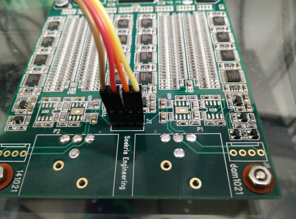

I was using the raw outputs since I got the DAC and am extremely happy with the sound. The other day I wanted to see what the buffered outputs sounded like, I lasted no more than 5 minutes. It was just harsh, too sharp and sounded no better IMO than my cheap Chinese brand DAC.
I decided to remove the op-amps from the board since I knew at that point I will never be using them ever again. Before I did that I used my Seek Thermal camera and noticed they got pretty warm even after I cut the signal traces for them, meaning they do draw a good amount of power for doing absolutely nothing. Its best to just remove them if you have zero intentions on using them. The 5V regulators near the RS232 serial chip don't even get warm anymore either after doing so.

ok thanks
there coming off then so

Interesting, assuming to remove op-amps from cheap Chinese brand DAC to use the raw outputs would bring it to the same quality level.
It's a shame that this DAC failed on analog section as usually happens to digital guys.
