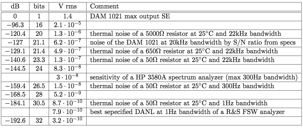

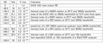

I compiled some data on the voltage levels related to the resolution bits.
From that it looks like there are "only" 21-22 bits above the noise level of the DAM at 20 kHz bandwidth (which nearly is identical to the thermal (Johnson Nyqvist) noise that we have from the 650 Ohms of the DAC ladder at that bandwidth ... which is not avoidable).
So what are the benefits of 28 bits of resolution? That's not a rhetorical question, I do not rule out that the 28 bits are good for something, I currently only don't see for what.

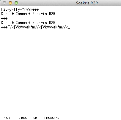

Thanks leehan,
I did:
- install serials driver (I bought usbserial PL2303 as your)
- setup profile as Paul instructed
- connect adapter, power the DAC off and on as you instructed
- make dial
I guess everything is fine when I see the Mac already received some thing from DAC because when initiate I2S, or I play song: there are some "words" display on terminal. Same when I power on the DAC.
Problem is when I type "+++", there is no respond from DAC, even I wait for 5 min. I already tried with another Mac (Maverick) the result exactly the same.
Please have some advice, thanks a lot! 🙂

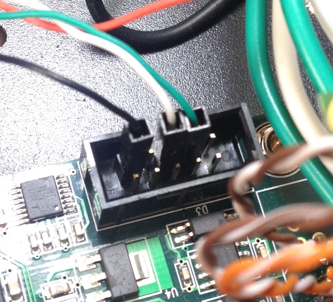

PS: I took a photo of how I connect usbserial adapter: I only use 3 wire:
- Black: GND
- White: RXD
- Green: TXD
- Red - not use: Vcc
And I already make cross wire as Paul and you instructed!
