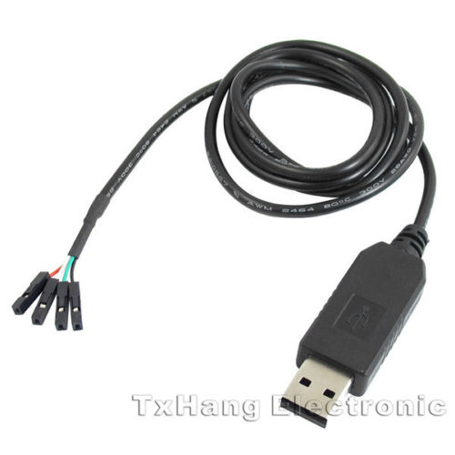

Can you kindly post a picture of your USB-RS232 converter? A common PL2303HX supports both TTL and RS232 voltages, depending on how the board is wired. Most of these cheap USB to serial adaptors that come with a bare set of pin headers including a 4th power wire are intended to be used with Arduino's, Rasberry Pi's, etc and only support TTL levels.

The junk text usualy means that your USB to serial adapter is not a real RS-232 adapter. It is probably outputting 0-5V instead of the "real" RS-232 levels. You should try some other adapter or an old PC with a real serial port.

Sure! And yes it have 4th wire for Vcc but I not use it. I bought this one from USB to RS232 TTL UART PL2303HX Auto Converter USB to com Cable Adapter Module | eBay
I also able to check the exact name of chipset is PL-2303XA/HXA
update: spike, you are very right, this adapter support TTL (information from product page). Do you have any suggest on another brand name? Thanks!
Any of the adaptors that have a standard 10 pin male RS232 port should work, such as: USB TO RS232 Serial Port 9 PIN DB9 Cable Serial COM Port Adapter Convertor Blue | eBay
Could also get away with using a TTL to RS232 converter as well. http://www.ebay.ca/itm/10Pcs-Serial...278?pt=LH_DefaultDomain_0&hash=item1c3fc3e5ee
Could also get away with using a TTL to RS232 converter as well. 10pcs Serial Port Mini RS232 TO TTL Converter Adaptor Module Board MAX3232 | eBay
