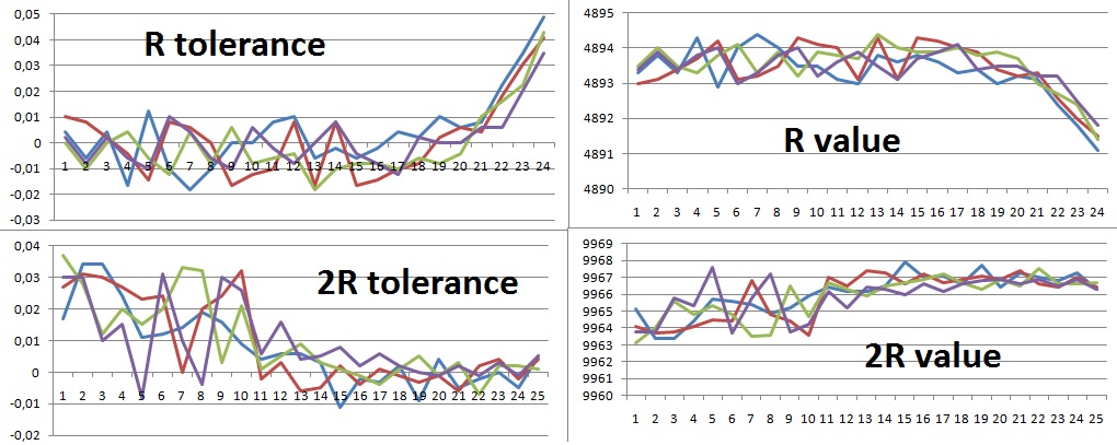

I measured R 2R ladder of the DAM1021 plate.
R, 2R and tolerance graphs measured values.
2R:9967 Oh. (4990+4990-13)
R: 4893.5 Oh. (4890 = (4990 // 245K) + 3.52 2 ladder: 245K = 47 R + 2R + 2R joined by mass is 4890). +3.5 Oh mass resistance).
The 10 first 2R resistors clearly appear of 0.05% in the four ladder.
In the four ladder, R next output decreases resistance , the circuit must be something I do not understand.

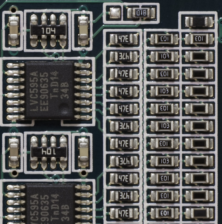

How did you measure? "in circuit" and DAC not powered I suppose.
If you have a close look on the PCB, some of your assumptions on the topology seem not to be correct.
You see that "2R" is a 10k (103) with something big (47E) in parallel giving in total something slightly smaller 10k. The backbone of the ladder are the black ones with a resistance of around 5k.
