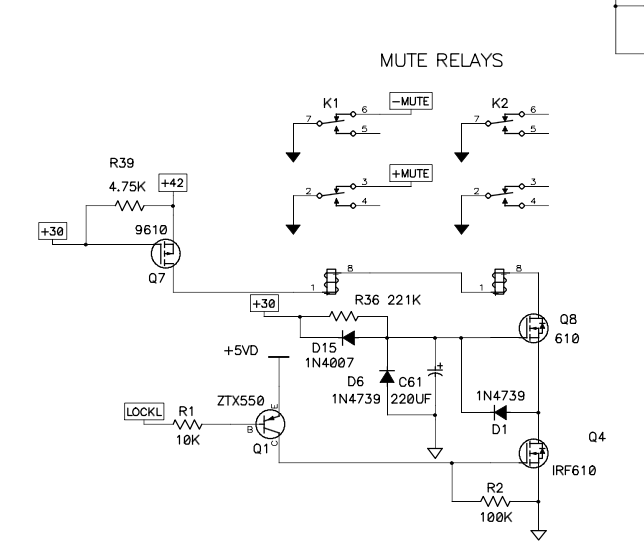

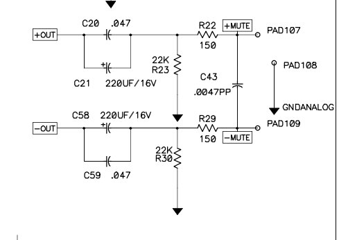

Power down protection is based on supply voltage. Once voltage drops below a certain point, you remove power from a NC relay. Muting is done by shunting the output to GND when the relay is closed - this was the method used by the Pass Labs D1 and others so has hi-end "cred". There is no need for code or relay contacts in the signal path. If it was extended to muting during unlock, you would use the same code that is in place for the lock/unlock LED to close the relay.
Hi Paul,
Just so that I understand your post correctly, what you are suggesting is to have the relay drain the voltage from the rails through the relay to ground. Is that correct? By the time that the relay switched, the input power is disconnected from the transformer, so it would just be stored energy being drained. Would you also use some small resistor in line with the relay so that the voltage would come down smoothly?
Hmmn. I think I'll see if I can find the Pass D1 circuit diagram on line.
Jac
You can power a relay from one of the 7V transformer windings. Just a small diode bridge into a capacitor of say 470 uf, then a resistor to the positive relay terminal. Put 1000uf across the relay. Put another diode 1n4007 or similar across the resistor pointing cathode back to the bridge.
If you use a 5v relay, and choose a resistor that works with that and your rectified supply, you will get a delayed turn on and very quick turn off.
Use the relay contacts in series with the signal or shunt.
Hi Paul,
What gazzagazza said. 😉
I wouldn't advocate using the Pass circuit in this context, but it illustrates how the shunt to GND is switched by the relay. I've attached the relevant sections from the D1 schematic. The 42V supply is picked up the main supply caps, and the 30V supply taken from just after the first regulator in the analog supply.
