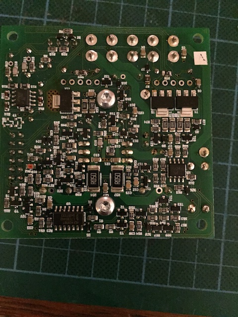

This being DIY audio, I find it funny for something made almost entirely of through-hole components and a few SMD devices that you couldn't replace those blown components, rather instead buy new complete boards.
This is what the bottom of one of my UcD400HGs looks like:
I imagine that the 180HG is pretty similar.

Very, very similar, but the UCD180 boards are smaller and more densely packed...
attachment.php

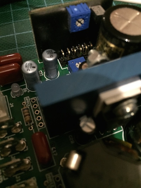

There is also a potted daughter board that carries the core parts for the board.
attachment.php
but yes very, very OT.
