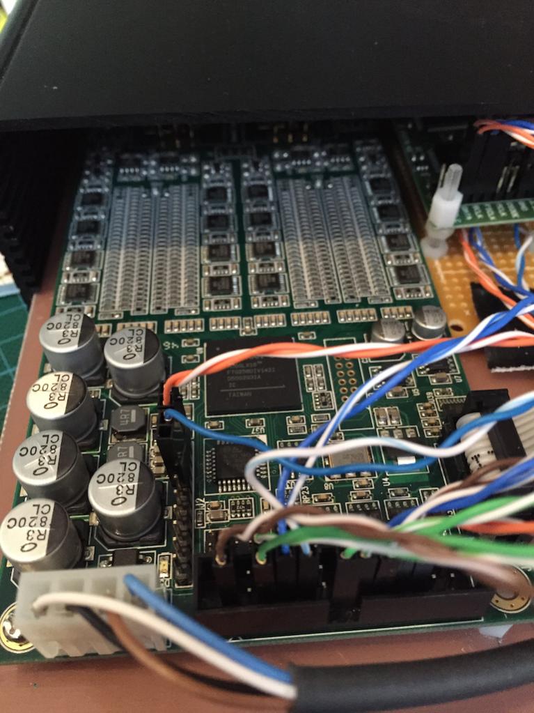

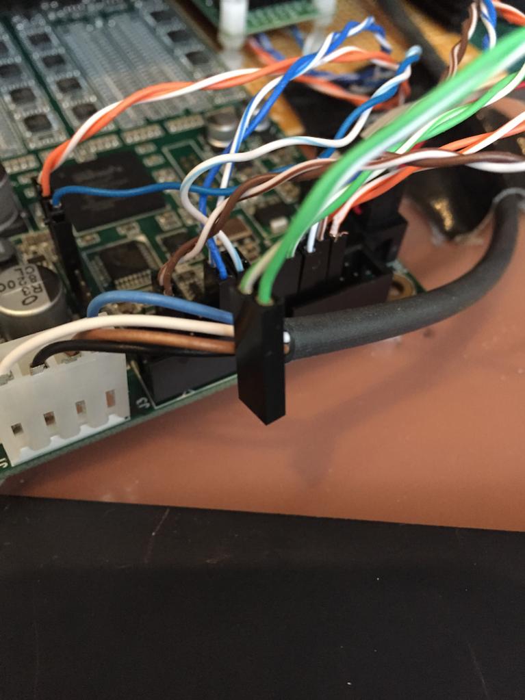

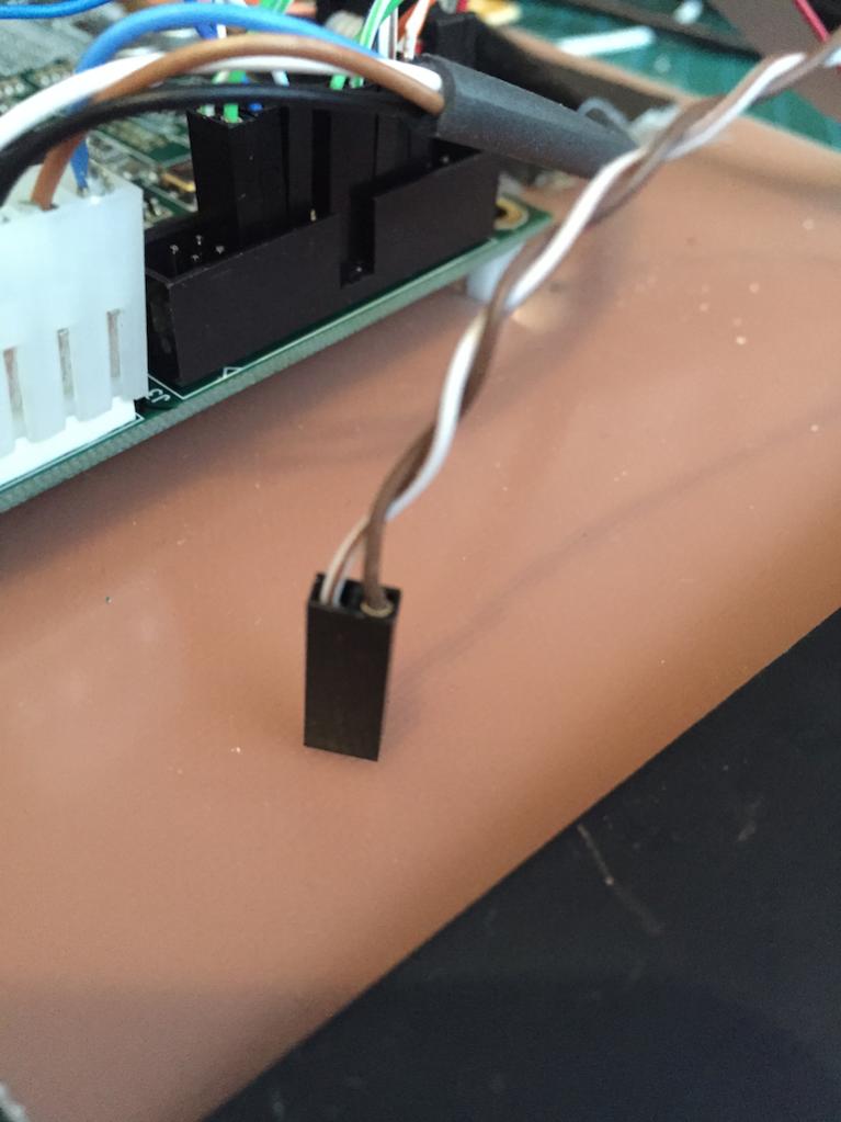

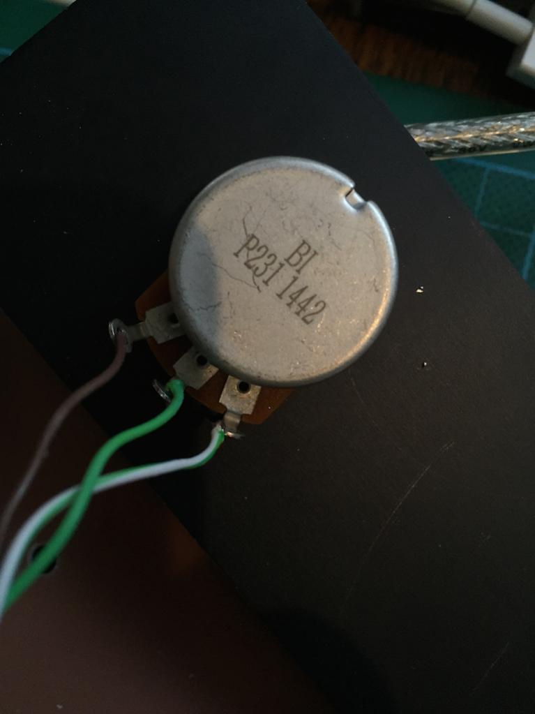

Hi Søren,
Yes, it happened as I was turning down the volume. It had been hooked up to the TV via toslink and running this way for 3-4 hours. I was preparing to turn off the amp as I now leave the DAM on 24/7 to avoid power down DC issues.
No changes to wiring had been made since I fitted the Amanero board a couple of weeks ago. Wiring was rechecked and everything was ok. The board was running fine in this configuration - it was configured as per instructions when I received the board and wiring has only been touched to install the Amanero a couple of weeks ago.
A linear pot was fitted originally and had linear response for the entire time it was in use until the pop occured. I replaced the original pot on Friday to eliminate the possibility this was faulty.
The replacement pot I fitted was also linear, and also displays the same non-linear response:
P231-QC20BR10K - BI TECHNOLOGIES / TT ELECTRONICS - PANEL POT, 10K LIN 24MM | element14 Australia
Pot connections are:
Solid brown -> 3.3V
Solid Green -> VOL
Green/White -> GND
cheers
Paul

Beside a remote chance of a dead part, I can't really see anything but a bad connection, the uC do have a pulldown on the Volume Pot (uC PA0) connection, but otherwise the uC just read the voltage, do a little processing and convert to log, and then send it to the FPGA.
Only software option is to disable the potmeter, using the uManager "set volume = xx", where xx set the default volume in db (-90 - +15) and disable the potmeter, "set volume = -99" enable the potmeter again. You can use the "set" command without parameters to see current settings.
You also need to check the pot voltage at the dam1021 connector, to ensure it follow the potmeter turning.
Søren,
I'd reseated all the connectors when it first happened but when I pushed pins into the backs of the connector housing so I could probe the pot voltage at the header the volume started responding as it had originally done.
Looking at some of the joints on the header it seems I'd been a bit stingy with the solder so it was probably a dry joint. I've redone all the pins, and they look better than they had previously.
Anyway that looks to have fixed the problem.
thanks
Paul
