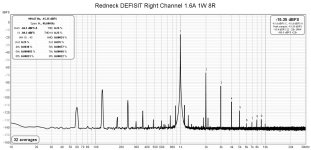

My lowest THD w H2neg 🤓: 7.5R 0.1% >> 5R 0.15% >> 2.5R 0.35%
For Vout: 2.75Vrms >>2.73Vrms>>2.67Vrms : so maybe that output impedance's around ~0.08 df=100 ? 🤔
Excel file with calculator for the output impedance is very handy:
https://www.diyaudio.com/community/threads/measuring-power-amp-output-impedance.354536/post-6205809
Calculated output impedance is 0.11Ω
So, a very good DF of 73 at 8Ω.

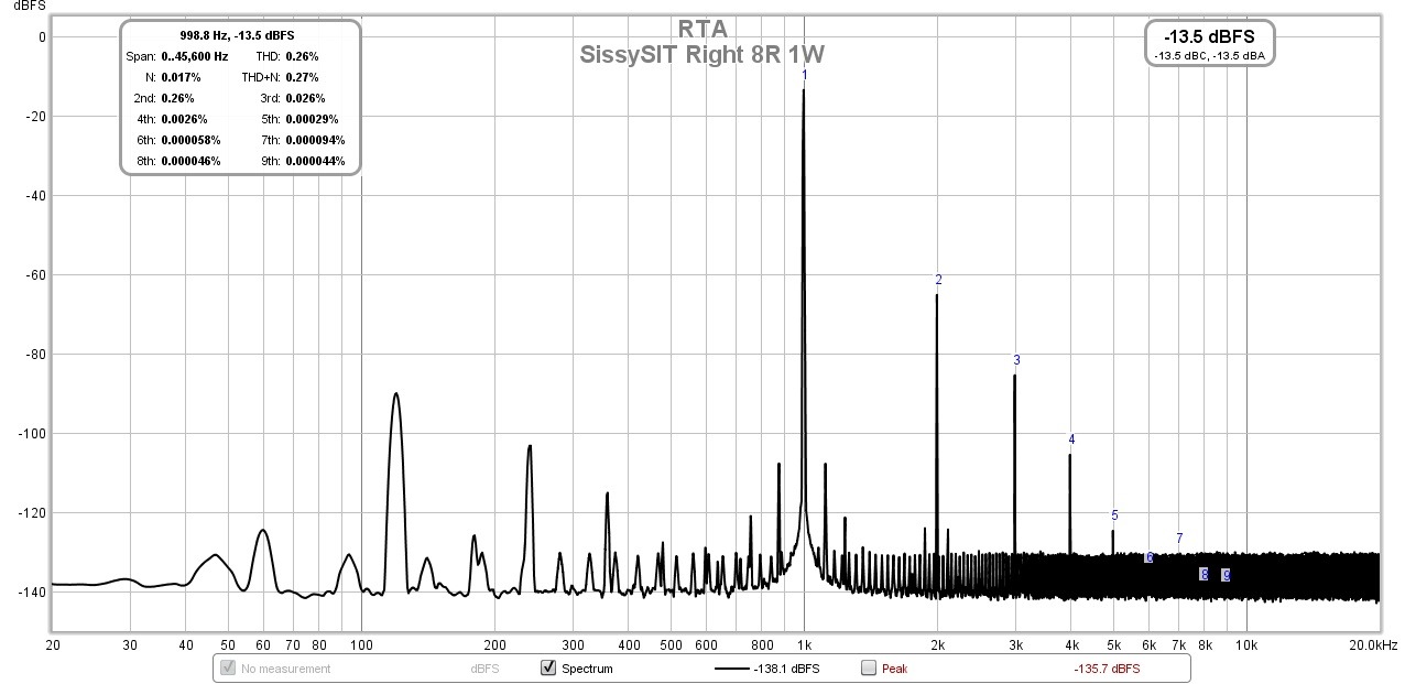

Here is 1W at 8R. I have also included the 1W at 8R when it was a SissySIT channel.Hi Ben Mah,

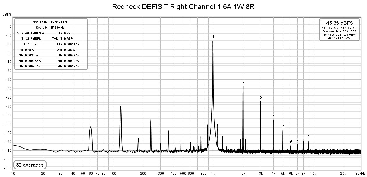

I am not happy with the AC power harmonics at 120Hz and 240Hz. The 60Hz is most likely pickup due to the arrangement of the equipment. I built this amp as a SissySIT over two years ago and I used power supply boards from ebay. I now know more about amplifier noise so I have a plan to take power from the boards at a different location to hopefully lower the noise.

I made the wiring changes to the PS board and it did not make much difference. However I reduced the 60Hz spike by unplugging my computer, so that spike was not from the amplifier. I have 44mF - 0.1R - 44mF CRC in each rail so that is much less than your 320mF.
I am now listening to this right channel with my choke loaded 2SJ28 follower in the right channel, and it sounds good.
My speakers are 103dB sensitive and I can only hear a very faint hum if I have my ear right up against the woofer.

I think in my case with a bi-polar power supply, I need to reduce the power supply ripple to reduce the AC power harmonics from the amplifier output. Although the DEFISIT is push-pull, the dissimilar output devices allow for dominant second harmonic distortion, but because of that power supply ripple also sneaks through.
Apart from the AC power harmonics, the noise floor is quite low. And since I can only hear a faint hum if I have my ear right up against the woofer, that is good enough for me and I will leave it as is.

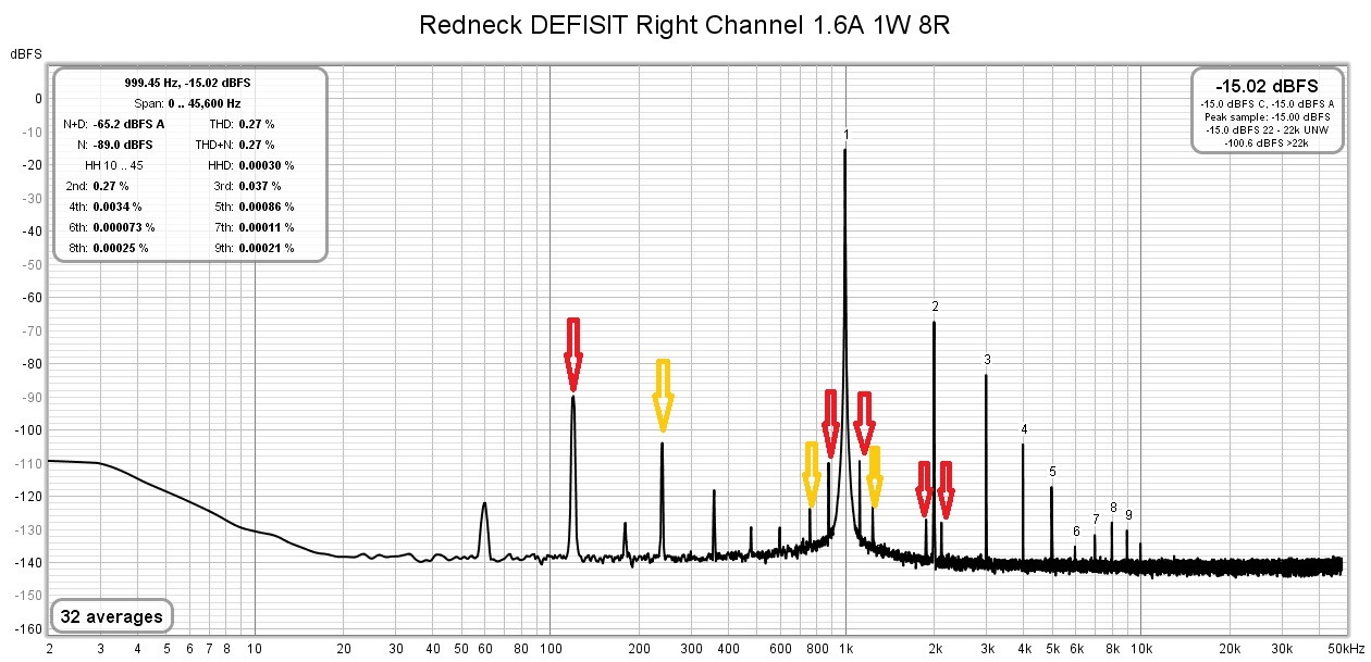

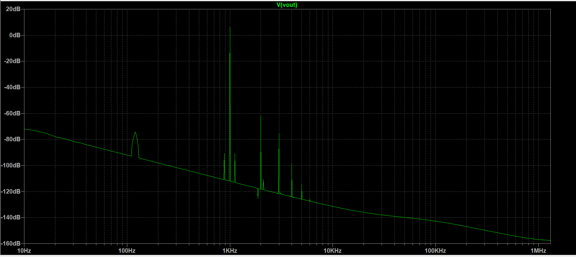

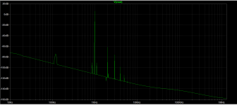

I was curious about my power supply ripple so I did a PSUD2 simulation and the ripple was 25mVp at 1.6A. So in my LTSpice Redneck simulation I added a sinusoidal 120Hz 25mVp to the V+ and V- supplies. The ripple is not quite sinusoidal but I figured for the simulation it would be close enough. The resulting FFT showed a 120Hz peak that was 80dB below the 1kHz signal. Actual FFT of the right channel (post #103) showed the 120Hz peak at 75dB below the 1kHz signal.
So simulation and real life seem close to agreement. If the simulation is to be believed, the effects of the power supply ripple and harmonics that are present in the amplifier output are expected, and to reduce them would require reducing the power supply ripple.
As I mentioned previously, this hum is barely noticeable when I have my ear against the woofer of my 103dB sensitive speakers so I will not do anything about it. Also the rest of the measured FFT spectrum (post #103) is quite clean so I am happy. By the way a large portion of the 60Hz spike was from my computer on AC. I did a measurement later with the computer on battery and the spike was much lower. My 1kHz oscillator though is AC powered.

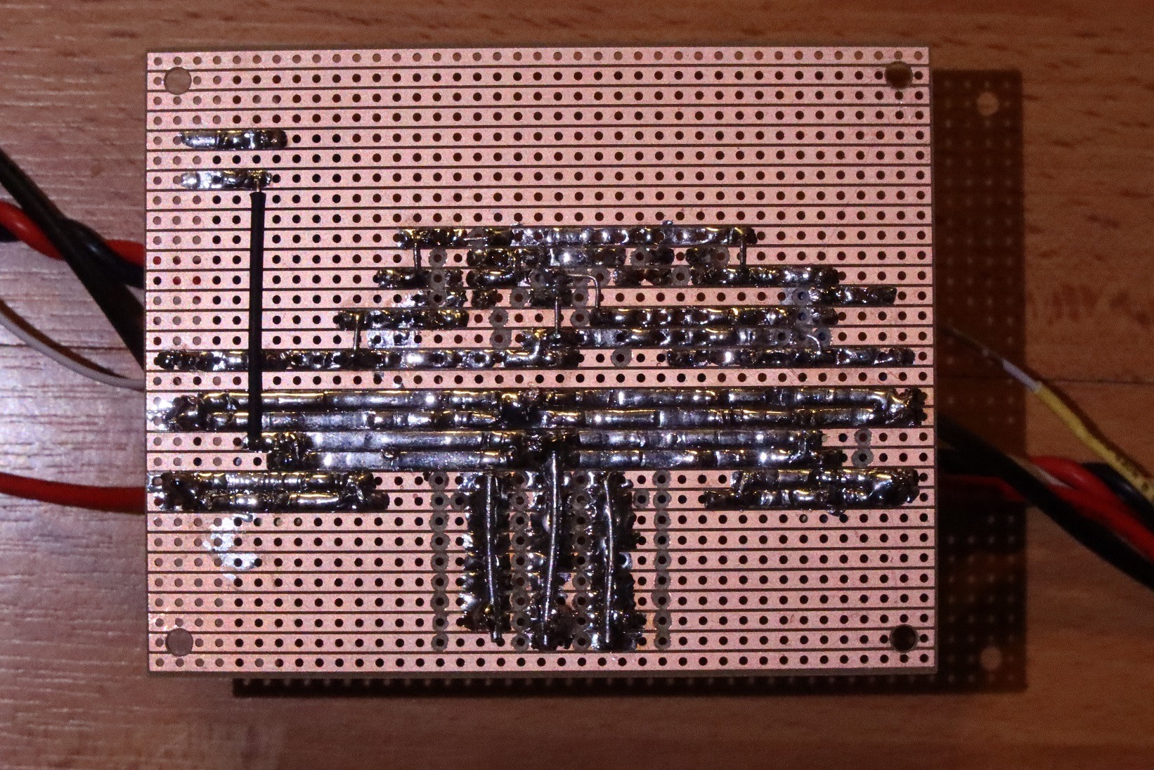

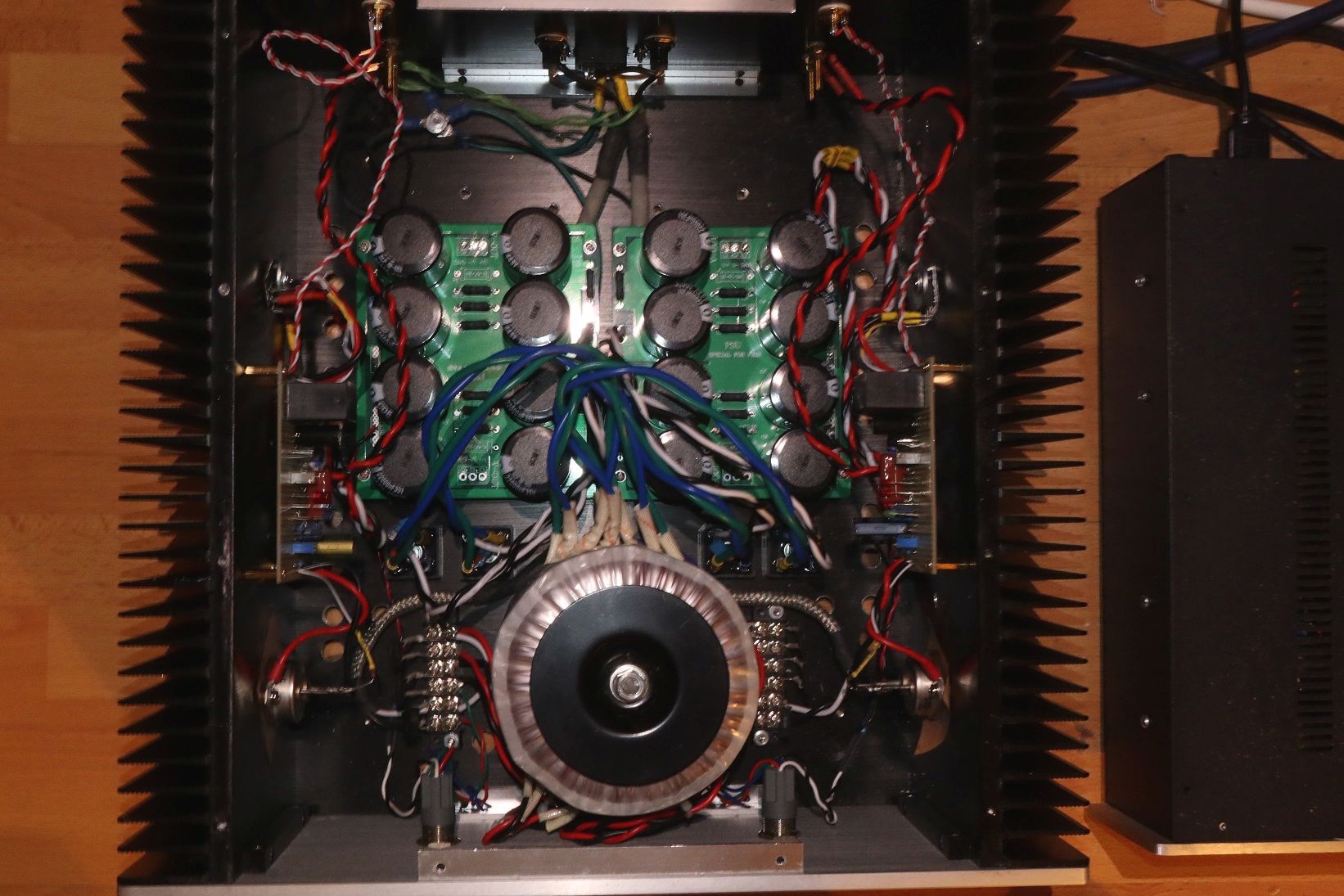

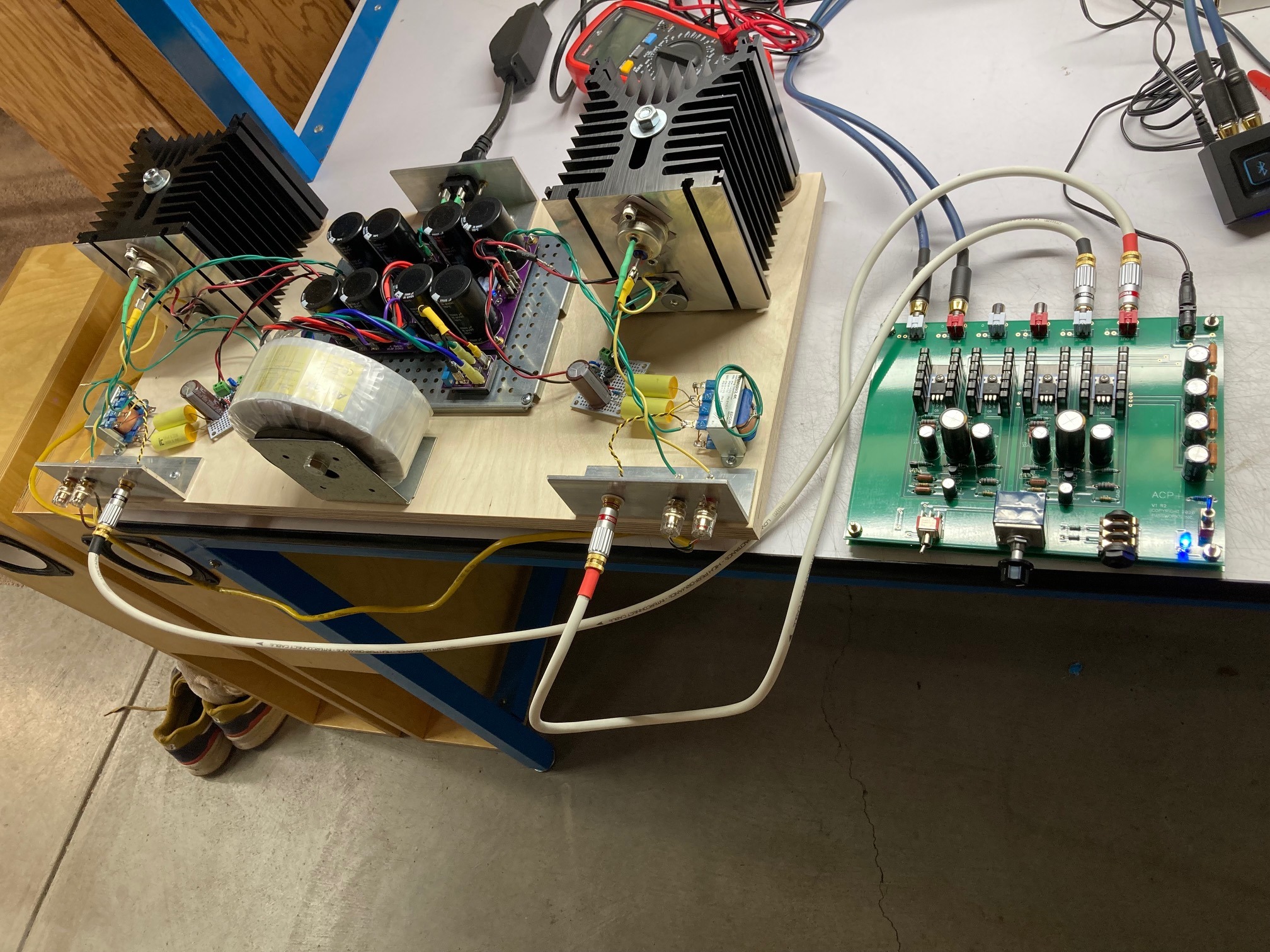

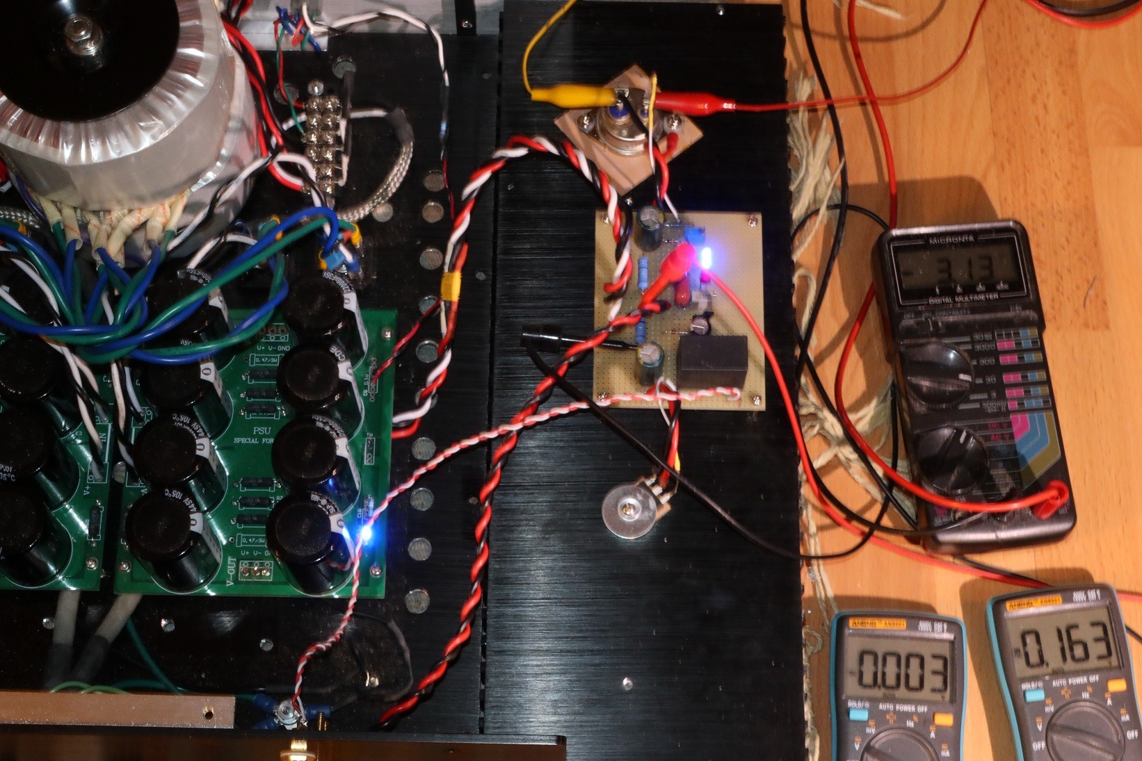

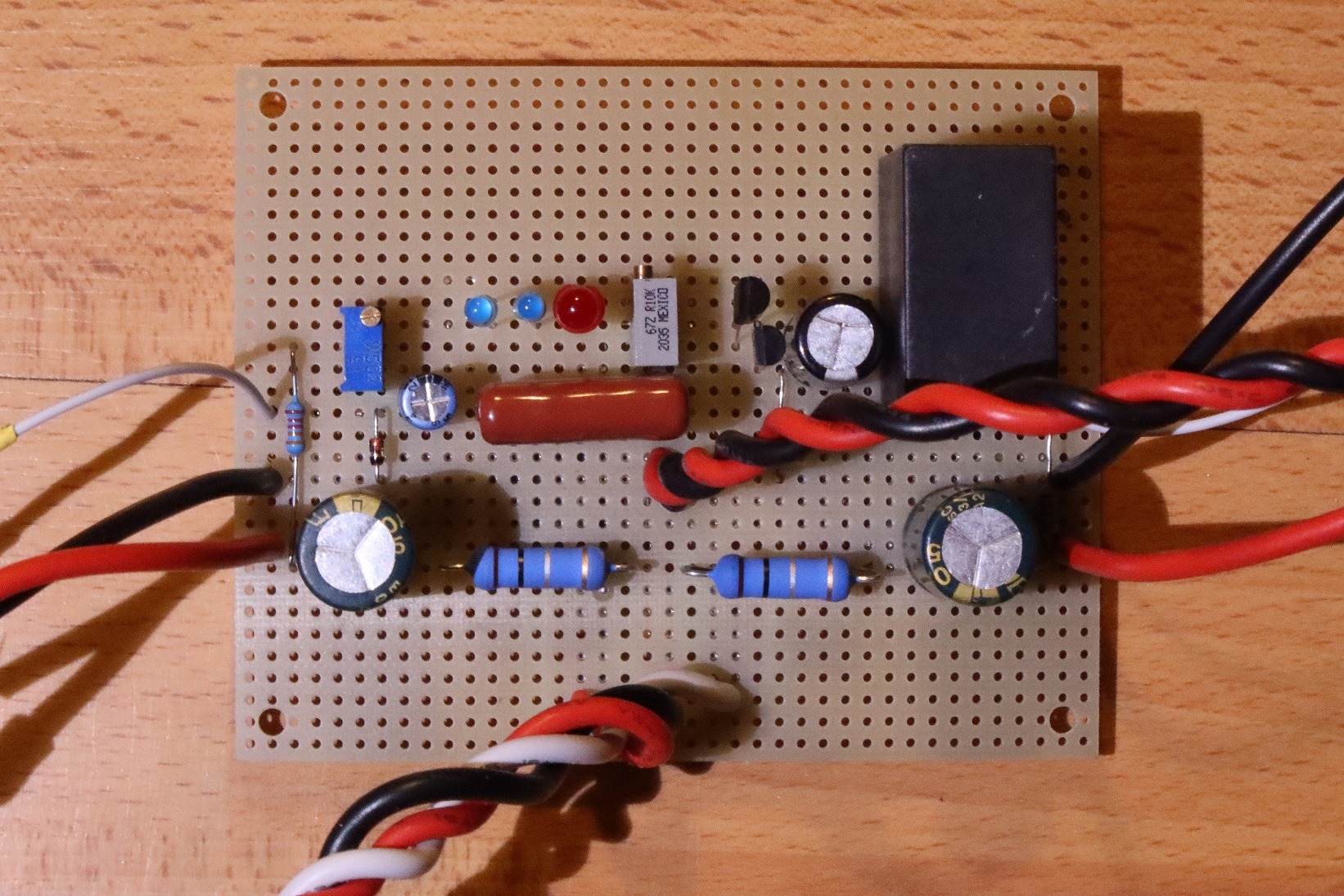

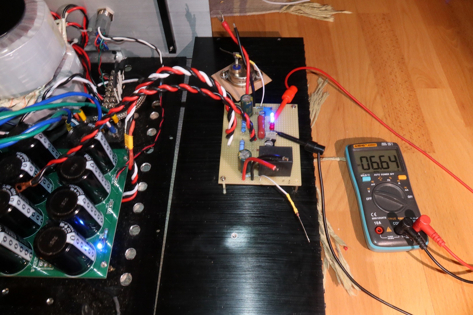

The Redneck tranformation is done. The left channel is finished, and like the right channel, it is also stable. I have both channels running at 1.7A now, and the heat sinks are hot, but not too hot as I can keep my hand on them indefinitely.
Since this build was to be done with as much parts as possible from my spare parts box, the left channel LED voltage reference ended up with two small blue LEDs and one large red LED. Their voltages were 2.55V for the blue and 1.60V for the red when tested prior to installation. When the board was powered up, the voltage of the string was 6.64V, close enough to 6.5V.
Some pictures:
Some pictures:

BM Redneck DEFISIT Left Channel Setting Bias and Offset.jpg469 KB · Views: 102

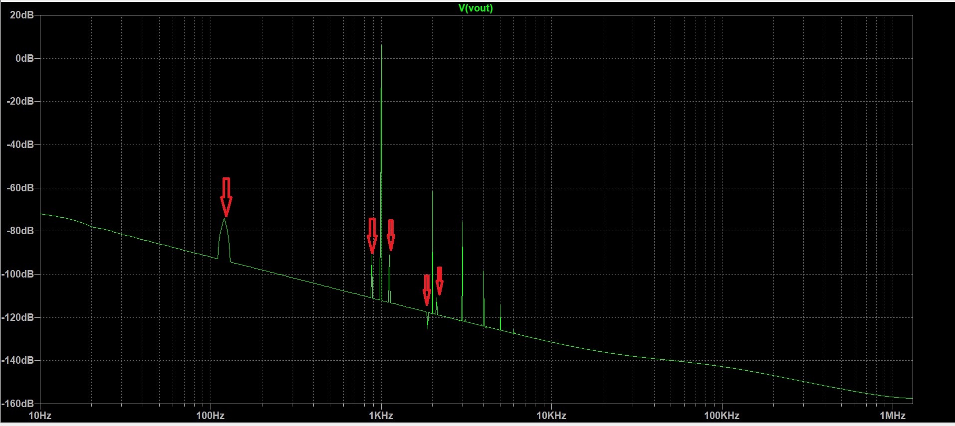

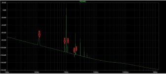

When I saw the LTSpice simulation FFT for the 120Hz power supply ripple in my post #113, the effect of the 120Hz on the fundamental frequency of 1kHz and its harmonics were evident. Not only was the 120Hz present in the amplifier output, there were visible additional spikes at 880Hz, 1120Hz, 1880Hz, and 2120Hz.
This illustrated the presence of intermodulation distortion (IMD), where a lower frequency affected higher frequencies. Where harmonic distortion is in multiples of the primary frequency, intermodulation distortion is the sum and difference of the two frequencies, and it affects the fundamental frequency and its harmonics.
Harmonic distortion being multiples of the fundamental, are generally viewed as being less objectionable to the ear, especially the lower harmonics, as music may already have some of these harmonics. Intermodulation distortion however are not harmonics of the fundamental but frequencies centred about the fundamental frquency and its harmonics, and are not musical.
Unfortunately if harmonic distortion is present, intermodulation distortion is also present. So if harmonic distortion is deliberately introduced into an amplifier, intermodulation distortion comes with it. Fortunately intermodulation distortion appears to be lower than harmonic distortion.
For me the solution to amplifiers with higher levels of distortion is to combine them with speakers that are high in sensitivity. The amplifier then stay mostly below 1 Watt of output and the distortions are low, but their good effects are heard. 🙂
