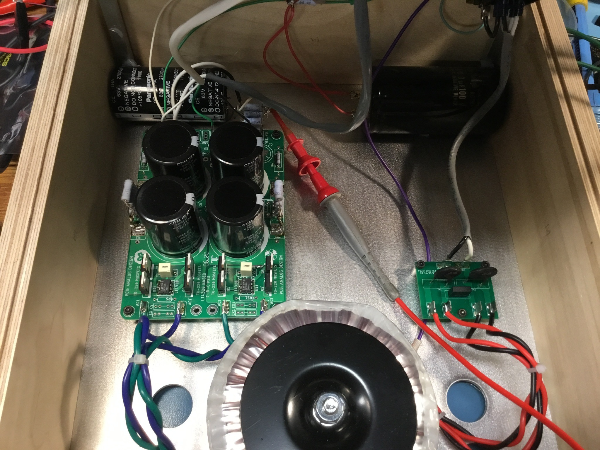

So I changed the CRC power supply filter to CLC, from 44mF-0.1R-44mF to 44mF-Hammond 156B-44mF. The 156B is 1.5mF@5A, 0.07R, 400V max.
Now there is no audible hum with my ear against the speaker.
The 120 Hz noise dropped about 20dB, and the harmonics of 120 Hz and also the intermodulation distortion also dropped considerably.

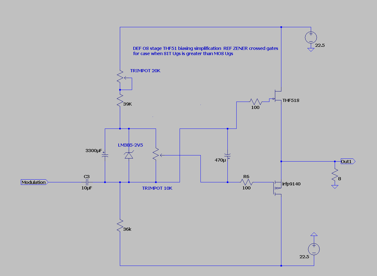

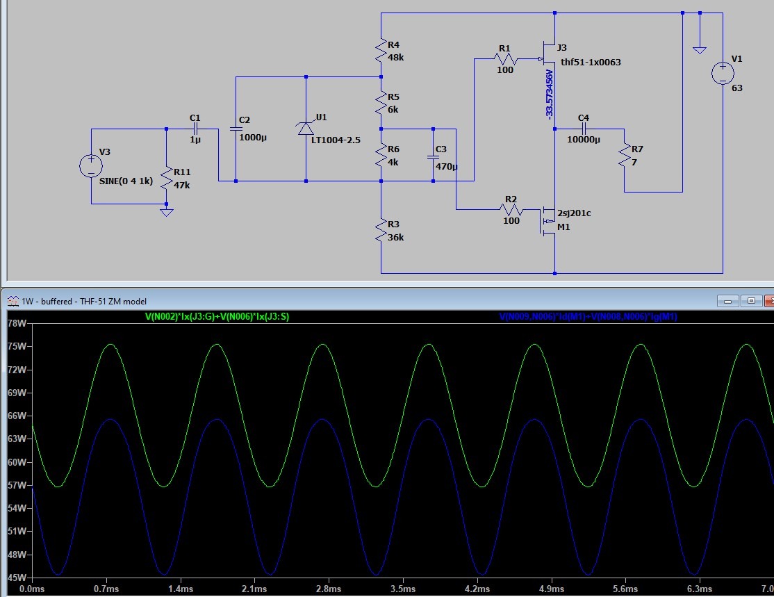

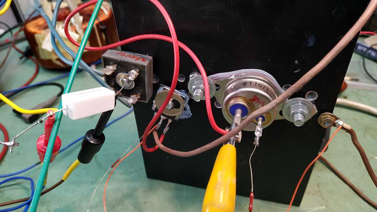

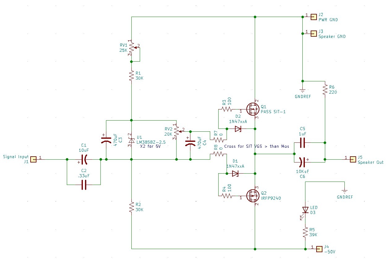

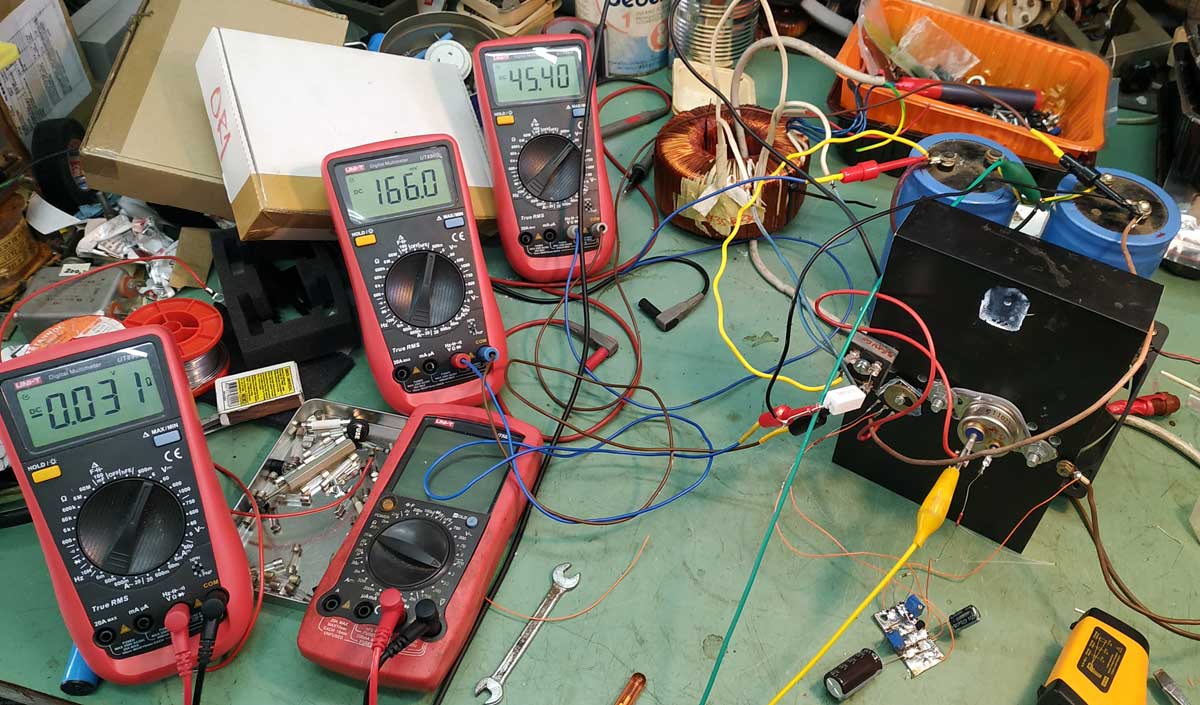

Ok, here's my revised Ugs testing for the devices. Now I have the numbers for these spice models to fiddle with the sims.
20V at 2A makes the math easy, 40W dissipation and device looks like a 10 ohm resistor.
P = I*E = (2A)*(20V) = 40W
R = E/I = (20V)/(2A) = 10ohms
I'll probably test for a few different PS voltages and currents on the real devices. Say 18V, 20V, 22V at 1.8A and 2A.
