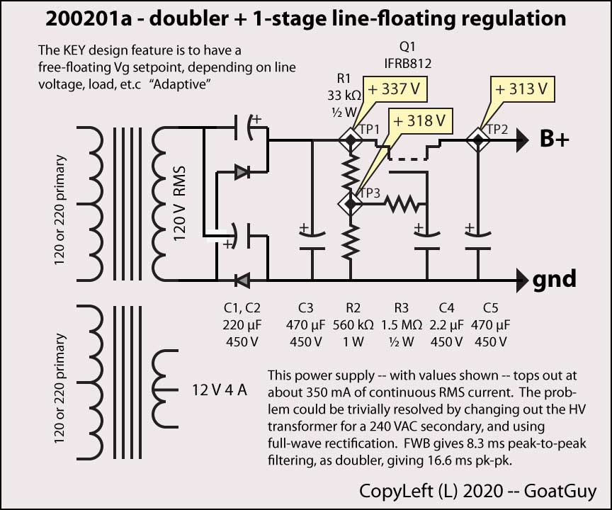

It is truly amazing what one can accomplish with a few Zeners and MOSFET 'source follower' style series regulators in the PSU. 2 (optimal) or 3 (max…) stages squashes all audible PS hum, yet still keeps downright impressive current-sourcing capacity in a PSU for the amplifier's finals to eagerly slurp up.

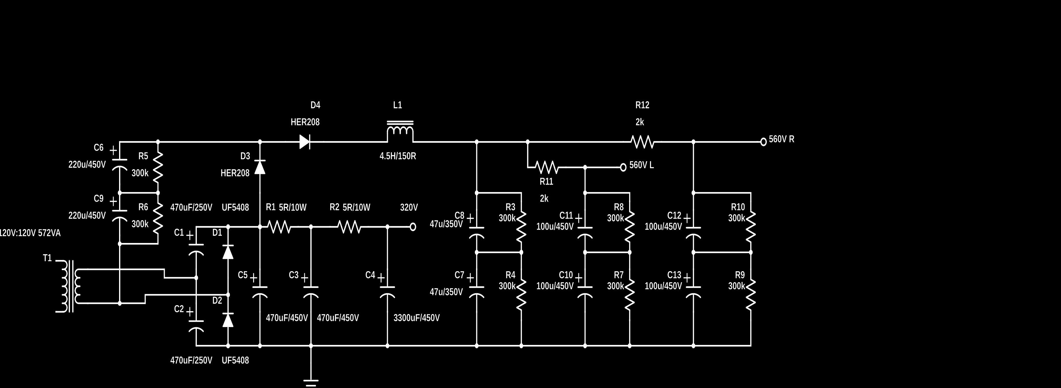

This simple supply powers my amps (PP output stage only, other amp stages and bias supply are DC boost converters powered from the heater supply). I have a feeling if I replaced the UF5408 with 6D22S, they would explode haha!
320V with a 400mA load dropping to 305V with 1A or so. There isn't enough voltage overhead for a 300V regulator I've been told.
BTW the monoblocs 112W output was tested using sine wave drive, just before clipping, 30Hz, 6R load for an effective 1k Ra-a, 4 6P45S tubes trioded for PPP operation. It will do this all day happily.

Nice, but the amp idles at 400mA and peaks over 1A! Still, pretty simple 🙂
As noted, just using a 240 VAC secondary über-cheap transformer and a full-wave bridge cures that, straight up, without the half-wave doubler, and its inbetween peaks. No values changes needed.
One might also consider adding one of your HF filtering sections before the MOSFET … what was it, a 10 Ω / 10 W resistor and another 470 µF reservoir cap.
OR, if you have the space, a 0.25 to 0.5 H inductor of sufficiently low RDC. That would be better, as it really soaks up the HF crud.
This configuration (FWB, REG) is what I've generally been designing in to anything HiFi'ish.

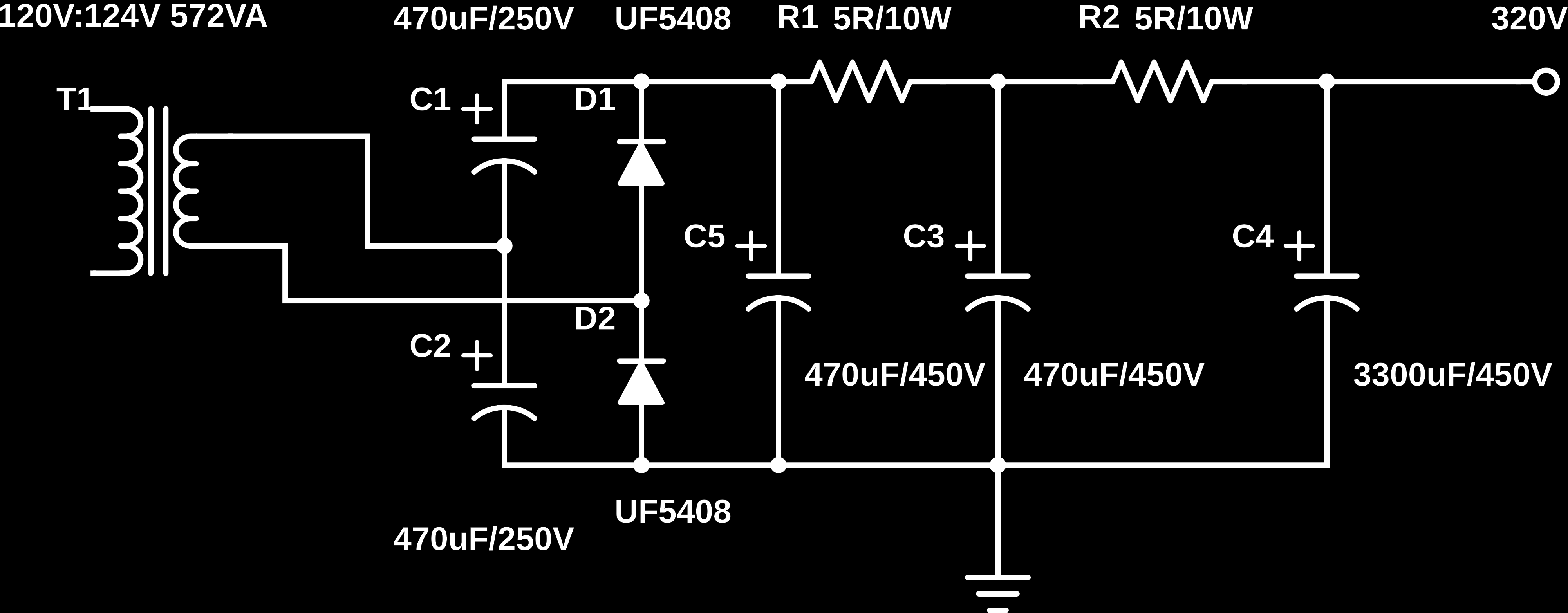

Good to know. The transformers I'm using right now are 62-0-62@2.5A DC (572VA) so I'm just leaving the CT disconnected and using the Delon. If I was to buy a transformer though, it'd probably have dual 115V secondaries for series 230V operation.
Good to know. The transformers I'm using right now are 62–0–62@2.5A DC (572VA) so I'm just leaving the CT disconnected and using the Delon (Bridge). If I was to buy a transformer though, it'd probably have dual 115V secondaries for series 230V operation.
I see. Odd transformer. Also, I take “it back” … apparently the Delon Bridge is a pseudo-full-wave configuration. Who knew? The positive going cycles definitely have a 16.7 ms gap, and the negs, too. But they're offset from each other by 8.3 ms, so the effective ripple is reduced therein.
I'm going to have to toss together one of these and look at it on the oscilloscope. Just a 12 volt one, of course. So I can touch bare wires with my hot fingers, while standing in a puddle with stocking'd feet . .. … LOL.
Ya, they were surplus and only cost me 20$CAD a piece 🙂 I have only three though.
Let me know what you think of it. Large caps in the "bridge" help with ripple, too. You knew that though.
