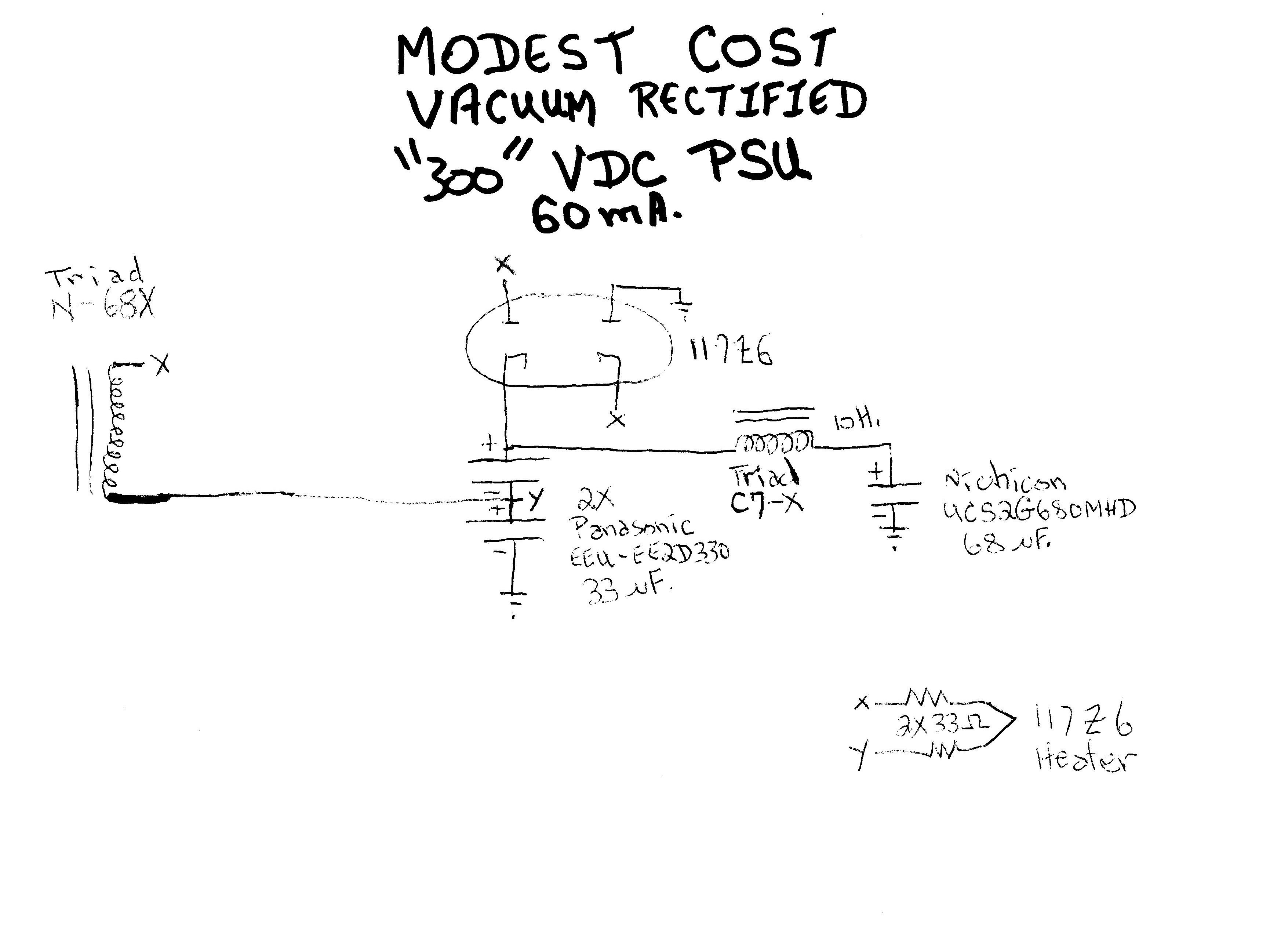

FWIW, "El Cheapo" uses an 'AL5 in the low current B- supply. It was a cost conscious, highly convenient, simple, choice for obtaining a slower starting rail. I definitely did not want 12AT7/ECC81 grids going positive, with respect to the corresponding cathodes.
I will not incorporate a "high" current rail that employs vacuum rectification in 1 of my designs. The 60 mA. 117Z6 setup for use in preamps is my limit and it's not exactly "mainstream". High PIV Schottky diodes are every bit as quiet as their vacuum counterparts and don't incur a substantial forward drop penalty. I have a 14Y4 that will (eventually) be part of a low current negative rail, as that's an "easy/peasy", inexpensive, way to slow rise down. My prejudices run towards avoiding SS things that might introduce digital noise into a setup.
If different specimens of the same tube rectifier type truly sound different, you can be certain that they exhibit different forward drops. There simply is no other explanation consistent with the Laws of Physics. Said natural laws don't change because somebody is "peddling snake oil".
