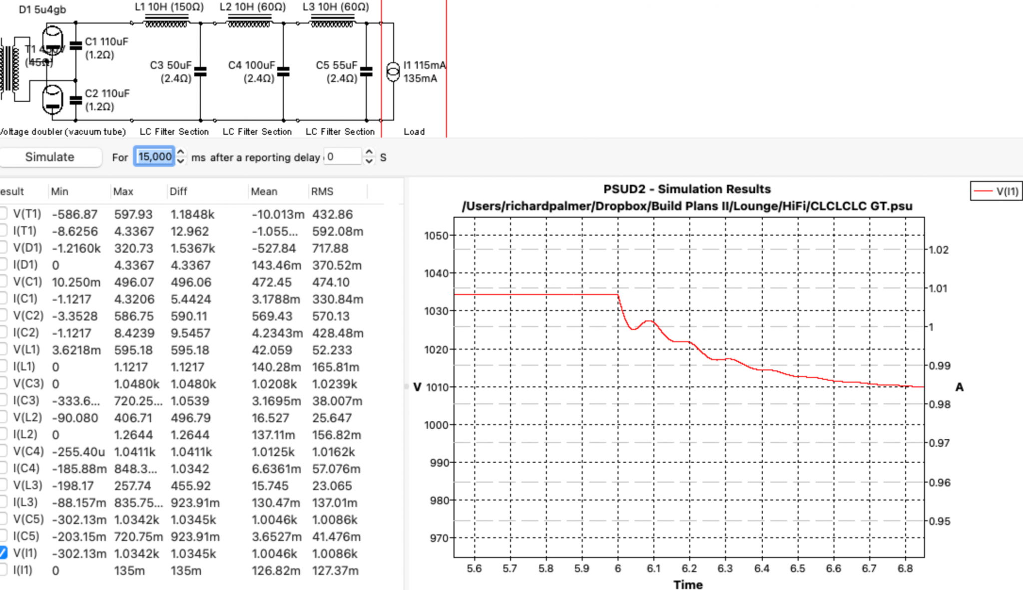

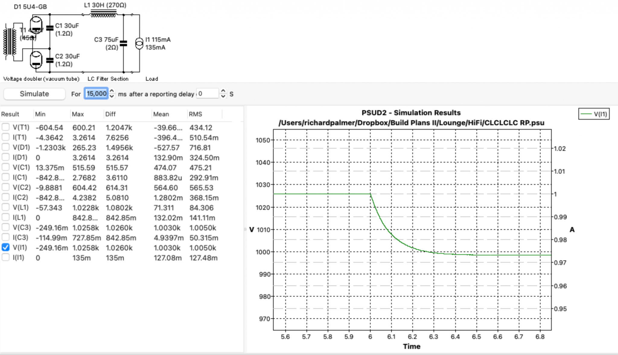

So here are 2 plots and you can see the difference in the transient response for a step change in current draw after 6 seconds this compares the CLCLCLC to CLC what I have not put in accurately is the resistance of the caps due to lack of info but I feel like this tells an interesting transient story....this does look like a ringing/oscillating response from the CLCLCLC compared to the CLC, it also takes longer to return to a stable supply.

The oscillations here are based upon the step change in the constant current simulation at 6s
Thanks for this, and to better understand your logic of not enough attenuation so looking at the simulation the resultant ripple is 58mV. Which is as you say ~60 dB below the simulated output after the rectifiers at ~60V.

The simulation does not match what actually happens. After 6s the voltage in the real amplifer is still zero base the rectifiers haven't warmed up, and they give a much slower and steadier rise than the simulation shows. The assertion that this has anything to do with steady state behaviour remains unsubstantiated.

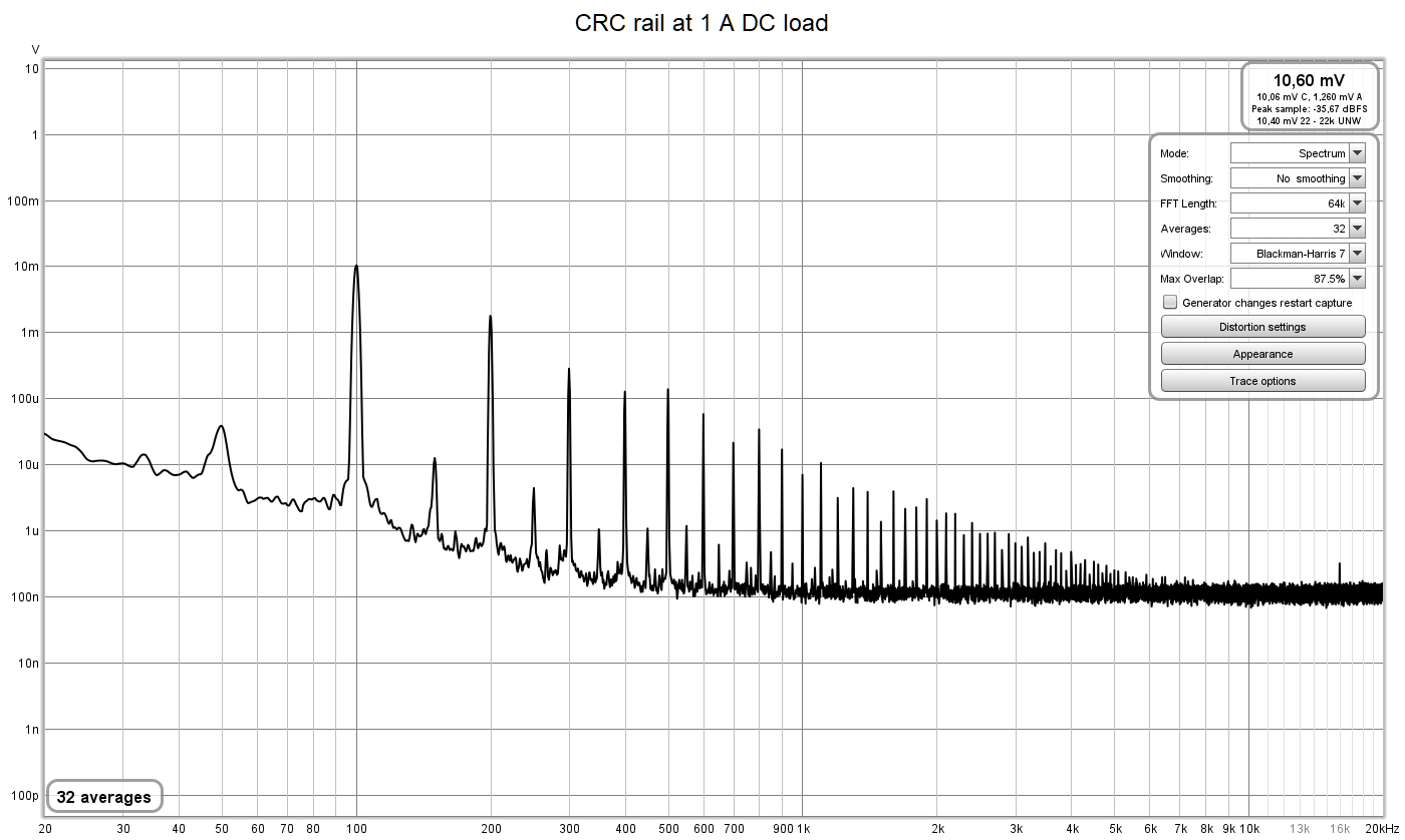

Example of rail harmonics of CRC power supply with 1 A DC load. Example is from low voltage supply for a solid state amplifier, but same rules apply to HV supplies.

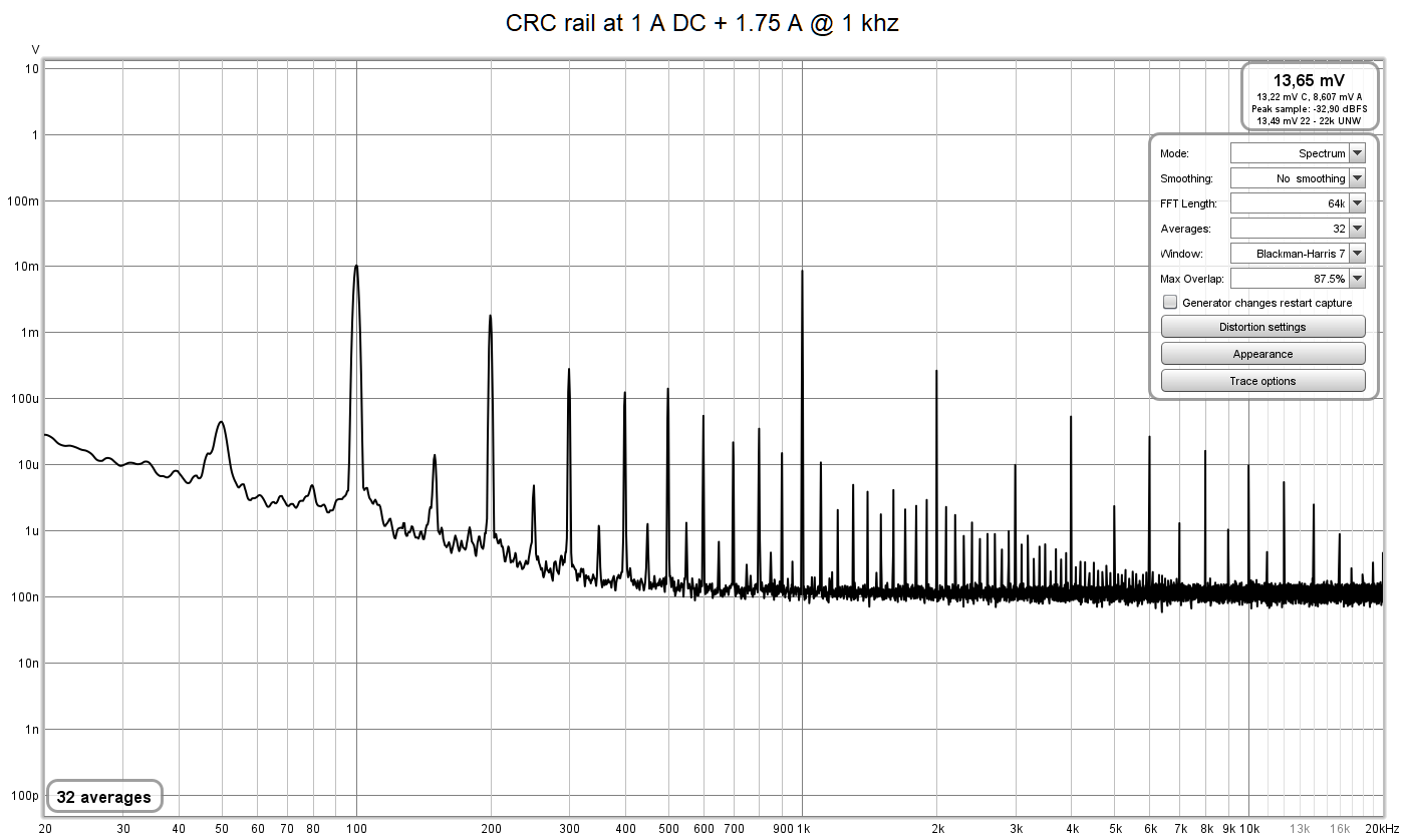

CRC under 1 A DC + 1 kHz 1.75 A rms load. PS under AC load produces harmonics. H2 harmonic is 30 dB below rail modulation caused by load from the amplifier and H3 is another 10 dB lower.

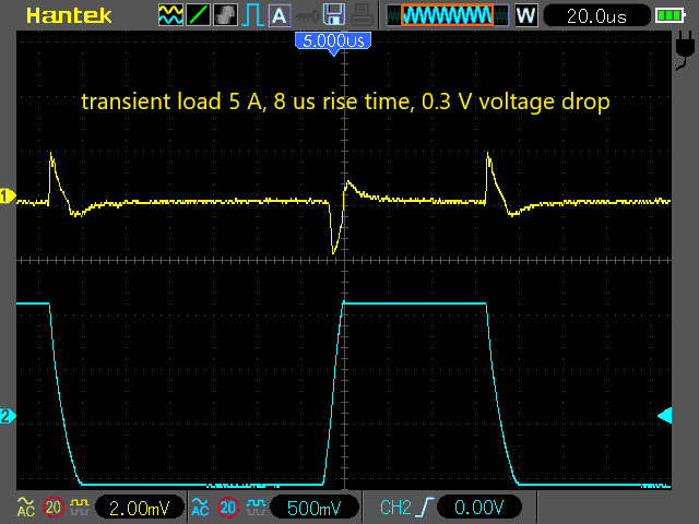

Example of clean transient response of regulated PS under hard conditions. There should be small voltage variation and no ringing:
