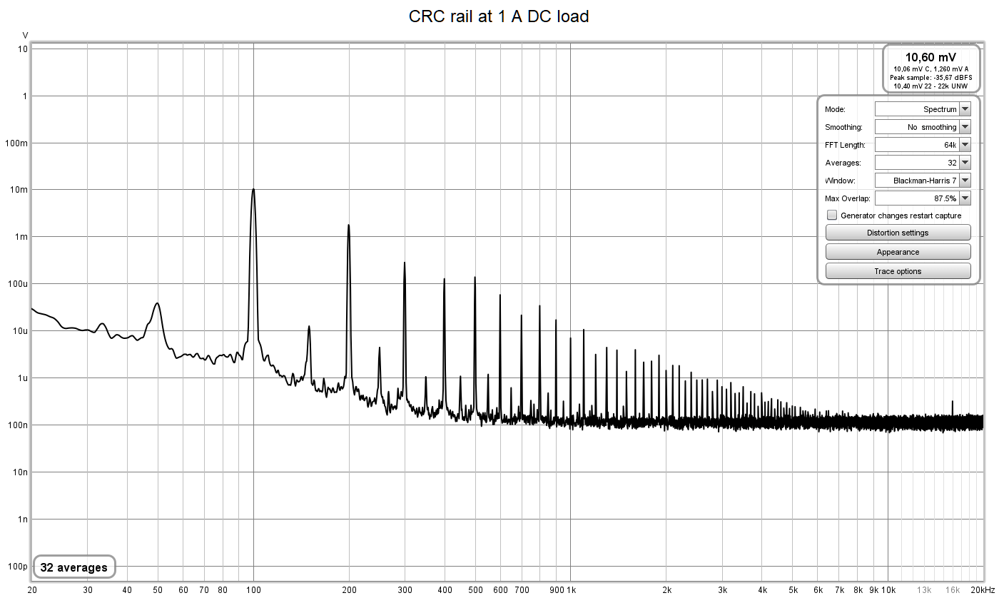

Example of rail harmonics of CRC power supply with 1 A DC load. Example is from low voltage supply for a solid state amplifier, but same rules apply to HV supplies.

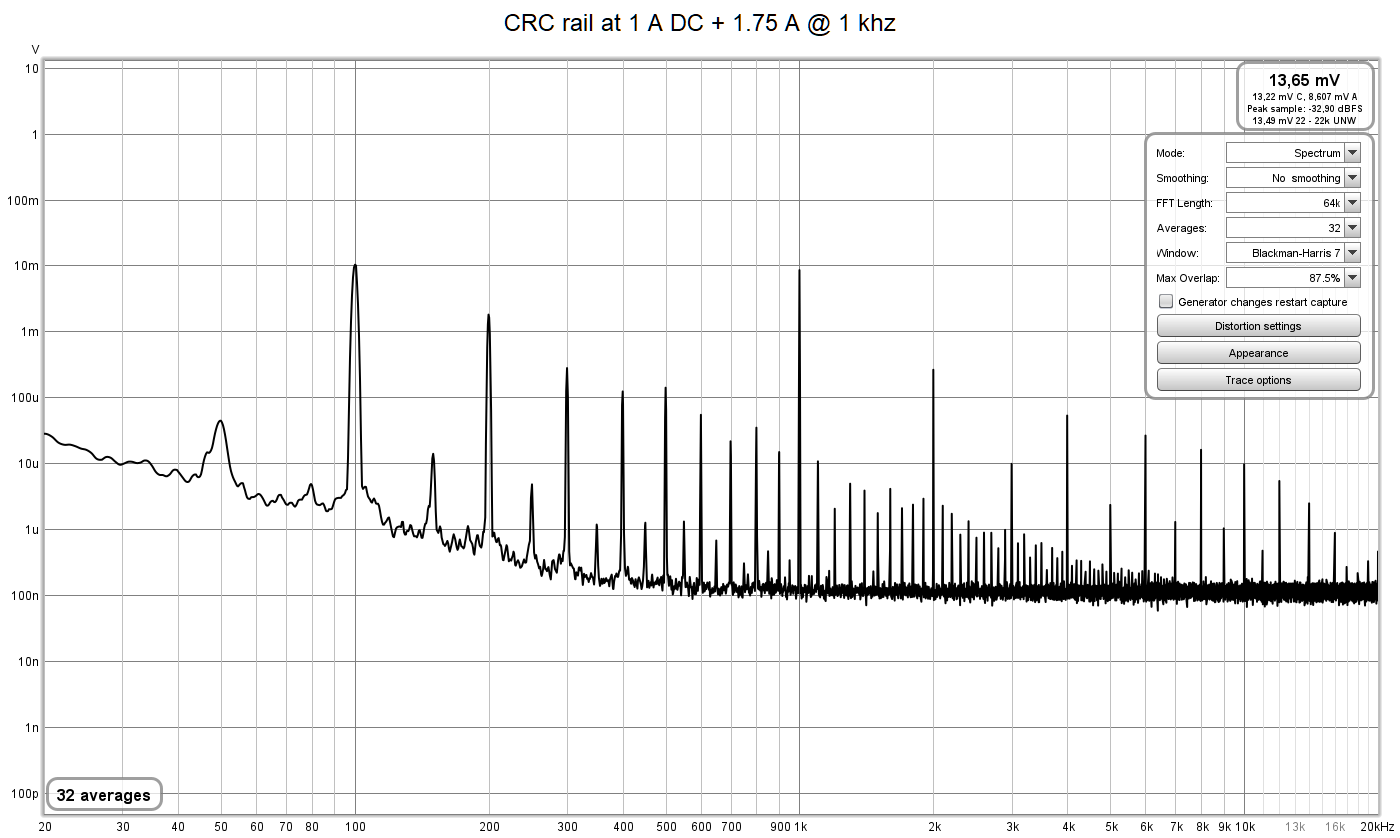

CRC under 1 A DC + 1 kHz 1.75 A rms load. PS under AC load produces harmonics. H2 harmonic is 30 dB below rail modulation caused by load from the amplifier and H3 is another 10 dB lower.
Someone should compare rails of CLCLCLC vs. CLC under load, for harmonics and transient response.

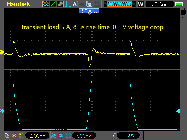

Example of clean transient response of regulated PS under hard conditions. There should be small voltage variation and no ringing:
I am not sure how or if PSUD2 is capable of predicting or guiding, other than the (already challenged here on the thread) POV that the ability of the simulation to control a sudden change in current load quickly and without obvious ringing.
Stepped load is in fact simple transient response simulation, as transient response is power supply reaction to sudden load changes. I don’t know how close to reality is PSUD2’s stepped load simulation.
On real circuit, it could be measured with oscilloscope and active rail load driven by signal generator or by feeding amplifier with large square wave input signal and observing supply rail with oscilloscope. Dummy load at amp. output is required. In this specific case, very high rail voltage makes such measurements a hard task.
