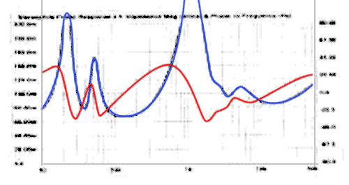

dshortt9 said:
Not much to work with. I've attached the imp with some processing to make things clearer. Far from flat impedance to say the least, but at least at the lowest points the phase is close to 0.
dave
red is phase, blue is magnitude. To imagine the 3-D curve, rotate the red curve so that it is end on, and then it is a projection of the blue curve seen from the top.

Bricolo said:and what does this curve explain?
Generally the flatter both curves are the better.
