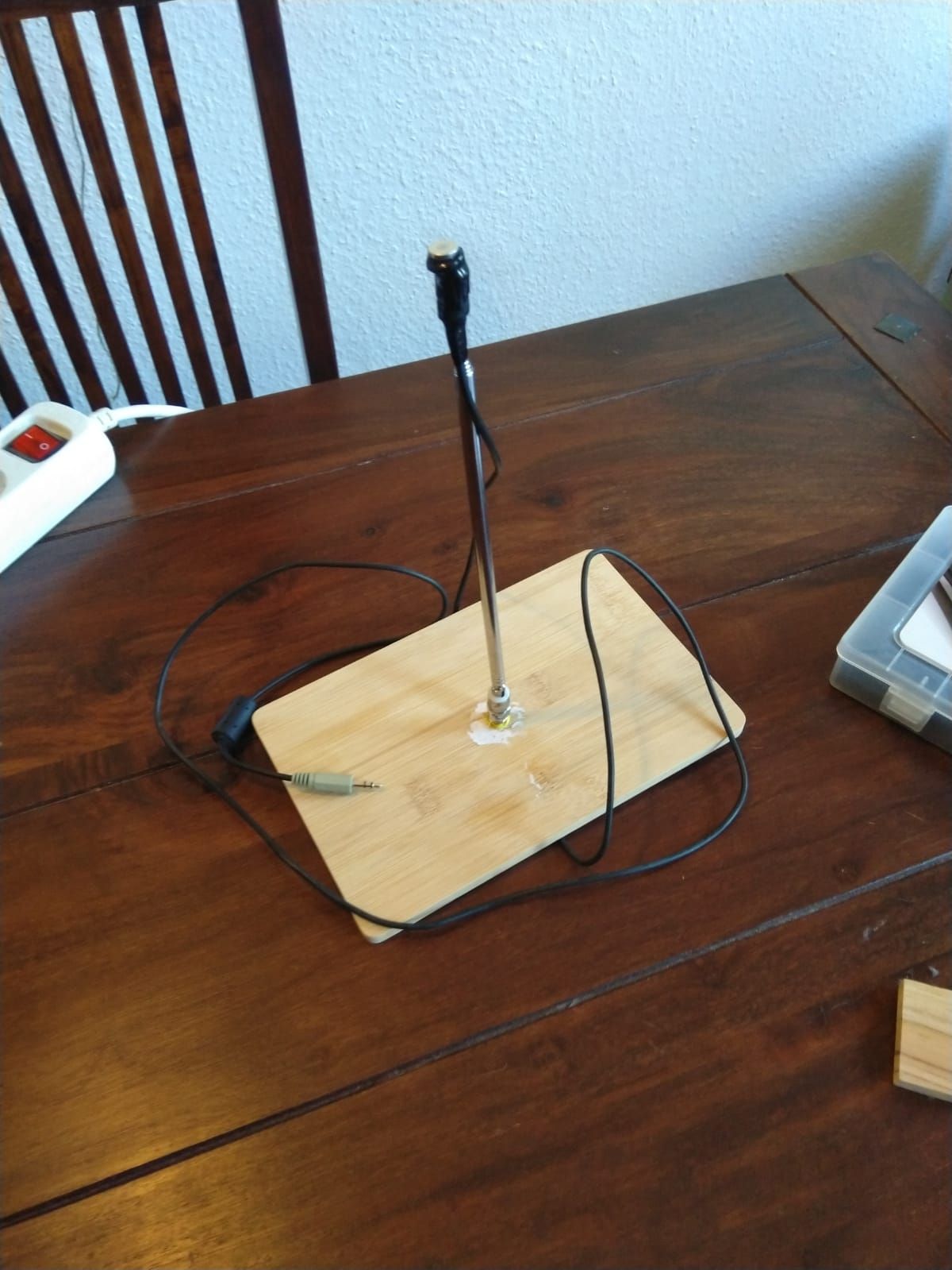

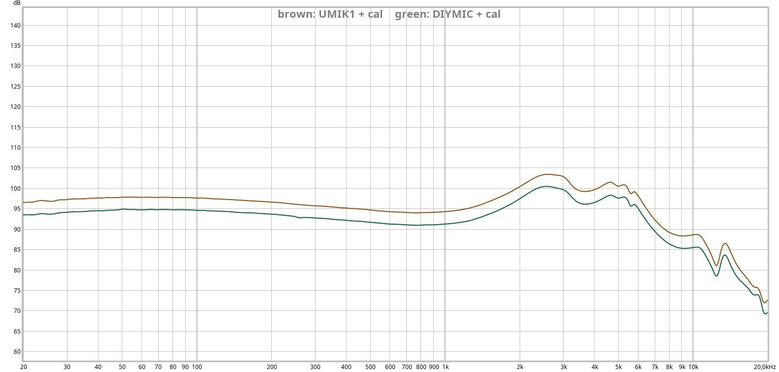

I have a UMIK 1 and have used it to calibrate some condenser mic capsules off of it. This way you can have both a USB mic with all the ease of use, plus a way of making an unlimited amount of well-enough-calibrated condenser capsules. YMMV, of course.
Now I know that second hand calibration is not exactly super accurate. but for my application, it's proven itself to be Good Enough (TM). My main focus is gathering in room impulse responses for room correction with DRC-FIR.
I used some AOM-5024L-HD-R capsules from PUI. They are not as linear as the old Panasonic WM-61 and they have a 6dB dip at about 15k. But the SNR of 80dB (A-weighted) and the subjectively excellent sounding recordings I made with them made me want to try regardless.
The way I go about it is that I take my cheapie chinese IEMs (CCA C10), upgraded with 'Foamer' brand memory foam ear tips, and mount them flat against the mic capsule / UMIK, using heat shrink tubing. I then measure the same channel of the IEM with both mics and calculate a new correction file with LibreOffice.
It's all miles away from being professional or high end, but it's a fun way to spend an afternoon.
This shows the standard IEM on the right and my micro calibration crapshoot measurement jig consisting of a condenser capsule, a heat shrink tube and the IEM tip
My DIY pseudo-calibrated room mic made out of a piece of bamboo from the 1-euro-store and a telescopic antenna
Measurement results of both mics with their respective cal files loaded, measuring the same IEM.
