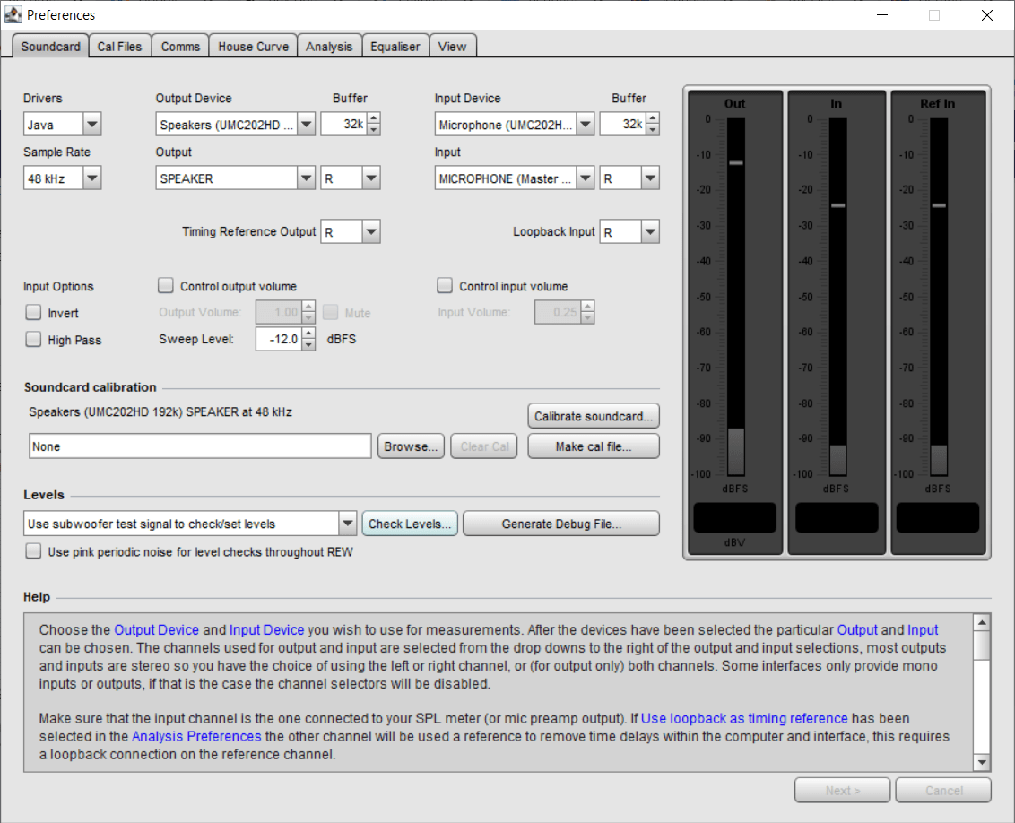

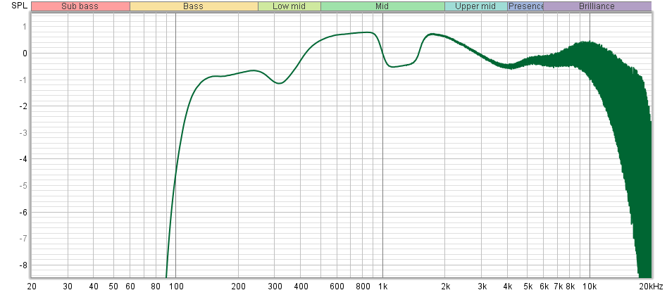

I went through the soundcard calibration process and was surprised at the curve that came back. I'm just looking for a sanity check, could this be correct?
I'm surprised at the low frequency drop off.
That does NOT look right to me. My first guess is that it's not the soundcard but something wrong with the calibration process. I'm not too sure on the settings but two things I notice that MIGHT be a problem. I think you should use Main Speaker test signal rather than subwoofer. And I think you should have your Timing Reference Output and Loopback Input set to "L" with a cable running from the L-out on the back of the inerface to the L-in on the front.
If that doesn't help, post an update and hopefully someone who knows more than me can help.

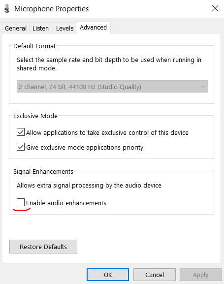

Welcome to Windoze
You probably want to check the stereo setting for the mike too, and adjust the sampling rate to 96kHz.
That same issue bit me in the butt back in 2021 when I first started making serious measurements.Finally figured it out, had to turn off this setting.
