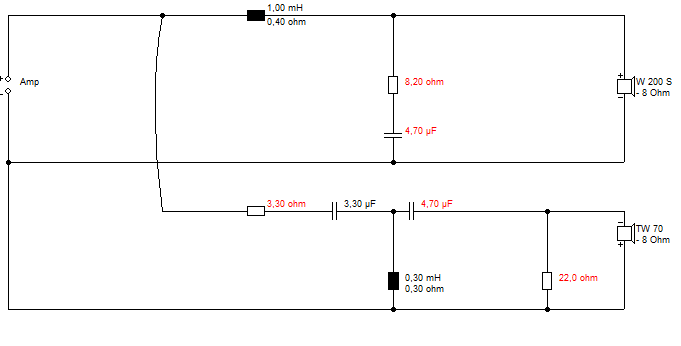

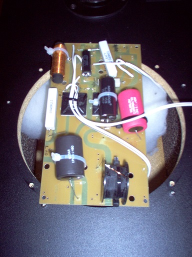

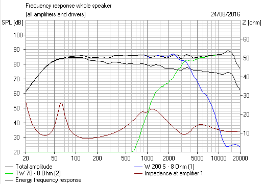

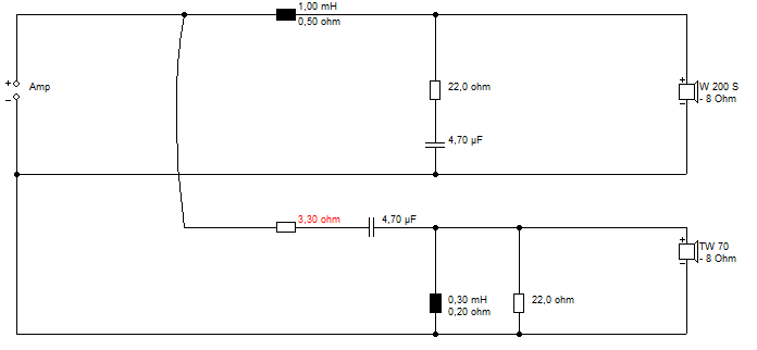

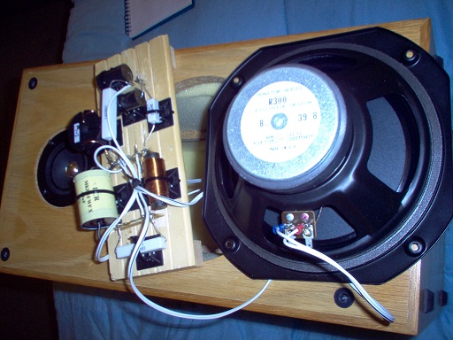

30L box, 11cm tube, and a modified HW 2/70 NG - 8 Ohm should do it.
I came up with something like this. Should do the job. Some drilling and cutting to the premade crossover and you are there.
From the SPL plot, it looks like a 3.2Khz crossover frequency was selected, which seems high.
Several 2-way designs using an 8" midbass use 1.4kHz - 1.6kHz crossovers with 3rd or 4th order acoustic slopes to a "robust" tweeter. 34mm Dome or 2" cone tweeters are used on popular designs.
If you are "flippin' idle", you may want to search for lower/steeper crossover designs to study before final build.

Nice, but a bit of cone breakup from the bass. I prefer my previous near BW3 idea, which damps the bass better. You can do LR4 too, and I have, with 4th order tweeter, but that gets complex. 90 degree phase BW3 solves most of the dispersion issues with a high 3kHz crossover.

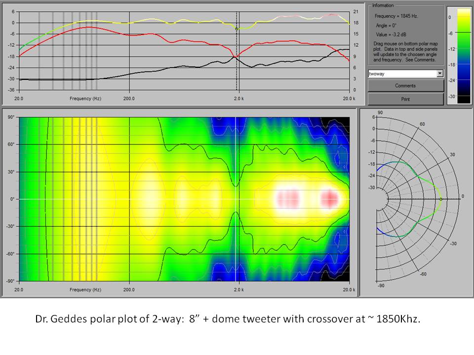

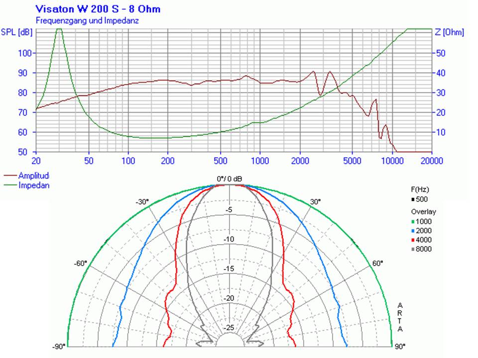

The Visaton W200S cone has ~7.16" diameter, which corresponds to a 1900Hz wavelength. No surprise, the W200S frequency plot shows irregular SPL starting just above 2kHz from edge reflections and cone breakup. A crossover below 1900Hz with an acoustic slope which significantly attenuates this distortion is necessary.
The polar response pattern for the Visaton W200S at 30-degrees off-axis measures -2.5db down at 2kHz, and -6.5db at 3kHz. A crossover at 3kHz would generate ~ 6.5db drop in SPL for listeners sitting 30 degrees off the axis, and everyone would hear an irregular sound stage from the change in energy ratio of front SPL vs. side SPL around 3kHz.
Boxes. The shape of your 50cmH x 29,9cmL x 22cmD front baffle, and the location of the speakers affects the SPL shape. When the sound wavelength is shorter than the baffle width all of the driver energy is projected front(180-degrees). At lower frequencies, the sound pressure wave wraps around the box and spreads the driver energy into the entire room(360-degrees), which drops the front SPL the listener hears. Mounting the tweeter slightly off-center spreads the edge diffraction energy over a wider frequency range.

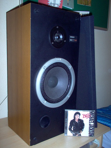

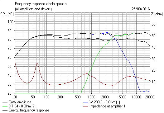

I built this one with a W200S bass originally, but I do like the retro-looking Sony woofer. It has very light acoustically transparent cloth dustcap which I think is good. Very musical, it originally ran with just a 3.3uF cap on the tweeter and nothing else. I bought the Sony E44 in a junk shop for £20 with a mind to doing a better crossover.
If I changed the 0.3mH on the tweeter to 0.2mH, we'd be near the old Celestion Ditton filter. But the bigger coil fills in the power response hole at 3kHz crossover and improves dispersion, ie near 90 degree phase BW3.

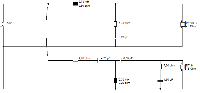

The 90dB Visaton DT94-8 0.8" Polycarbonate Dome Tweeter 8 Ohm is a slot in replacement for the TW70 cone tweeter. You can hear the better dispersion at the very top. It's a pleasant speaker, I have it running right now. The red 4.7R is level adjust on the tweeter, simple as that.

Nice...
W200S - 8 plus DT94 seems like a nice purchase.

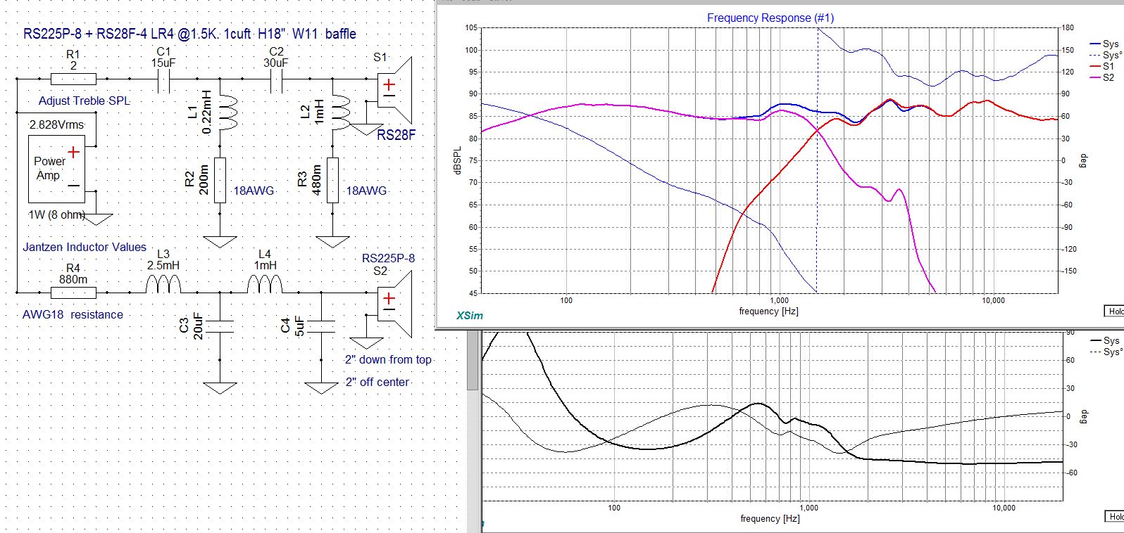

Since you plan to purchase from Parts Express USA which stocks Dayton drivers.
Example: Dayton RS225P-8 (paper) and RS28F-4 (silk) crossed at 1,500Hz with LR4 circuit, in 30L ~ 0.9cuft box with 18" (Height) x 11" (Width) baffle, with 2" diameter x 10" long port tuned to 28Hz. A larger box volume could generate deeper bass. Simulated with the tweeter mounted 2" down from top, and 2" offcenter.
A low-frequency(1500Hz) crossover design you can review.
