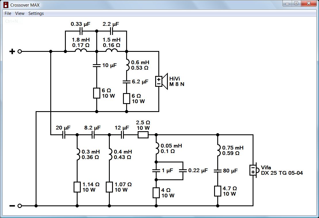

I think you're having a hard time because Wolf has a penchant for series crossovers. If all you're used to is parallel crossovers it won't make any difference what format the schematics are in.
In fairness, Ern, that one is a parallel crossover. Metal cones always need a lot of work at the crossover stage. Lynn Olson hates that sort of time consuming project. 🙂
Bit of a monster, if you don't mind me saying, Wolf. I think I follow it, but I wouldn't fancy building it. 4th order bass and 6th order treble with more notches than I've ever seen. I think it's your Dark Goth style that krafty can't get his head round. 😀

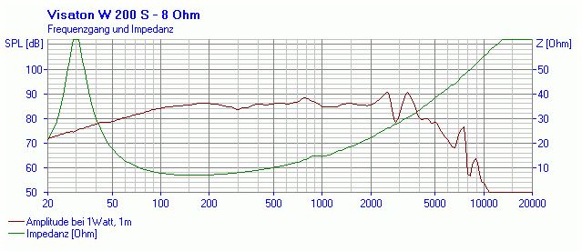

That is a Visaton W200S pressed steel chassis paper bass and a Visaton TW70 self enclosed paper cone tweeter. If you look the driver up, Visaton give you the bass alignment tube dimensions. Don't overcomplicate the cabinet with bracing, reflex isn't all that demanding of solidity, but it'd do no harm to stick some rubber-backed carpet to the sides and top and bottom and a bit of fluff behind the woofer. 3kHz Crossover can be modelled in Boxsim. I'd do 1.5mH bass coil and the rest of my cookbook KEF-type filter follows.
It'll sound great, believe me. I could dream of a SEAS Excel bass driver, but the W200S is not bad at all. That cone tweeter is seriously musical sounding, better than most domes IMO. 😎

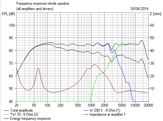

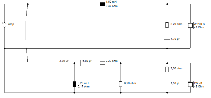

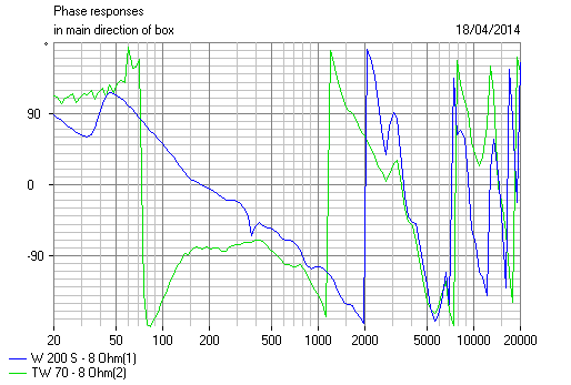

I've got a filter for you to start simming with in Boxsim. I'm not saying it's the very best, but it'll work very well and it's simple enough to be practical.
You can modify it if you see fit. You could take the impedance higher by putting a resistor in front of the treble filter for instance. Boxsim has an optimiser button that is clever.

Wolf_teeth, you will forgive me saying this, but I have a hard time interpreting your schematics. Have you considered using a software like "TinyCad", "Dia" or "Visio" for doing circuits?
I have not as I made my own template. The MAX is an older design from me, so it was an earlier drawing.
Most of my schematics now look like this:
I just made a bitmap template in MS-Paint, and setup as necessary.
If there is anything I can help with, please ask.
Wolf

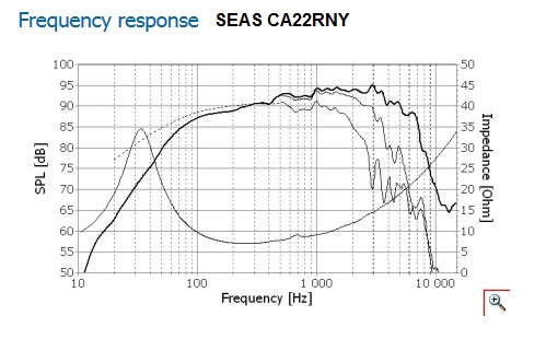

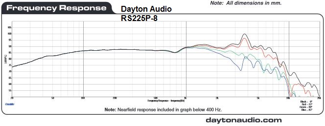

Perhaps those who are recommending the composite Dayton Audio RS-225P-8 would like to put their money where their mouth is and suggest a circuit for it.
It certainly needs entirely different treatment from the SEAS and Visaton style woofers I have been talking about.
Doesn't look so easy to me. I think we are talking a complete redesign and lower crossover point here.

Face posted on AVS that he has a pair and will post up results of the RS225P.
Those who post suggesting they aren't going to be good as well as those who think they are the next best thing should wait for results before praising or bashing.

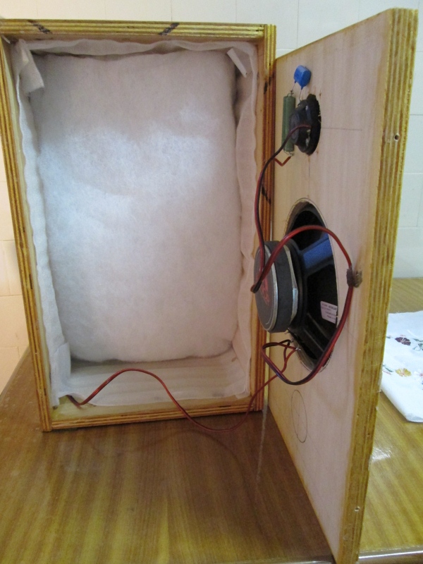

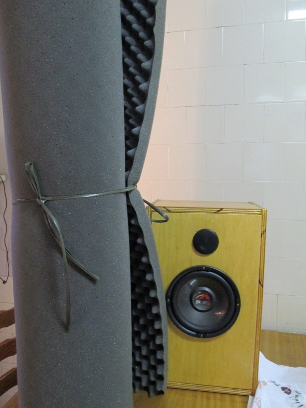

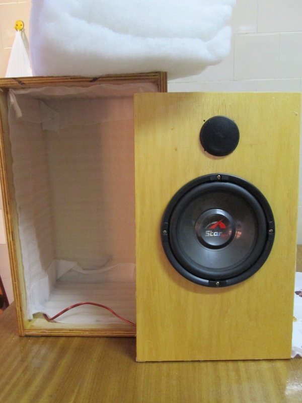

As I did in my other topic, I will do here as well: post pictures of the current enclosure damping material. Will replace for the egg crate foam. At the time when I built that box, I had no idea of what I was doing, but I used gaskets and polyester damping sheet. I also surprised myself that I had drawn a place for a port right in there. Now I just have to cut it. 🙂
My goal will be finding the best cost-benefit driver for this 30L box. I guess anything will be superior to this Hinor crap and piezo.
