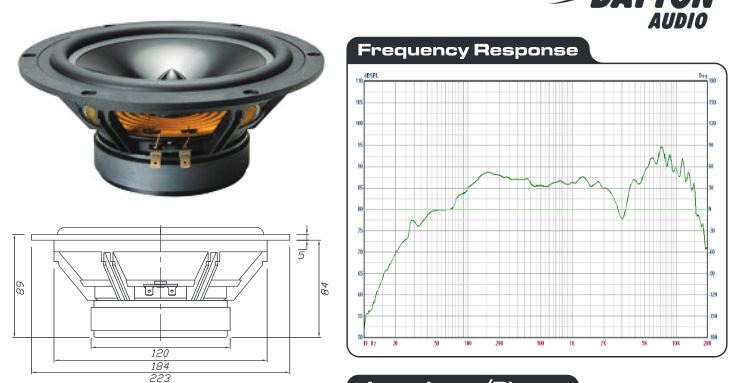

Has anybody actually looked at this Dayton Audio RS225-8 woofer that krafty is so keen on? 😕
Flippin heck. I was wondering why it was being implemented with such a complex 4th order filter and such a low crossover in the RS Duet. I just put it down to that peculiar American obsession (Zaph, I'm looking at YOU! LOL) for low crossover. But no, the reason is that it's a metal cone!
Just the sort of thing I would run a mile from. 😛
krafty, read my lips. You are out of your depth with that one. And your chances of aligning it with an 8Khz XO piezo are zero.
Not that I honestly fancy aligning that piezo with anything in the 8" bass range unless the sound of cone breakup is your bag. 🙄
I would agree with you, this time, on this one 100%. 😀Just the sort of thing I would run a mile from. 😛
Ok, so well pointed out. I couldn't see this one coming.

Dayton DA215-8 (datasheet) superior to Silver Flute?
What about DC200-8 (datasheet) ?
I was looking at Silver Flute previously mentioned model... but the enclosure demanded is around 16L, from both manufacturer and WinISD. Even WinISD recommends a smaller enclosure. The RS225-8 was the only option to fit on this 31L/vented. Now these two Daytons are quite affordable!
both quite useless. the first is an aluminium cone. the second is a high inductance subwoofer. 😀
neither have a remotely smooth frequency response.
