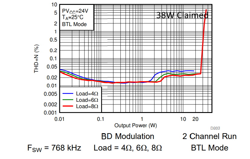

>Typically an amplifier rated by the seller at 50W amp is only clean to 20 or 30 watts.
I'd assume many of these class-D amp are similar to the distortion profile below. That is, they're pretty good at all levels of power, right up to just before the very maximum.
It makes sense; when you hit 100% duty cycle, it's a pretty hard stop. But clean through a little better than 1/2 rated power -

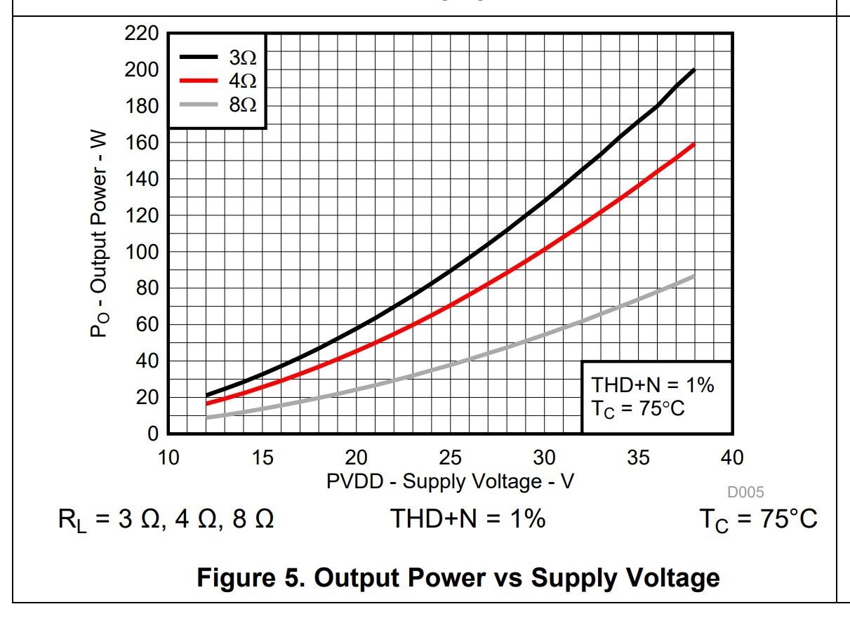

On the one I have max volume is all the way up, whereas something like my classic Nikko amp reaches max volume at 14:00.
Also it's more like half 110w (4Ohm) at 31v so about 45w (8Ohm) before distortion sets in.
That's not bad, you have to read the spec sheet in context. It's able to produce 160w 4 ohms at max rated voltage and with a much beefier power supply.

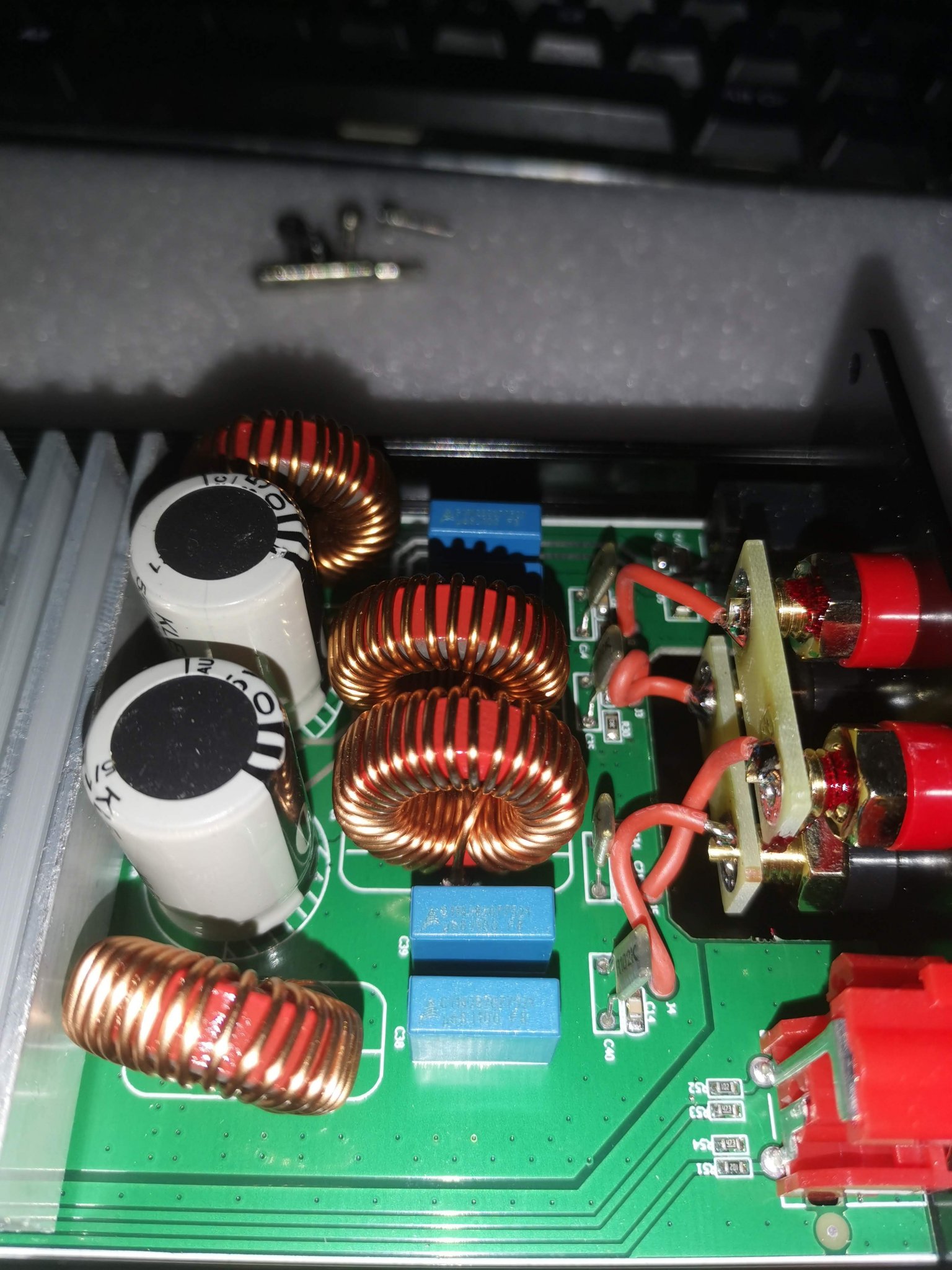

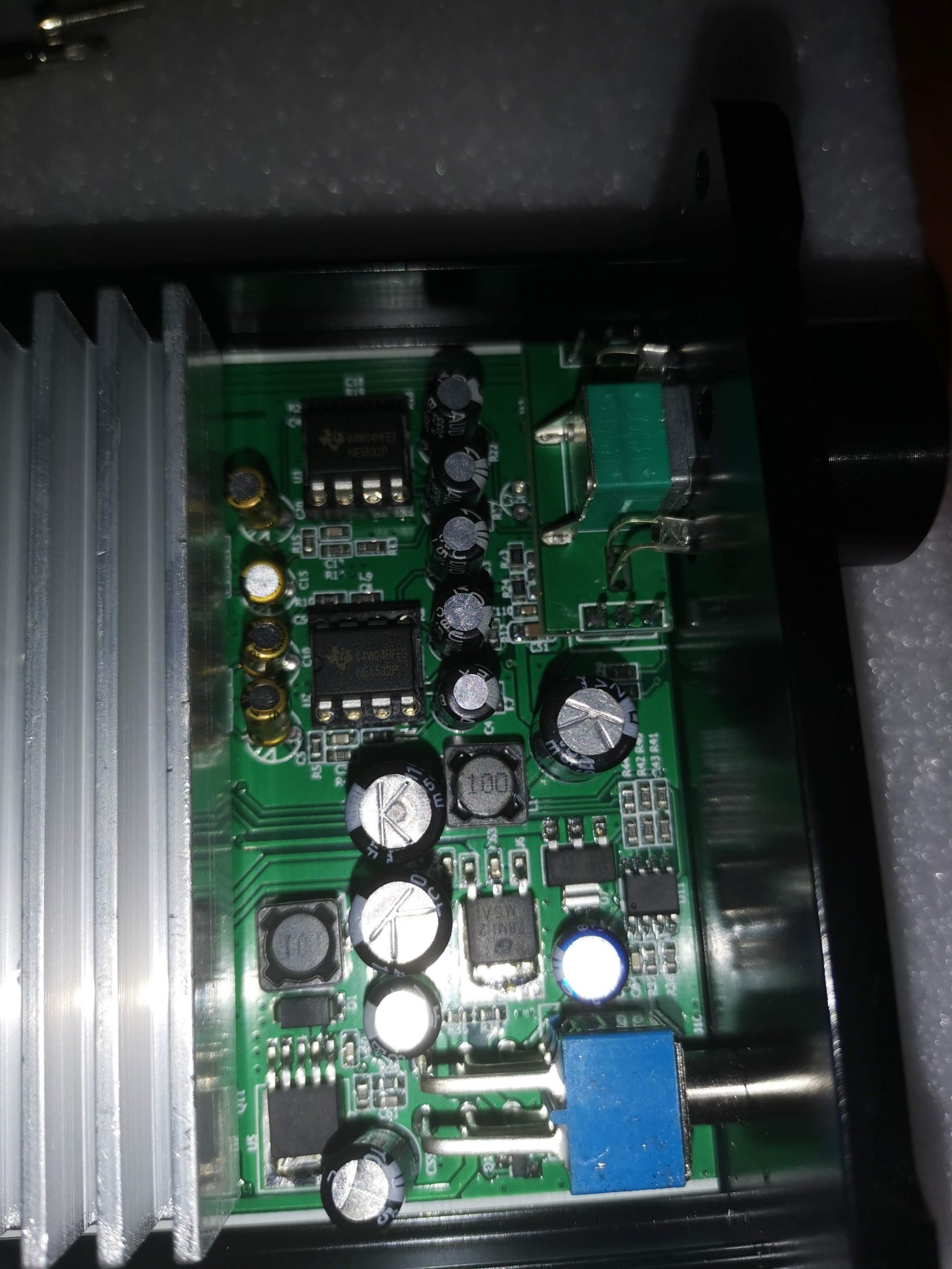

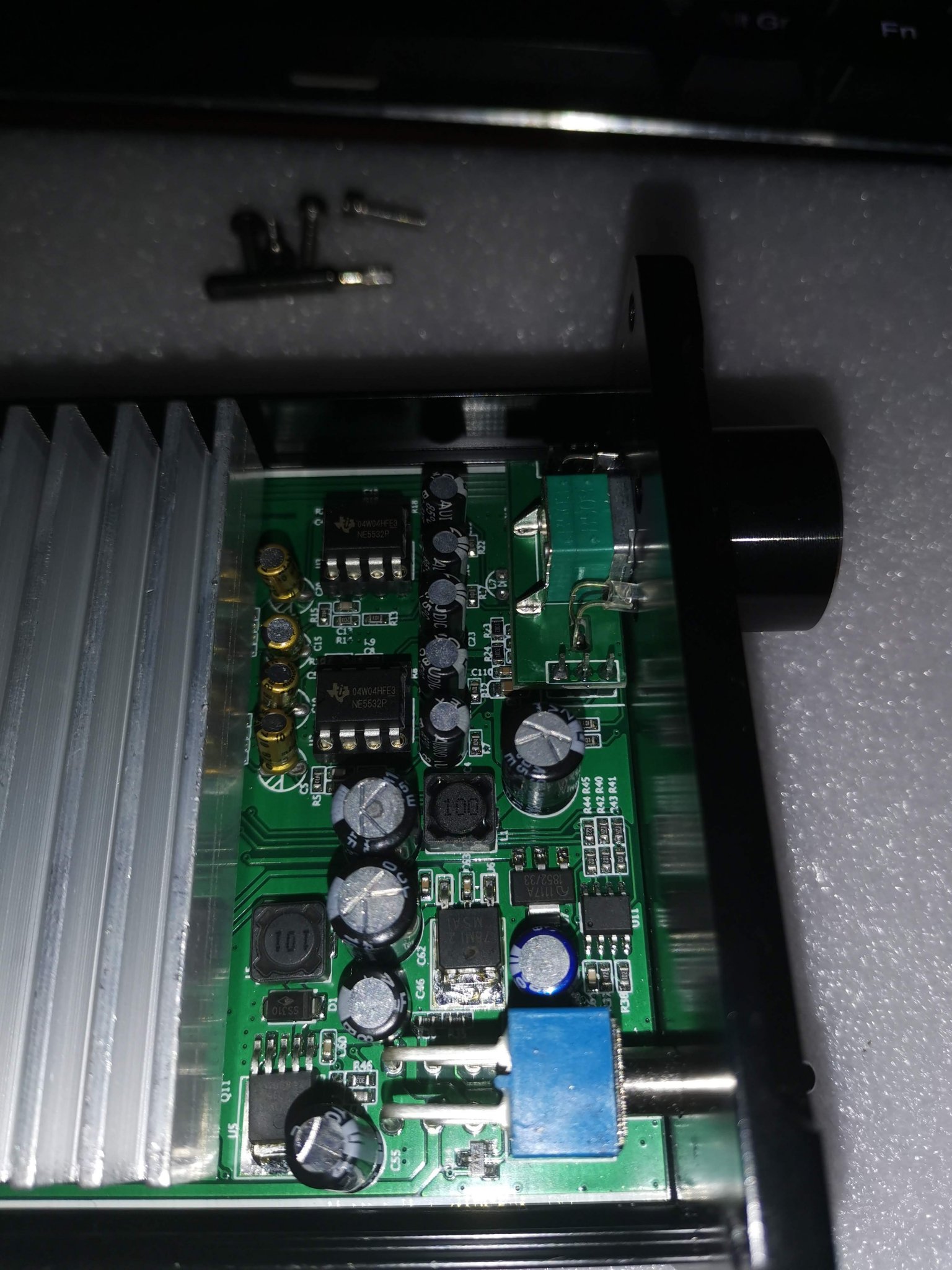

As Majster88 mentioned, this amp is probably Aiyima A04. There were a few mentions of this Tilear amp a year ago when people were comparing different revisions of Aiyima A04.
If you open your amp up, you might want compare your amp to the various prior Aiyima/Tilear pictures to see which revision yours is.

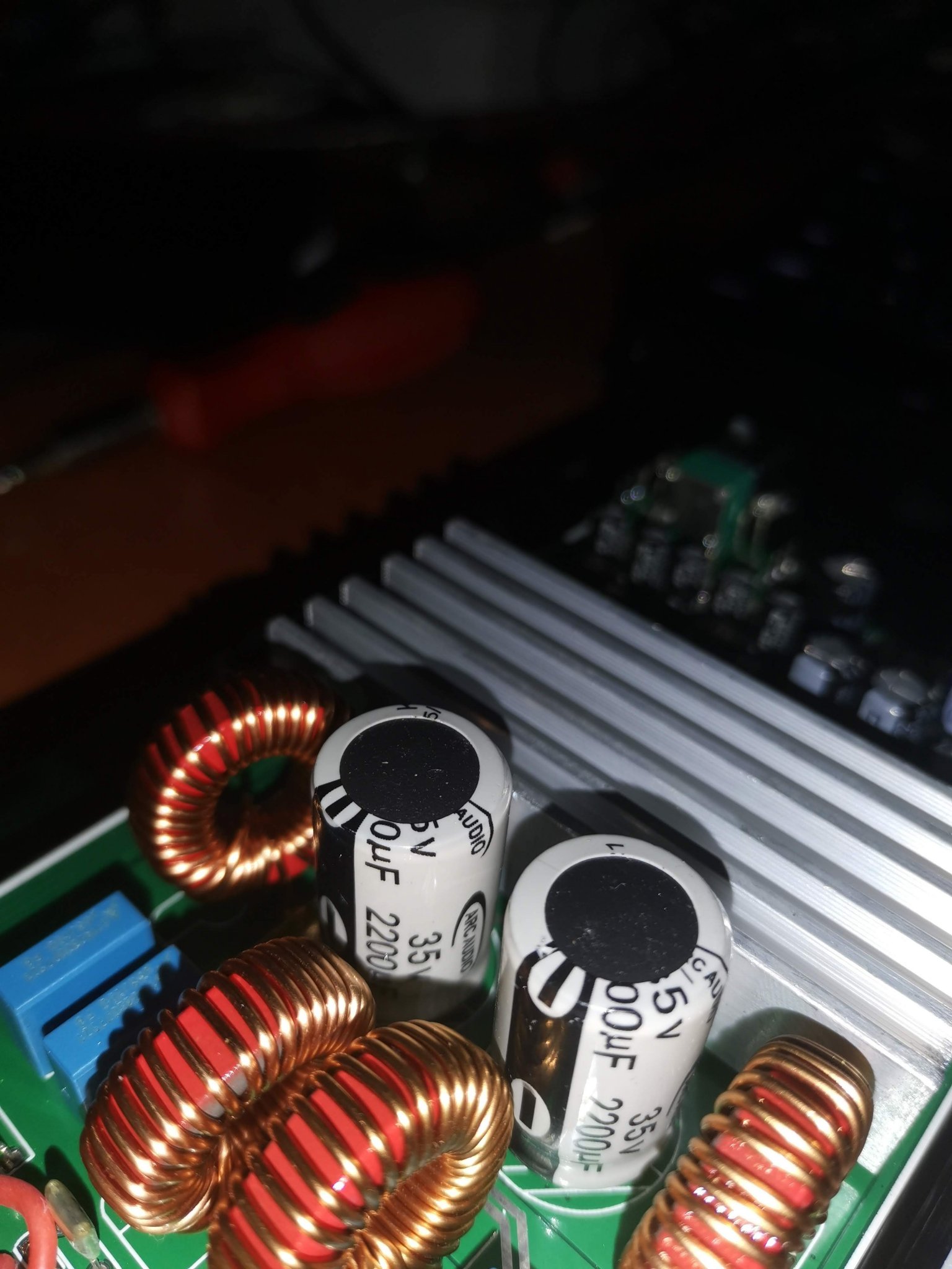

I just got my Aiyima 04 today. And it seems to be the last revision with 2200uf Arc Audio capacitors on green pcb. The smaller capacitors are rubycon, mid capacitors are "Audio" brand and the smallest gold seems to be nichicon. It sounds very good but I also have 2 other small amps. XY-AP15H, Zk 502T and with my speakers I dont really see a big differene between them 😛 I can also confirm that Aiyima 04 works with 12V adapter with no problem and I have still a lot
of power left.
of power left.
