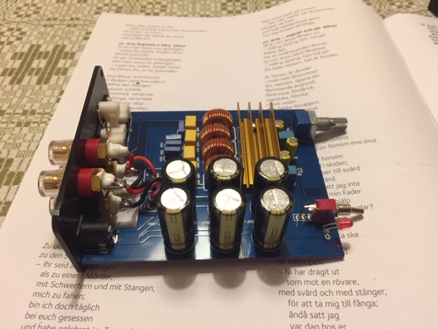

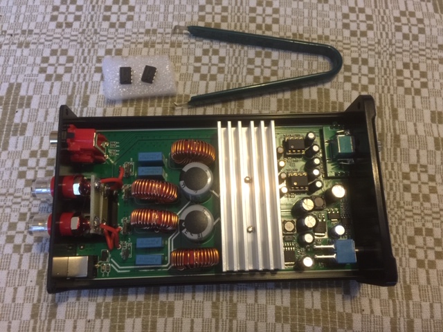

Aiyima a04 tpa3251 is VERY good .
I have two of them, - better, cleaner sound than my three klass A/B poweramps, two of them with lm3886 and Crown xli 1500.
I also have two 3116 D2 amplifiers with modifications made. They also sound very good.

Strange thing is that Watts rating change with the DC Voltage used.At what voltage are you running your Amp?
Hi Whoops,
That's not strange, it's physics, Voltage x Amps = Watt.
I select the Voltage I use to the speakers I want to power.
At the moment my amp is running on a 12V 5A laptop powersupply driving a pair of 4 Ohm speakers.
I can go up to 24V, making the amp play louder, but the range on the volume control gets smaller; meaning it gets (too) loud very quick with just a small movement of the volume control.
For your 8 Ohm speakers, I'd get the 24V powersupply.
While the Aiyima A04 TPA3251 gets good reviews, it comes without a powersupply, which makes it less 'budget', unless you have a spare laptop power supply lying around...
Regards, Jan.
Those are rated at 175W,
they dont specify it but I guess it's 175w at 4ohms, what do you think?
So that will be 87w at 8ohms am I correct?
Maybe that a bit high for my needs, the speakers are around 20w at 8ohms
