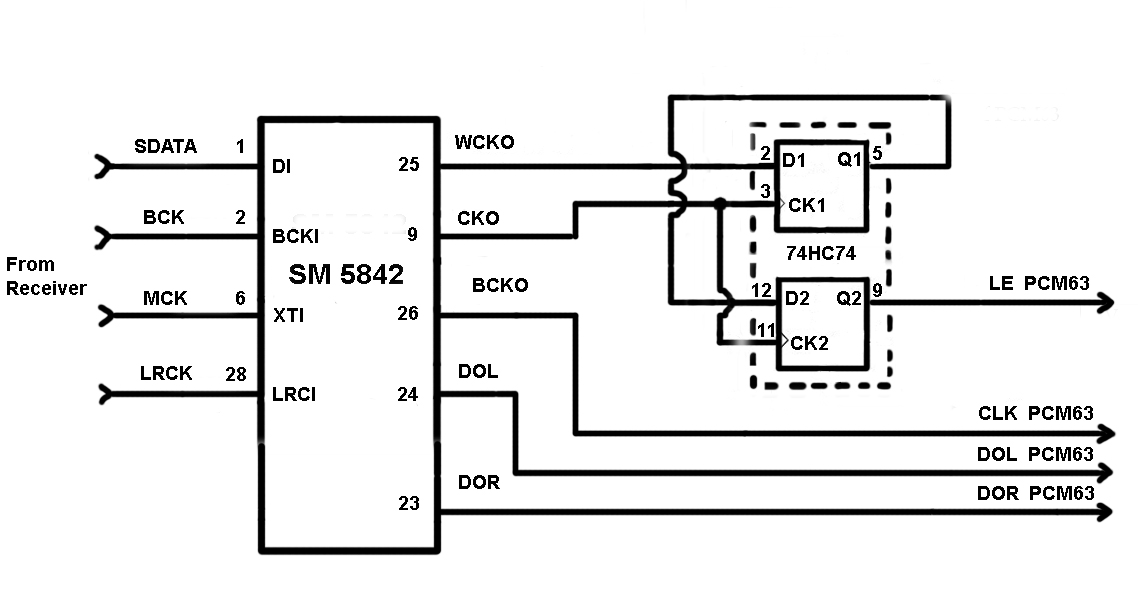

I would like to try simple 2X LE reclocking as per 2. In original post
setup Is based on digital receiver, SM5842 and PCM63 without external XO
Would you please check out attached diagram for errors
I am not sure If passing LE signal through 2 x gates without touching all other signals DOL, DOR, BCK Is correct
I thought I should post my efforts here for the record and benefit of other digital newbies:
In reclocking the signal between the the 5842 and the PCM63, I tried:
1.Reclocking LE (Latch enable) with a 74HC74 flip flop using CK (pin 9 of 5842): Result was ok.
2. Reclocking LE twice (i.e. 1D-1Q to 2D and output from 2Q) using CK on a 74HC175. Better result than single reclocking
3. Reclocking LE 3 times using 74HC374. much louder than 1 or 2 and lots of detail, but noisy spikes at certain parts of the music;
4. Reclock LE 4 times: Worse noise than 3 and louder than 3.
Using 3x reclock on LE, I then reclocked DATA once-still some noise;
Using 3x reclock on LE, I then reclocked DATA TWICE-noise gone on MOST songs, but still present on some music.
Using 2x reclock on LE, I reclocked DATA and BCLK. Using CK of Sm5842, I got nothing but noise; Using an indepedant 11.xxx clock, I got nothing but noise....
So I have settled on just reclocking LE 2x, using 74HC174. Data and BCLK are not touched.
Any feedback welcome.
samoloko,
The purpose of reclocking twice is minimize chances of metastability occurring at the D-FF output.
You would need to look at the signals with a scope to see what is actually happening with your proposed circuit. D-FFs have setup and hold time requirements to pass data reliably. That means WCKO edge would need to have passed and WCKO be at either a stable high or low before the triggering edge of CKO occurs. If all the signals coming out of SM5842 are switching at exactly the same time, then there will not be time for the D-FF Data input pin setup and hold specifications to be met. The only solution might be to delay and or invert one of the signals enough so that the relative phases of WCKO and CKO are correct for predictable D-FF operation.
Regarding the question of whether or not the other signals should get reclocked too, it depends what the scope shows about their timing and what the dac chip likes best in terms of signal timing. The datasheet should contain information about requirements for the digital input signals. If not, and if the dac chip is designed to be used with SM5842 then maybe the dac chip is designed for the signals to be in the same phase relationship as when they leave SM5842. Otherwise, maybe they should be all aligned together. Don't know myself since I haven't spent time with dac chips of that type.
EDIT: Please see the attached document for more info on metastability.

Yes. That is like Markw4 said. But it is not only about metastability issues. Whem we clock just one section F-F then output is shifted ont the opposite edge with clocking sygnal. Master clock usually. And if we use later this MCK it will be out of the phase within other lines. Actually other lines will be shifted with 1/2 cycle of MCK that clocks F-Fs.
So proper recklocking should consists of 2 cascaded F-F
But as wee can saw this is not the case in most of diy implementations...
And clocking F must be at least 2X higher MCK than BCK we want to recklock.

No it isn't.Whem we clock just one section F-F then output is shifted ont the opposite edge with clocking sygnal.
That is called Brute Force Synchronization and it is not necessary when the signals in question are in sync. You would definitely not need it with the SM5842 and the PCM63.So proper recklocking should consists of 2 cascaded F-F
