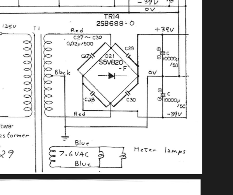

If you look at the circuit you can see that they are just two series connected caps. Same as any other symmetrical rail amp. The junction of the caps connects to the main amplifier ground. The "plus" terminal of the top connects to main +39 volt rail and the minus terminal from the bottom one connects to the main - 39 volt rail.
All you have to do is identify those points on those PCB's and wire accordingly.

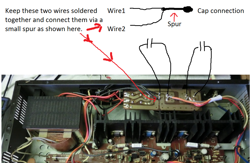

Lets try and make this easy. You connect each new cap to just the rear set of pads on the PCB. That leaves all the four front pads free.
Look at the picture.
Its up to you to determine the cap polarity... I can't tell from the picture.
Those two black wires essentially connect to the cap terminal above it but to preserve what could be an attempt at star grounding, keep the wires together and then connect them via a small spur of wire (any length, 2mm 22mm it doesn't matter). The words "cap connection" in the picture refer to the connection above that has the single black wire. It might seem illogical not just to join them all together at that point but its done this way for a reason to prevent ground interactions and problems.
