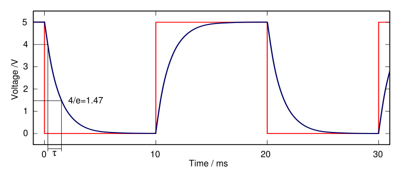

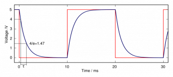

Now, on that RC chart, raise R until the cap thinks it's being driven by a constant current source. Maybe 2 kohms for a 220 uF cap. Drive with maybe 10 Vpp or more. Use you're most sensitive scope, 1 mV/div or less. Raise the frequency until you get a nice triangle wave at an amplitude you can see. Now try different caps. Most horrifying will be very low voltage aluminum and most flavors of tantalum. I may have the details off- adjust as necessary, but you get the idea.
I understand the triangle wave part. What you don't say is how the wave shape for a bad capacitor differs from a good one. What do we look for?Raise the frequency until you get a nice triangle wave at an amplitude you can see. Now try different caps. Most horrifying will be very low voltage aluminum and most flavors of tantalum.
A perfect cap would charge up and down linearly because the current is essentially constant for the small change in voltage across the DUT. Thus, you get a near perfect triangle. Anything else is a result of dissipation factor, dielectric absorption or some other type of distortion. You'll know it when you see it, as it's not subtle!
Audio logic can be misleading, but I figure tantalum=bad=triangle bad, so low voltage aluminum electrolytic triangle bad=bad. OTOH, any reasonably sized coupling cap should have near zero audio signal across it (save for filters and crossovers), so they should all sound the same. That, however has been beat beyond death so isn't worth talking about unless somebody has some new theories and numbers.

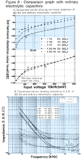

Figure 8, A and B are comparison curves showing non-linear distortion characteristics, impedances and E.S.R. characteristics of electrolytic capacitors widely used in smoothing circuits of power supplies in ordinary personal computers, etc. and Black Gate N series.
These curves clearly show that the source of the electromagnetic waves is the electrolytic capacitors.
In Fig. 8, A, the difference between ordinary electrolytic capacitors and Black Gates reaches 50 dB and the difference of E.S.R. value is 10 times in Fig. 8, B. These figures show that total difference is amount to a big value of 60 dB. In other words, it is understood that ordinary used electrolytic capacitors generate harmful electromagnetic waves of 1000 times larger than the waves generated by Black Gates. With the ordinary electrolytic capacitors, improvement of only 6 dB or 10 dB in suppressing the harmful electromagnetic waves can be obtained by taking some measures which are far away from 60 dB. The fact is proved that only Black Gates can reduce the level of harmful electromagnetic waves to -160 dB for the first time which level is below natural noise level (-120 dB). Black Gates also can be said to be the sole elements that suppress the harmful electromagnetic waves. See Technical Report No. 111.

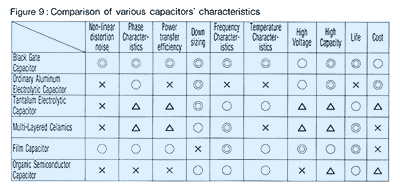

Figure 9 is a comparison table in which characteristics of capacitors ordinarily used for electronic devices and the Black Gate with respect to 10 items. According to the table, the Black Gate gets full scores for all the items. Since such difference has never been achieved before, this fact shows that the status of King of Capacitors will be firm in the coming century.
