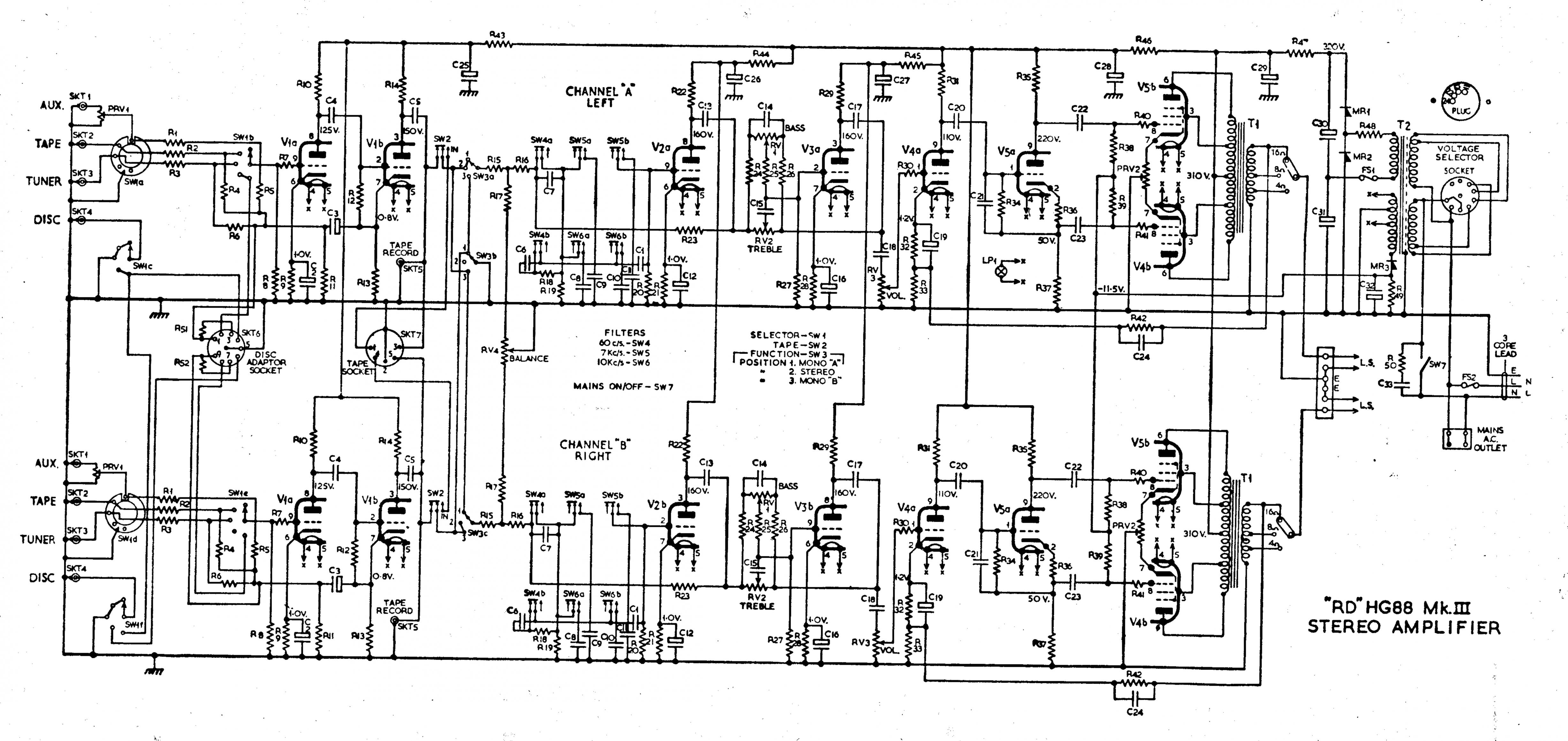

It's a Rogers HG88 Mark III integrated valve amplifier, big brother to the more ubiquitous Rogers Cadet III that you may have heard of. I've owned it from new.
It employs four Brimar ECC807 valves, which are now unobtanium, and four rare Mullard ECL86 valves. Power output is 15W per channel.
HG88 Mk III Ampl/Mixer Rogers, Catford see also Rogers Birmi

. . . usually *Preamp* tubes have cathode decoupling caps ... and those are usually electrolytics ... smack in the middle of the signal path.
That's certainly true of my Rogers amp - 50uF electrolytics in the circuit attached earlier.

It doesn't completely eliminate the resistor from the circuit since the reactance of the cap will change with frequency. You've paralleled a reactance with a resistance. It is in effect a filter. At a given frequency, the cap's reactance will equal the resistor value.
The static, DC operation will stay constant while the dynamic, AC operation will change depending on frequency.
But since we're dealing with feedback, I could point out to a specific poster, it is not smack dab in the middle of the signal path, but only determines the circuit AC gain at any given frequency. Resistance on the cathode causes feedback and bypassing increases the gain (reduces feedback) at frequencies above the point where the bypasses reactance is equal to the cathode resistor value.
...and before anyone jumps on me... I do realise the open loop gain for a single triode is determined by other factors. The decoupling cap in a solid state circuit doesn't function in exactly the same manner.
This is what I've learned and please feel free to correct me if I'm wrong.
