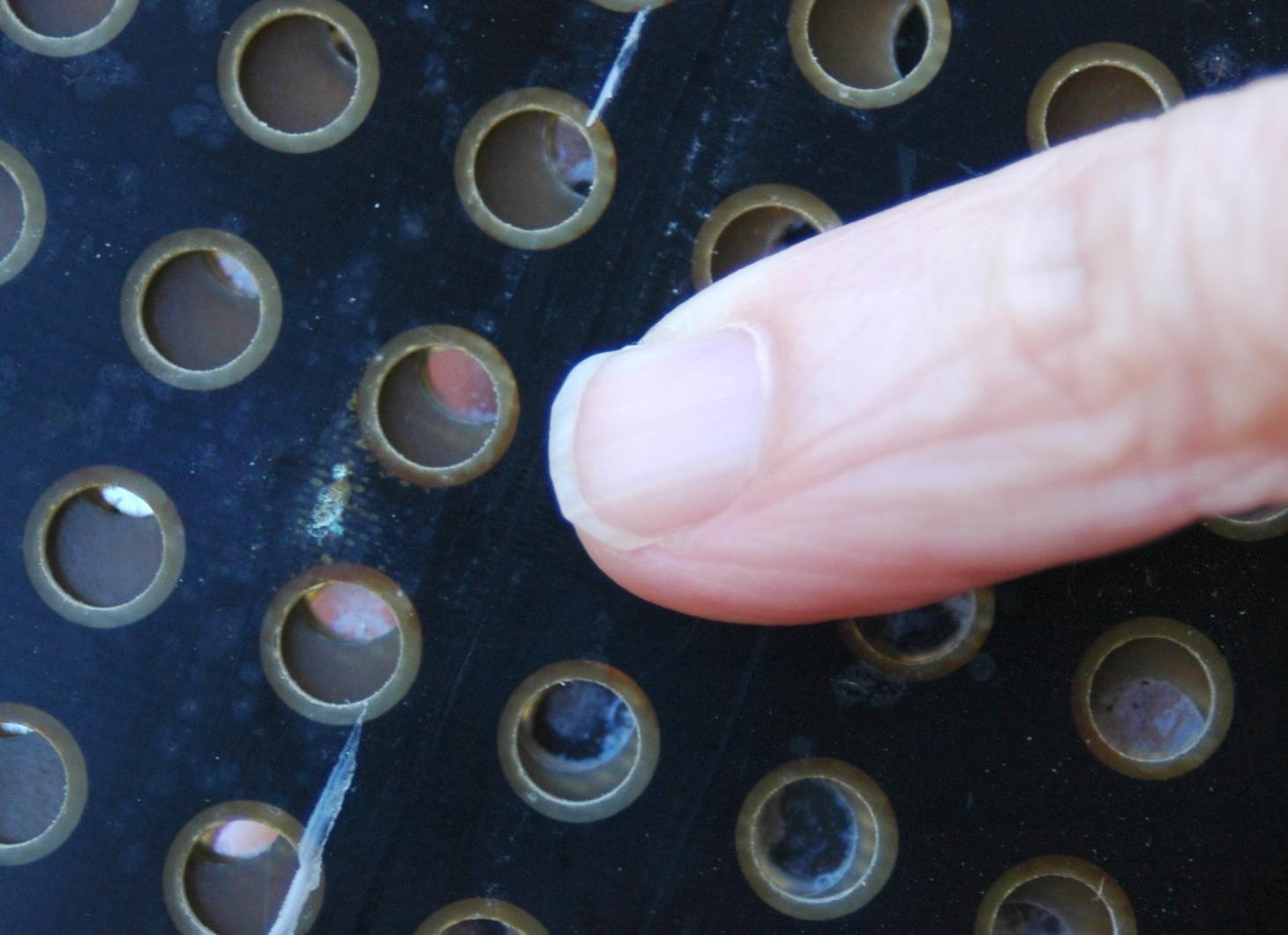

Hello.
Do conductive pattern material of Beveridge PCB type stators is known?
Is it:
carbon compaund on glass fiber
carbon compaund on glass fiber and carbon covered with nylon layer
carbon compound on copper layer on glass fiber
carbon compaund on copper layer on glass fiber and carbon covered with nylon layer ?
And possibly variant of carbon as carbon nylon compound with distributed resistivity without need of clear nylon layer.
And what surface resistiviry carbon layer have?
(The photo from RMS).

Hello,
I don't know the answers to your questions since I haven't owned Beveridge speakers for several decades.
The best place to get the answer to your questions is probably from Rick Beveridge. Beveridge audio still has a website you can access directly.
