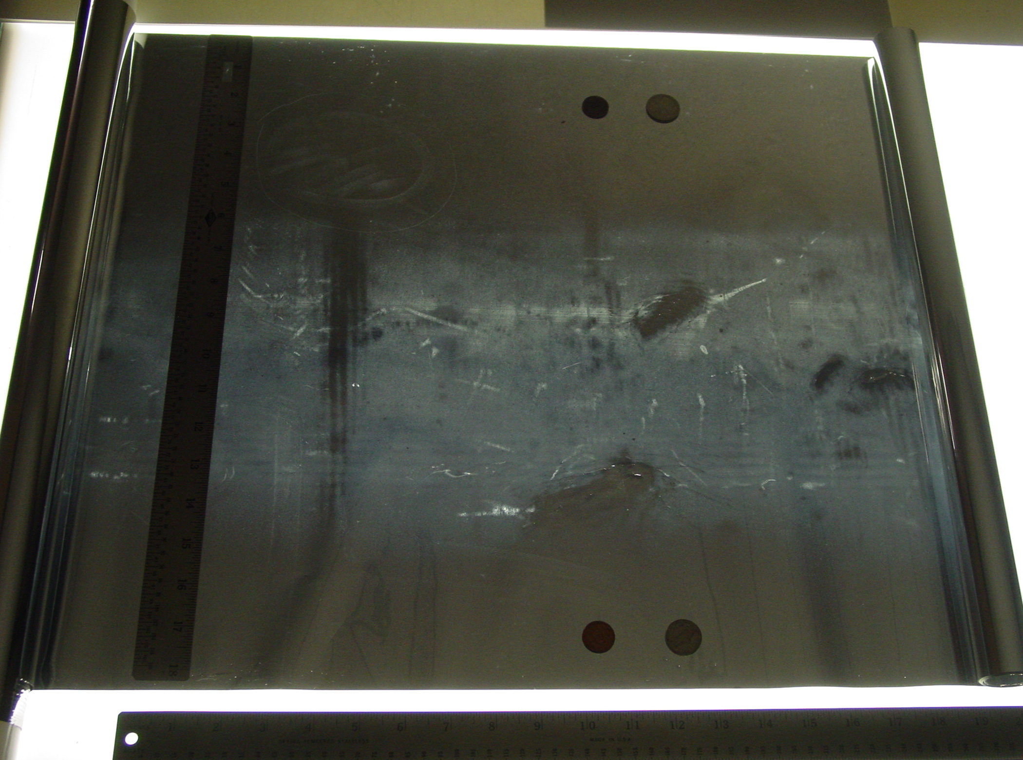

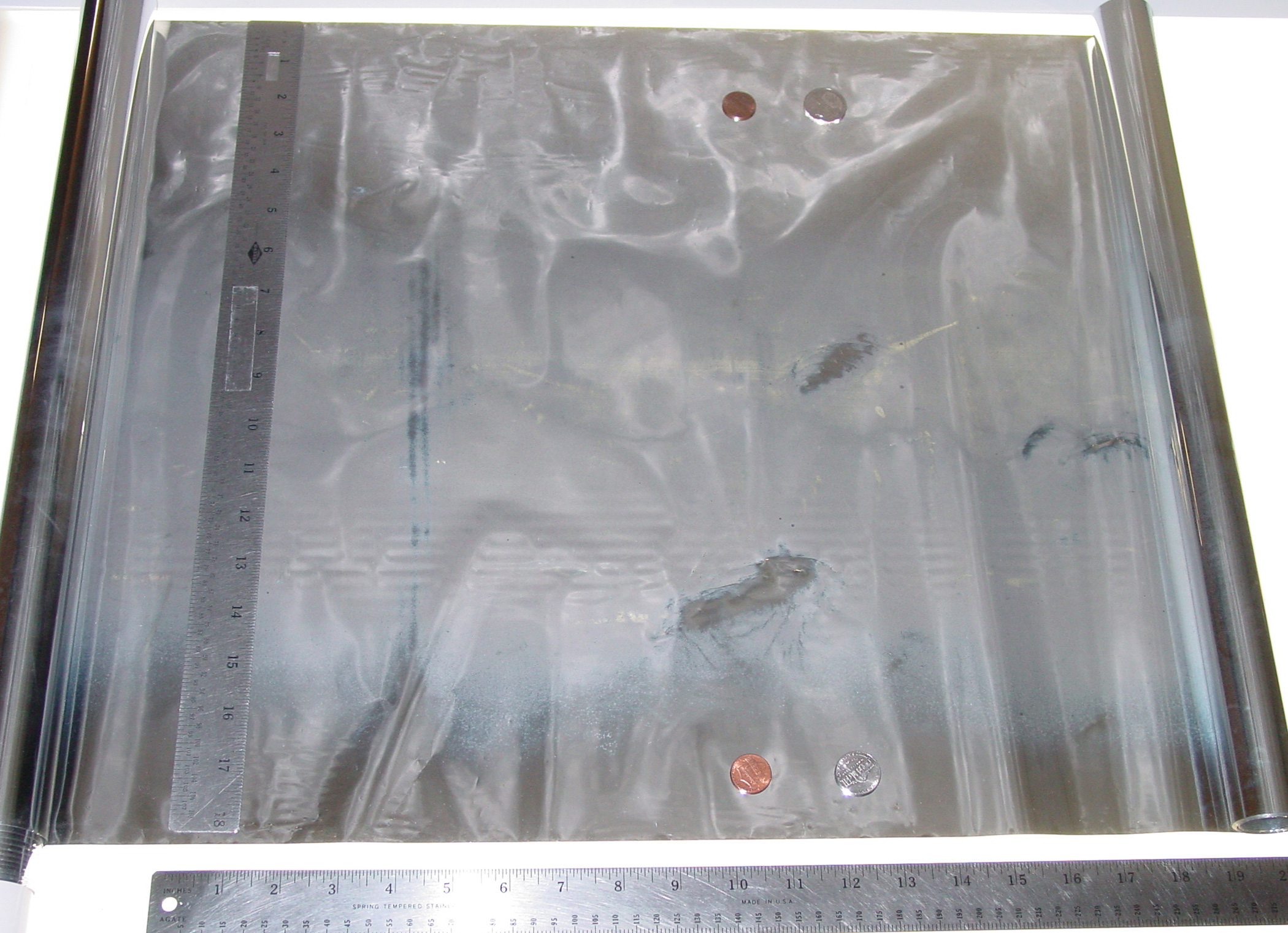

Here are 2 pics of the mylar rolled out on a large light table to back light it.
With and without overhead room lights and flash.

Maybe the weak coating is still sufficient for good charge coverage.
And I will now pull my panels and give them the identical back lighting to see how the mylar looks. It is really very difficult to clearly see through the slots.
