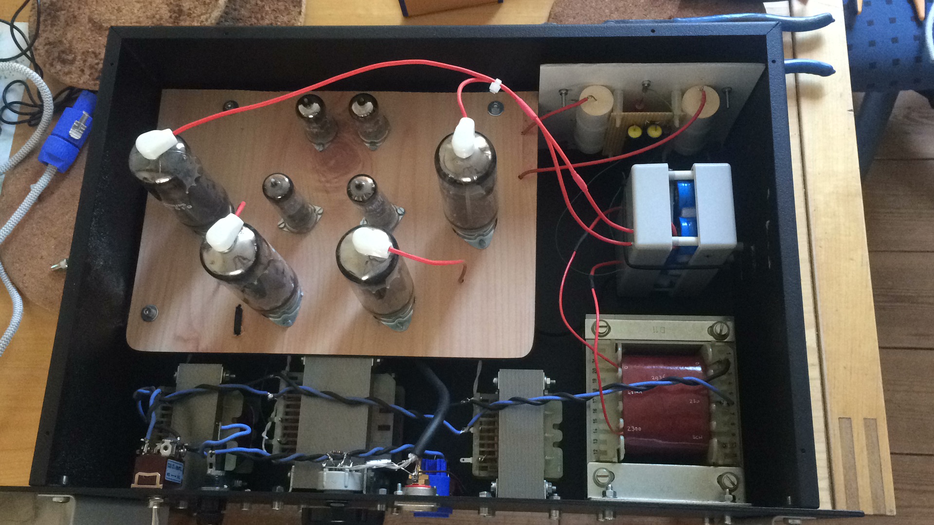

I have rebuilt the amps for my 2 Beveridge II sets (one with SW and 1 without)

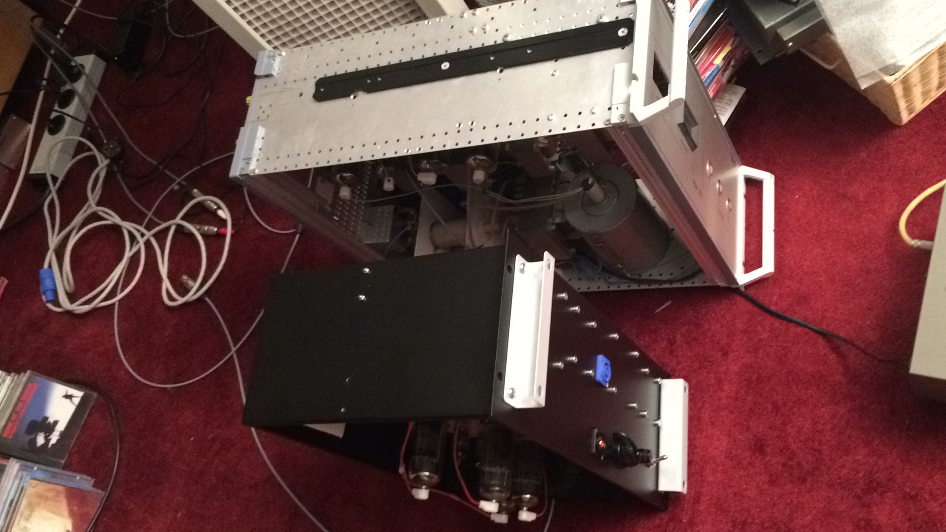

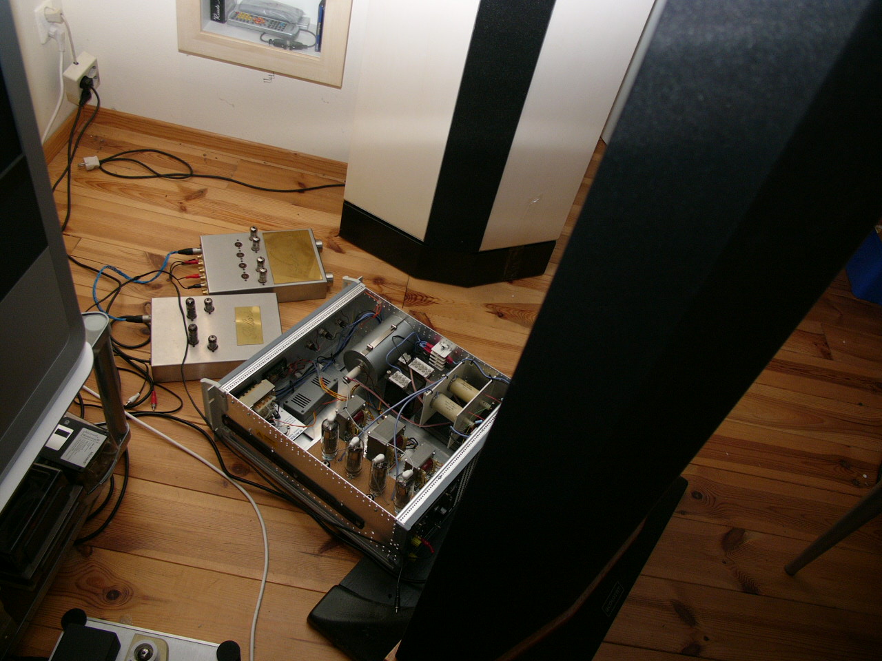

I own 2 sets of the Beweridge loudspeakers and one set needs new stators. I also use Acoustat Monitor 4 with direct drive amps (rebuild by myself). These can play exceptional loud and have no problems in the bass region (subsonic).

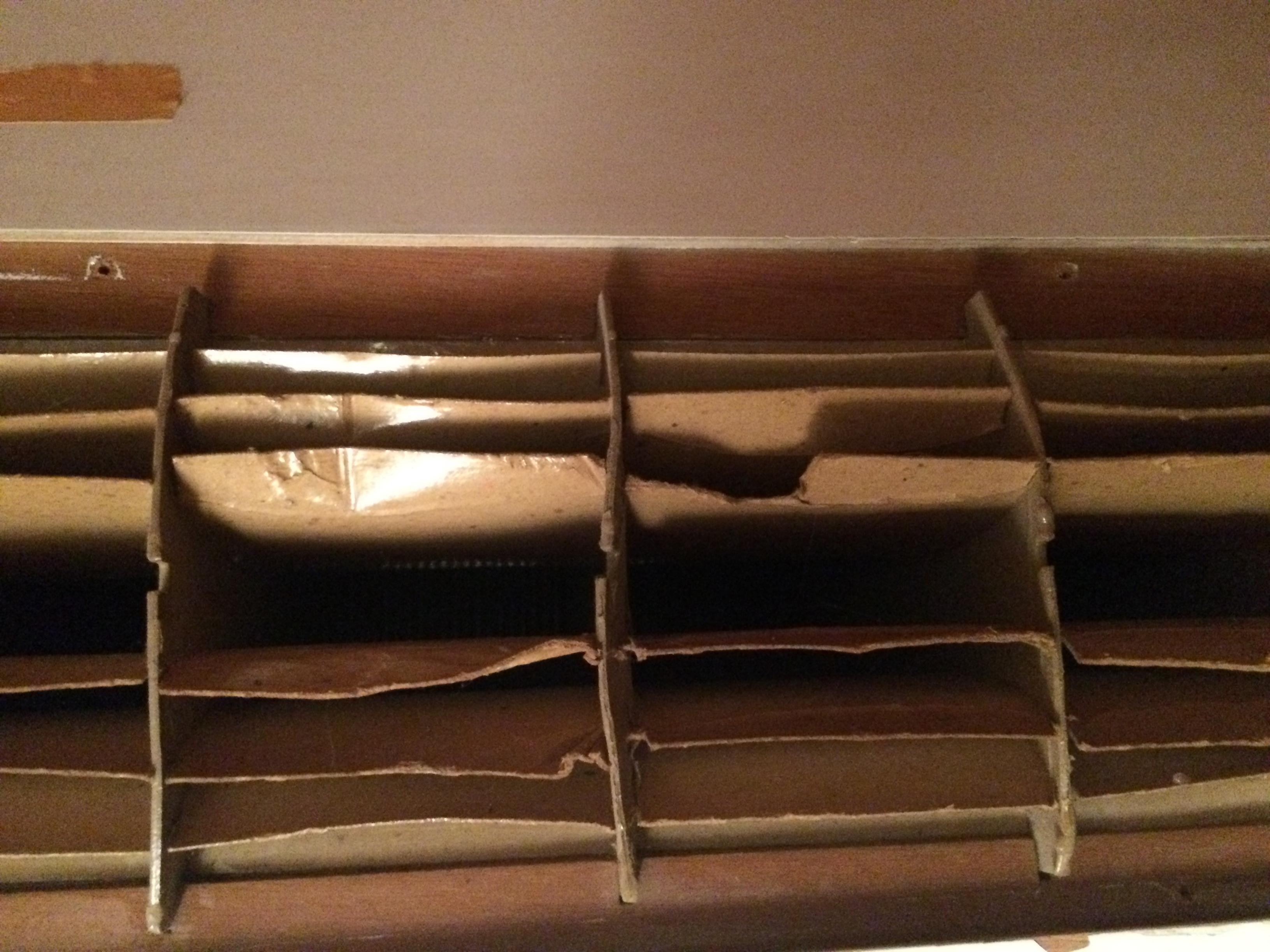

The lenses on the Beveridge are made of cardboard and also need some repair.
Do you have any tricks on how to rebuild the lenses?
Best regards, Frank

Thanks for the swift reply!
The lenses are bent and warped a bit (picture attached). I would like to replace the lenses with new ones using some plastic sheet or so.
Any help is appreciated!
Best regards, Frank
Hello Frank, I took a careful look at your photo and it reminded me of the last time I saw a new model 5 at an audio show (1980"s). The lenses were warped even when brand new and the workmanship was sloppy. The speakers built by Beveridge before he sold the company were carefully made and the lenses did not warp because his material was different or maybe thicker. Using very thin cardboard causes the edges to warp no matter what you do to straighten them out. I found that out when I built experimental lenses out of 1/16"(1.6mm) thick cardboard. The only corrective solution which finally worked was to reinforce them with strips of thicker cardboard glued to the edges of the lens. This does change the terminal configuration of the lens (makes it thicker and with an abrupt transition) but I did not see any significant frequency aberations when measuring the result with pink noise and 1/3 octave realtime analysis. Nevertheless, this still led me to believe that cardboard may not be ideal for making lenses with the extreme curvature that the Beveridge design calls for. Some sort of flexible plastic may work better but I think the real solution is to design and build the lens in a 3D computer. However, before taking that expensive step, I would suggest you try gluing on some 1/4" strips of cardboard to the terminal part of the lens to see if that reinforces it enough. I used very small clamps to hold the pieces together while the glue dried but paper clips would possibly work. I put the reinforcing strips on the side with the widest opening. Good luck and best wishes,
Ted
You could also try taping and/or gluing straightened music wire to the edge of the cardboard. That would likely give you plenty of holding power without changing the lens geometry to a significant degree. Most hobby shops have 3 foot lengths of music wire in various diameters.
If you want to fabricate a plastic lens, thin polycarbonate is pretty friendly to work with: cuts, drills, taps relatively easily. Not easy to thermoform though.
ABS is much easier to form with heat, but isn't as tough overall.
A 3D printed lens would likely be quite expensive from a commercial printer. Thin, large structures have a tendency to warp when printed also, so I'd start with some smaller test prints before trying a full unit. Some stereolithograpy materials get brittle over time also, so careful material selection is required.
A bit of speculation about the original lens material: one benefit the cardboard likely had is better damping than plastics. They may have been using a limp cardboard to limit resonances in the lens structure. That could lead to a propensity to deform, but better overall sound.

I also found that the shape does not effect the overall sound quality of the speakers but we all it like it to be more or less "perfect" (it eases our minds ha ha).
I could use some steam to reshape the cardboard and fix it as mentioned by you. I will try this at the upper ends of the speaker first.

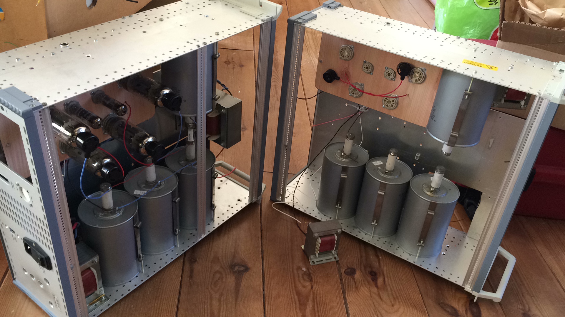

What knd of stators did you use for you new ESL's? Is it wires or metal plate (like ML)?
I would like to use one set full range (no subs) as it was original this way. The other is slightly different (has a wider lens opening as it has subs).
The full range speakers are still working and have the metal frame stators as the other has plastic frames (these need to be replaced or refurbished) Full range is not required for this set.
