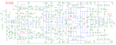

Hello Edmond,
>> But, as with any change, I have to simulate all loops all over again (a lot of work!), in particular the clamping loops. Probably some changes will be needed.
When you refer to loops do you mean every loop in the amp literally. Sorry if it seems like a stupid question, but you have a lot of compensation I dont normally see in other circuits which implies a more thorough stability analysis like testing all the loops to see if they are stable and eliminate parasitic oscillations.
Regards
Arthur
Hi Arthur,
Indeed, I mean every loop. Most of them I've already simmed separately, but if you put the latest modification all together, much chance that I will overlook something. Right now, this happened already with the over-current clamp: Ib of the pre-drivers becomes too high when the protection kicks in.
E.

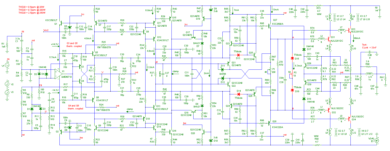

Hi Mogens,
Not exactly. I've added a (light) TMCed shunt compensation to the VAS output (C26, C28, C29, C30, R45 & R46) and the PSU for the op-amp (Q1, Q2, Q19 & Q20).
(BJT-bias version coming soon)
E.
  • PHOENIX13.CIR.txt
    PHOENIX13.CIR.txt
Phoenix13

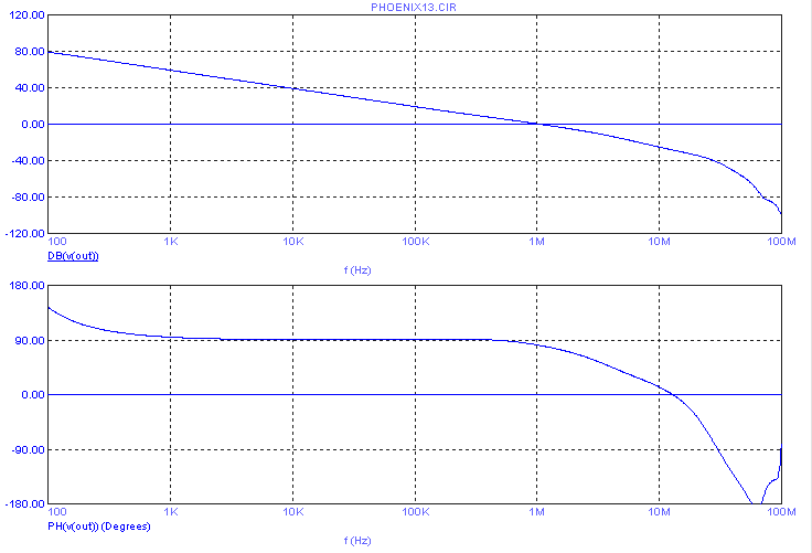

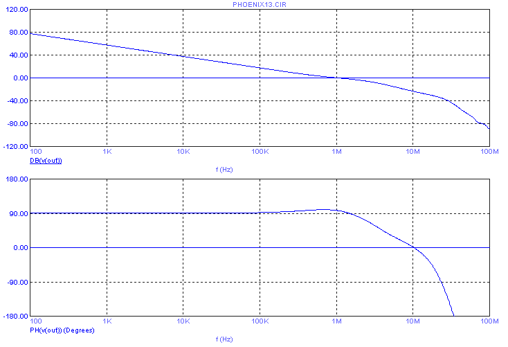

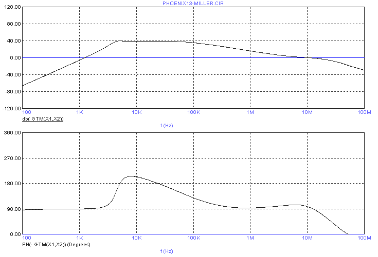

Below some loop responses.
1st pic: global NFB loop at R7
2nd pic: CFB loop at R26 (global NFB loop disabled)
3rd pic: local Miller loop at C20 respectively C21 (other loops disabled)
Notice that the phase margin of all these loops are close to 90 degrees (as it ought to be).
E.
edit: I've doubled the values of the shunt compensation caps: C26=C28=47pF & C29=C30=220pF.

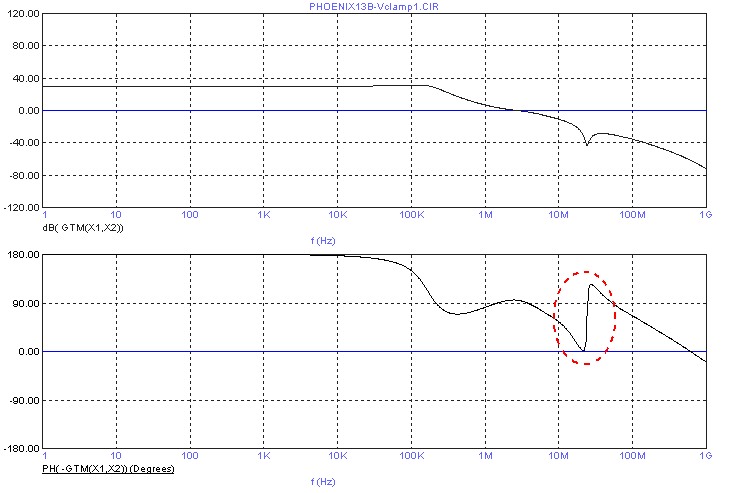

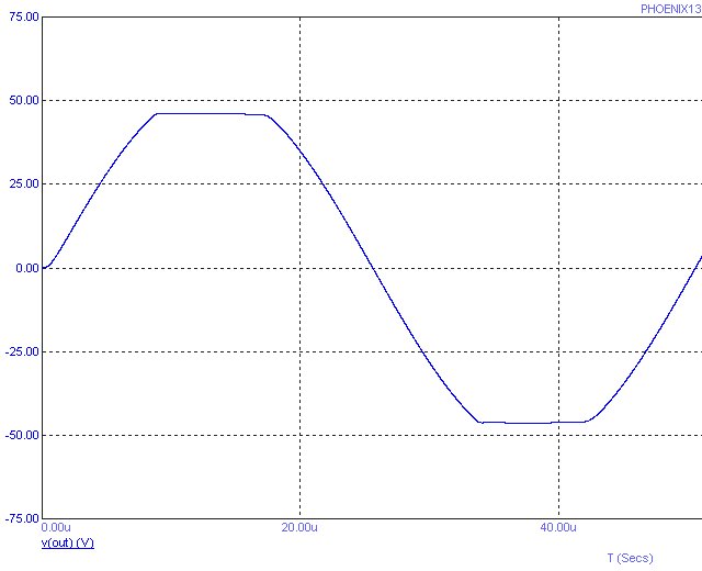

Clipping
Hi Arthur,
I had issues with the TT-version, i.e. Phoenix13.
But I managed to circumvent the convergence problems by simplifying the circuit a bit:
using a constant bias voltage, fixed +/- 15v PSU and a simplified op-amp model.
It appeared that the phase margin of the voltage clamp was too low: only 35 degrees.
However, after a subtle modification of the frequency compensation, it's much, much better: 110 degrees! 🙂 See 1st pic.
The only thing I don't like is an ugly phase transition at 25MHz, though I'm not sure if it's harmful anyhow.
BTW, the new frequency compensation is really new and exciting. So I like to investigate this one further (and find the cause of the ugly phase transition).
The 2nd pic shows the output at Vi = 2Vpk & f=20kHz. Impeccable for a NDFL amp, I would say. 😀
E.
