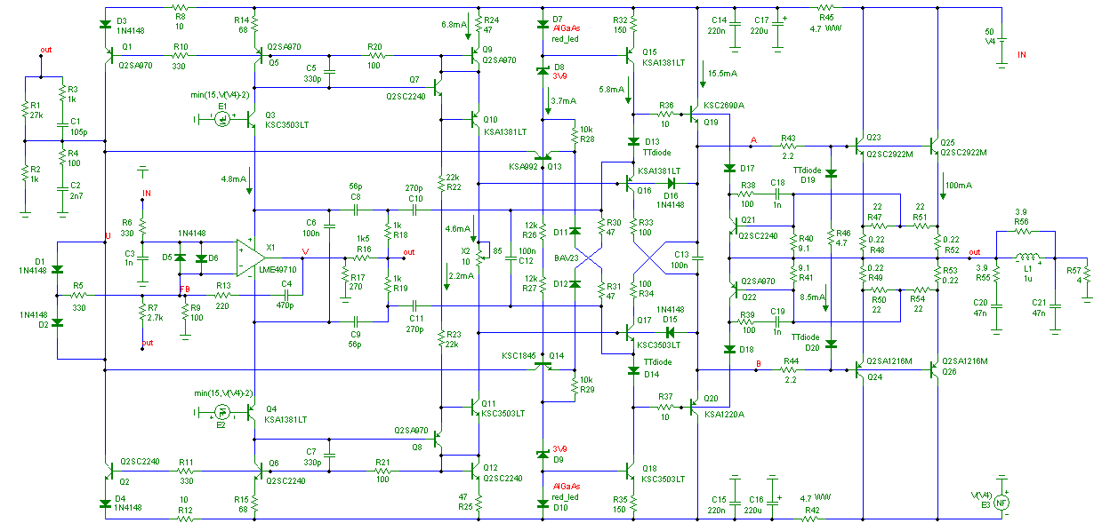

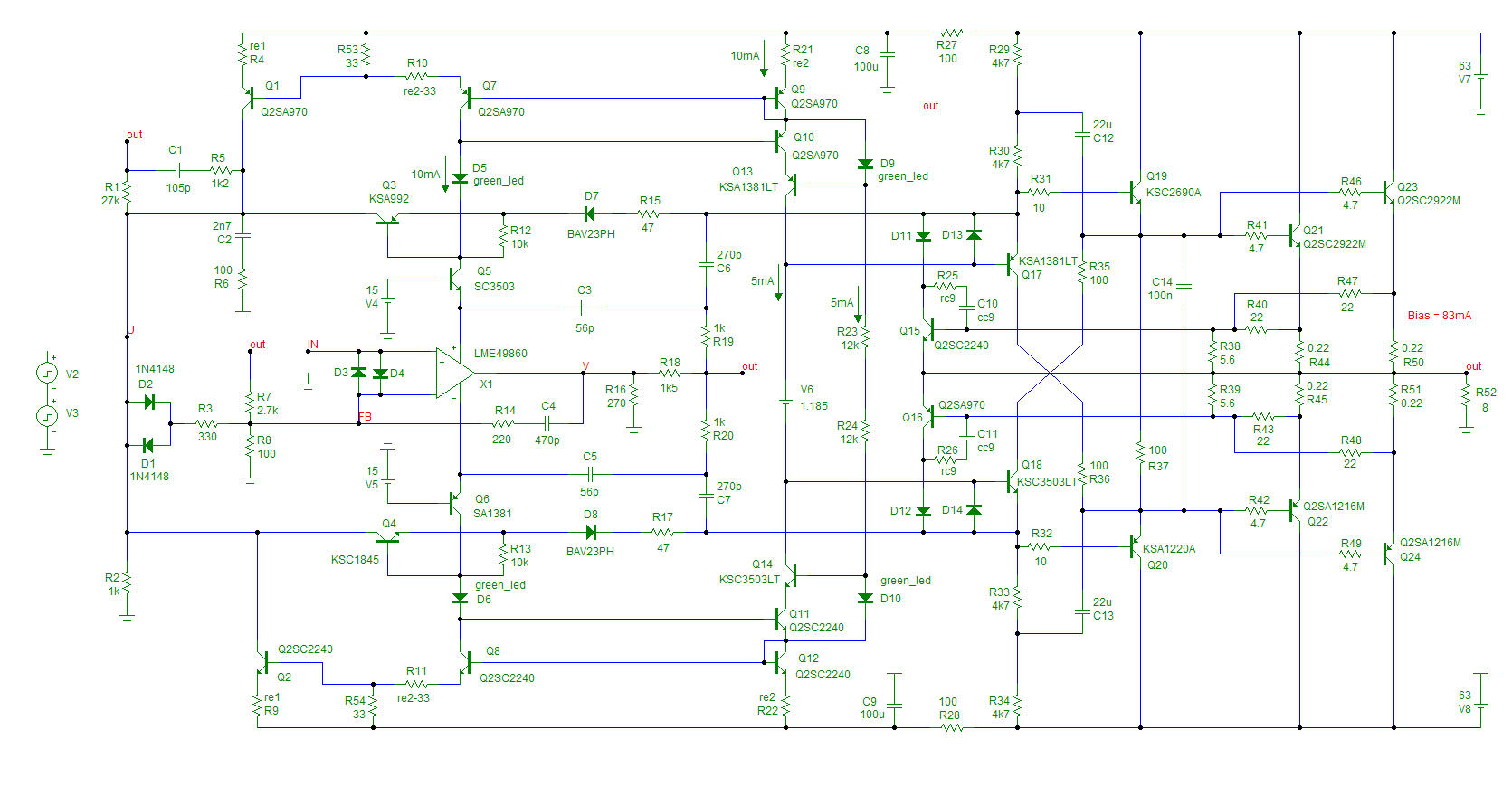

Phoenix7
Hi Arthur,
Here's the new version. Regrettably I don't have correct models of TT-trannies NJL4281/4302 (though I do have models of the TT-diodes). So for the moment, I'm still using the Sanken models.
Please have careful look, in particular at D19 and D20. This clever configuration (courtesy of Bob Cordell) greatly reduces cross-conducting during fast transients.
Don't hesitate to put your questions (probably many 😉 ).
E.
PS: TDH20k is about 1ppm.
Q16 & Q19, respectively Q17 & Q20 are thermally coupled.
More on D19 & D20. This is what Bob Cordell said about it:
"The two “extra” ThermalTrak diodes, D3-4, are used between the emitters of the driver transistors to establish the idle current of the drivers while keeping the impedance between the emitters very small, so that the drivers can operate in push-pull to provide turn-on and turn-off current to the output transistors. Keeping the impedance between the driver emitters very low at high frequencies is essentially what is often done with the speedup capacitor. The ThermalTrak diodes make it possible to do this in a d.c. fashion with the necessary precision because they track the output transistor Vbe’s. "
See also: http://www.diyaudio.com/forums/soli...ion-thermal-trak-transistors.html#post1264875
I would highly recommend this scheme.
And below a compilation of some comments, graphs and schematics about the ThermalTrak trannies and diodes.
E.

Version 8
Hi Arthur,
the project experiences some delay as I'm busy with a new version. This one has improved current mirrors: lower distortion and (slightly) more output swing, only 2V below the supply rails. It's also based on a Wilson current mirror, tough combined with another trick of Hawksford instead of his cascode. See his AES paper: "Reduction of Transistor Slope Impedance Dependent Distortion in Large-Signal Amplifiers", p.217, Fig. 5b.
Furthermore, the circuit is slightly less complex: the green LEDs are gone.
E.
Hi Arthur,
Here's version 8, together with a MC9 file.
The following changes are:
1. Better and simpler current mirrors (Q7 & Q8).
2. Miller compensation of the 'Wilson loop' (C5 & R20, C7 & R21)
3. Different protection of the current mirrors (Q1 & Q2)
4. Constant current sources for the diamond driver (Q15 & Q18)
5. D11 & D12 crosswise connected to Q16 & Q17.
6. Added input filter and supply rails filters.
7. Added Zobel network
THD = 1.4ppm @ 20kHz, 200W into 4 Ohms, BW = 100kHz.
If OPS protection disabled: THD20 = 1.1ppm
If OPS protection disabled and ideal op-amp: THD20 = 0.4ppm
To do : plus & minus 15V PSU
E.

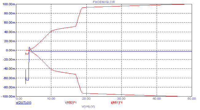

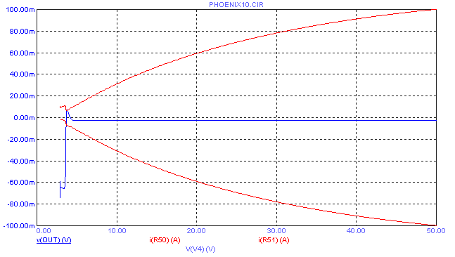

biasing the output stage
Hi Arthur,
At first glance, biasing the output stage with ThermalTrack trannies and diodes (1st pic below, D7 & D8) looks very promising. However, I encountered a few problems:
If the diamond driver gets its supply current as shown here (by means of R23...R26, C8 & C9), the bias current depends on the supply voltage, see 2nd pic below. I assume you don't like this (unless you are using a regulated PSU, of course). So I've replaced above passive components by constant current sources (Q13 & Q14) and current mirrors (Q17 & Q19, resp. Q18 & Q22). Now the bias current is far more constant, at least above 19V, see 3rd pic.
So far so good. BUT... these sims are based on models of the Sanken O/P trannies, as I don't have them of the NLJ4281D/4302D pair*. Using similar device models, i.e. of NJL1302D/3281D**, reveals another problem, see next post.
edit: * I don't thrust MODPEX cr@p: VAF=10. Crazy!!!
** These models are also from above idiot, but modified/improved by Andy. Hope they are sufficiently reliable.

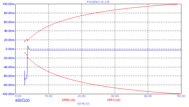

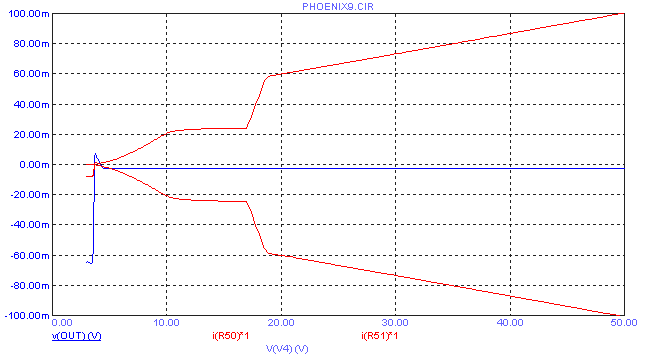

Above problem, i.e. bias dependence on supply voltage, reappears when using NJL1302D/3281D models, see 1st pic. One of the reasons might be that these trannies have a much lower Early voltage, at least according the models: 38 resp. 40V. But how real are these figures? And equally important, where to get reliable models?
Now that it seems impossible to keep the bias setting constant at varying supply voltages, I wonder whether it's worth to spend another 6 trannies for the CCSes and CMs.
So, let's also have a look at the bias variation of the previous and simpler circuit (based on four Rs and two Cs), see 2nd pic. As we can see, the variation is higher, of course, but not that much: 'only' 50%. So what to do, as none of the circuits is perfect. Should we take this dependence for granted?
Now it's your turn Arthur, please.
One more thing about fine tuning of the bias. Since the TT trannies have a lower Vbe than the Sanken counter parts, I had to connect the bases of the diamond driver crosswise to the trim pot, see jumpers.
E.
  • PHOENIX9.CIR.txt
    PHOENIX9.CIR.txt

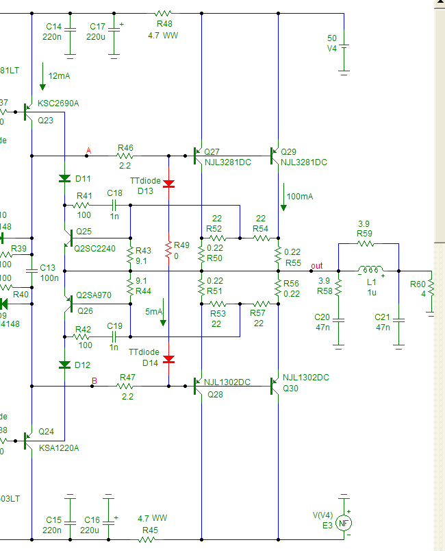

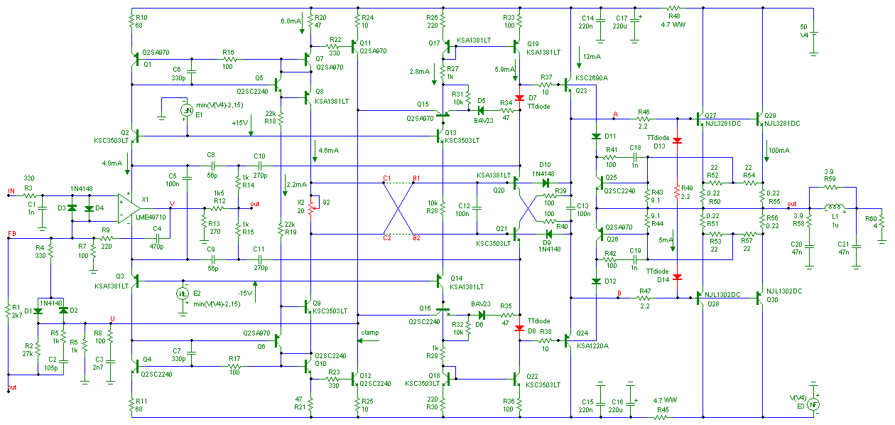

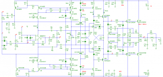

Pheonix9 question about schematic
Hello Edmond
On Phoenix9 there seems to be a mistake in the way the output stage is wired specifically Q27 and Q29 . Attached is what I mean , is this just a quirk with conversion from MC10 to MC9.
Regards
Arthur
