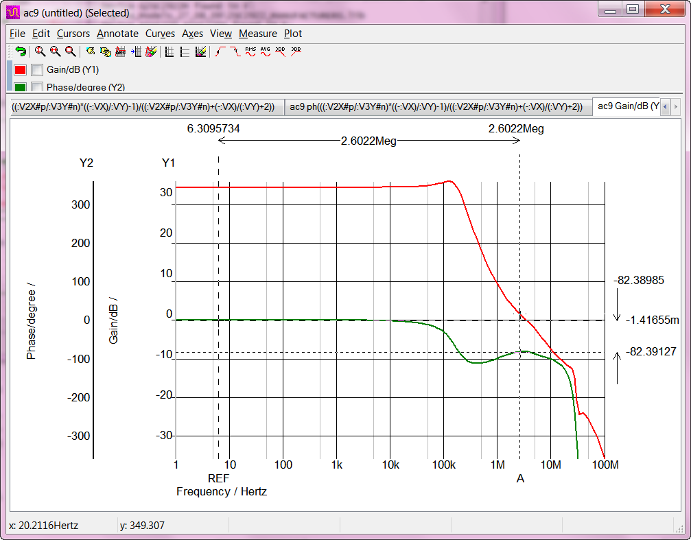

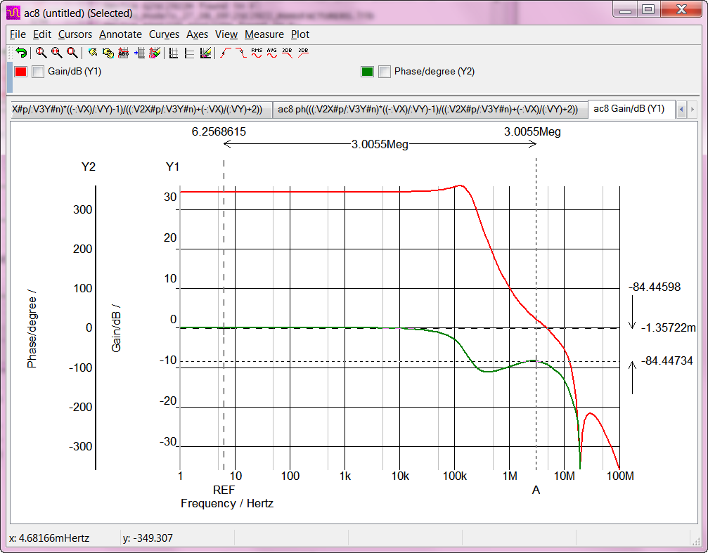

Hello Edmond
The first graph is with -2V input 4R load PM 94 degrees @3Mhz and at 2V input 4R load PM 97 degrees @2.6MHz.
Our results are closer to one another now. Interestingly when I go to sim with an 8 ohm load the output goes hard negative -46V at the output independent of input voltage, but the simulator does not say its a convergence issue.
Regards
Arthur

Are they 22r base stoppers on the outputs and yet, only 10r on the drivers?
Why did you choose that high?
Hello Andrew
I know I made a comment about this before but , these values where work in progress and I have finally settled on 22R base stopper and 100R on drivers , and this is to tame parasitics on ouput stage.
What I find with BJT ouput devices is that there is quiet a bit of component spread and the resistor values I am using are to accomodate this spread , some output devices work just fine with lower values but some have low level oscillations that need higher values to tame behaviour.
Regards
Arthur
