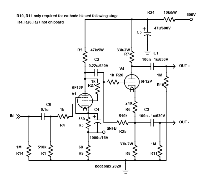

I keep my grid leaks low in general - why I used direct coupled k-follower drivers on my big amp. I knew I was going to want to beat on it.
Horizontal sweeps are probably more prone to runaway than verticals, as the latter runs as a linear amplifier. Less total emission capability, too. No one needed 1 amp peak currents in the vertical sweep circuit. And runaway has a lot to do with quality, too. Back on the 7868s, old Sylvanias were still “working” but the cracked glass and almost exhausted getter were worrisome. Replacement Sylvania/PHILIPS were catastrophic. Despite perfectly matched cathode current initially (put in 10 ohm resistors to check). Every time Philips acquired something (Magnavox, Westinghouse lighting division, Advance ballasts) the quality seemed to go to hell in a handbasket. I figured it was part of the pattern. Everybody does that cost cutting crap today, but this was 35 years ago. ECG transistors have always been known to blow up, but a lot of it was just poor replacement suitability - they would often sub a switching type for a linear amp in their cross reference because it’s just based on superficial maximum ratings. That NEVER works, Philips or no Philips. Me and my old college buddy still Philips-bash today. Although my Sonicare still works as well as it did decades ago. I’ve acquired many Sylvania/Philips 21LG6’s and 26LW6’s, and a scattering of others and we’ll eventually see how those work out. At those prices it matters not. Nothing ventured, nothing gained. But if I keep G1 resistance low and Vg2 reasonable, they’ve got a chance.
Ya for sweeps, I tend to aim for 100k. KT88 max is 51k I think.
I find 330k is ok for most Soviet tubes though.
I use the following poles.
First gain to splitter = 0.22u/510k
Spiltter to driver 1uF/510k
Driver to power tube 1uF/100k
This gives me a stable amplifier without "breathing" or "motorboating".

Add a bias servo and you have *four* poles. Transformer makes five. You can direct couple the first two stages and eliminate one.
I was looking at two direct coupled LTPs driving a pair of 10JA5 (7591-like curves and lotsa gain) to see just how much global NFB I can muster, while keeping only two low frequency poles. One driver stage would be *enough* to get distortion below 1% with 6 -10 dB of feedback but where’s the challenge in that?
It might be hard to keep the OP and gain the same with DC coupling though... C6 is 0.22 and makes the second half of a 2nd order input filter. OUT+ and OUT- go to 6SN7 type driver stages which sit between this and the output tubes.

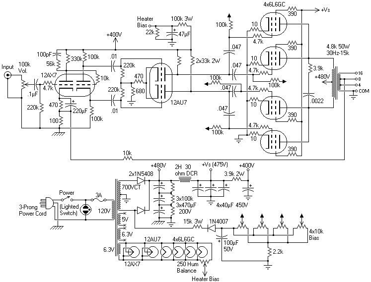

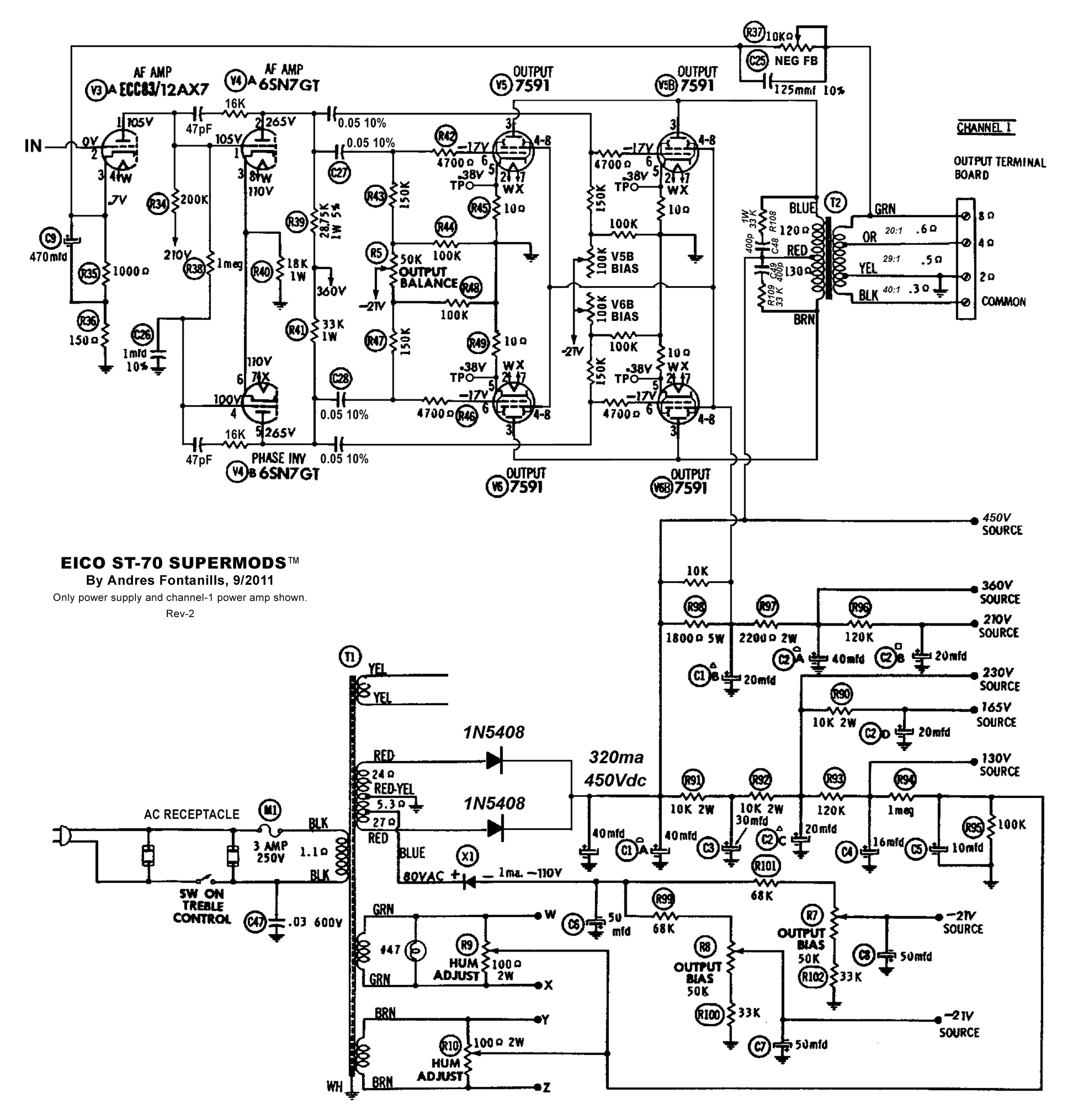

Could 7591's were used in place of 6L6's in the circuit below w/ no changes? 7591 spec sheet seems comparable to 6L6. Notice OT impedance is about 1/2 of non-quad PP.
The 'hot rod' ST70 mod article uses 1/2 the secondary load so the primary impedance is effectively 1/2- but wouldn't it be better to use OT's with 1/2 pri impedance to start with? Maybe cost was the reason. Would the high DCR values of original ST-70 OT's be a limiter on plate currents in quad design?
Jim
Jim

6L6 all variations:
Transconductance ~ 6,000 uMhos
u, g1 to g2 ~ 8
Maximum Plate dissipation 19 or 30 Watts, depending on the variation.
7591 all variations:
Transconductance ~ 10,000 uMhos
u, g1 to G2 ~ 17
Maximum Plate dissipation 19 Watts
The tubes are not nearly the same.
Yes, change some voltages, resistors, and output transformer primary circuit values, or put up with less than optimum performance.
Original 35 Watt transformers will saturate at low frequencies when used at 40, 60, or 75 Watts; Right?
Global negative feedback resistors and compensation capacitors will have to be adjusted when different output transformers are used.
Just my $2 opinion

The 6L6, 5881, 6V6, KT66, KT77, 6550, and KT88 all use the same base connections.
The 7591 has a different base pinout connection diagram.
Do not make the same mistake I made once, I forgot, so I wired the 7591 connections as if it was a 6L6, 5881, 6V6, KT66, KT77, 6550, or KT88.
My bad. Live and learn.
I turned it off just in time to save the 7591 and surrounding circuit.

Dropping the 7591 into the Williamson amp would let you eliminate the differential driver stage - split load inverter would be enough.
The "super" ST-70's output transformer would saturate at the same voltage as in a normal ST-70 - which would be twice the power. Yes, a transformer designed for PPP use would perform better, but doubling up the outputs just requires some available time and a chassis punch...
21HB5A gives you the same gm as the 7591 (10200)
(at the same plate current), with 2.7x the current capability (so you can use a lower primary Z OT, like 3.3K or 4K, and lower B+). As long as you are not using UL. Ie, as in the above schematics listed by Oemcar. These used to be $1, but are still relatively cheap. Plate size is the same as most 24 Watt TV Sweeps, and with NO plate cap.
How about the 17GT5?
That's a little lower gm than the 7591. 6573 gm at 60 mA versus 10200 gm for the 7591 at 60 mA.
35LR6 will get you 10500 gm at 60 mA, but it's a rather bigger 30 Watt Sweep tube, with a plate cap.
Two 21HB5A in parallel gives you an 8417 ( with more than twice the current capability and 1/4 the Rp, using half the Vg2, 1/2 the knee Volts for better efficiency, and better triode curves, for $2 a few years ago.)
