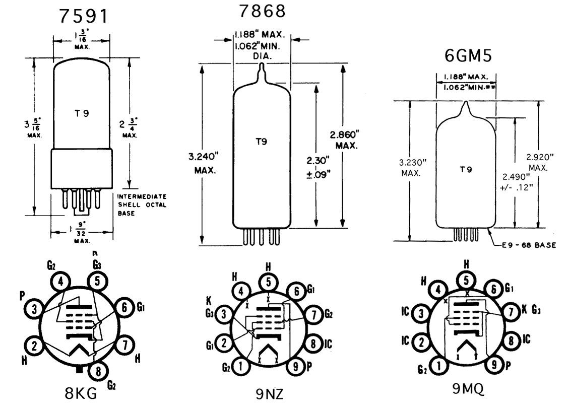

I cringe whenever I see the 7868 mentioned. The newer version are expensive and last only a few hours in my Fisher receiver (which mostly sits on a shelf unused.)

If you reduce the screen voltage down to 125V, you could use the 6JA5 Vertical Amp tube, with a socket change.
$8
and better curves besides.
For more than 400V B+, there is the 12/6GE5 12/6JN6. Socket change. 125V screens.
$6 and fairly good curves too, lower gm. A 21HB5 would get the same gm as 7868 at 60 mA.
No UL/ Ultralinear mode with these however. These all use higher heater current than the 7868.
The 6P41S tube has the same base connection as the 7868 (slightly higher heating consumption) and can be used in the triode and UL connection up to Ub ~ 350-360V, and in the pentode up to Ua ~ 550V (I tried it up to Ua ~ 600-620V! ) if Ug2 is limited to ~ 150-175V (usually less than ~ 200V, or best stabilized).
Geometrically, the size of the plate of the 6P41S tube is approximately equal to that of the tube 7868, so the factory data on the maximum plate dissipation of Pa = 14W can be considered very conservative, ie that it refers to the permanent load in the vertical deflection of the TV.
The need for a slightly higher negative bias voltage for the 6P41s may require a different design of the negative voltage rectifier itself (perhaps a doubler?), as well as a new setting of the quiescent current goes without saying.

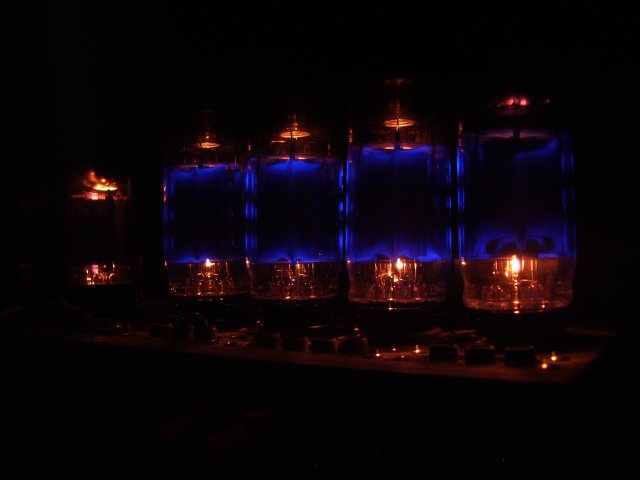

It probably is the glass - I don’t see much if any cobalt fluorescence in the modern New Sensor types and the old Sylvanias used to be “blue-tiful”. Takes a hard vacuum and cobalt in the glass to do that.
I don't think the New Sensor tubes are that bad.

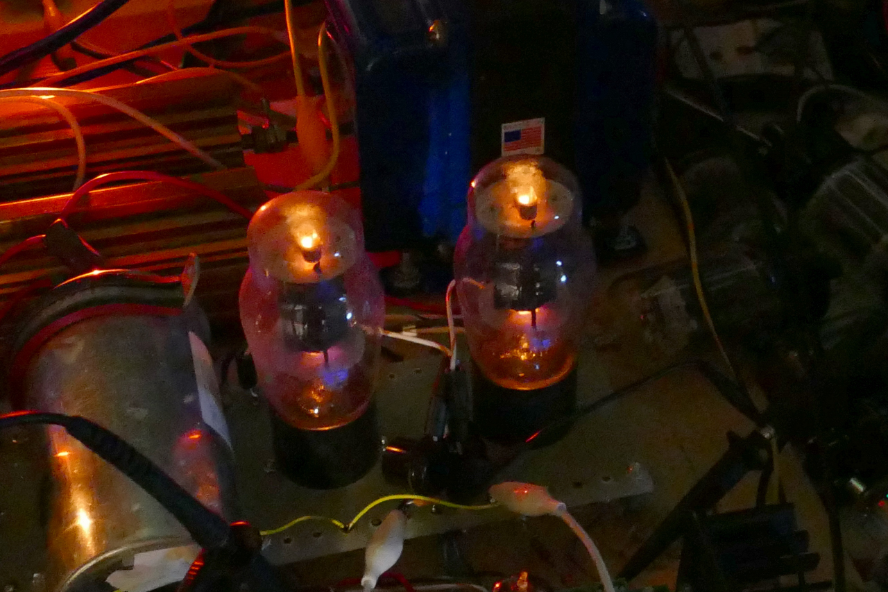

These are EH tubes in the back of my Fisher amp. Plenty of blue glow. The amp is currently running the New Sensor Tung-Sol tubes and seems to be working fine.
The big problem with the Fisher amp was the common cathode resistor for all four output tubes. It requires well-matched tubes which must stay well-matched for their entire life. In practice it led to eventual inevitable red-plating of one of the tubes. Poor design shortcut. I fixed it in my amp.

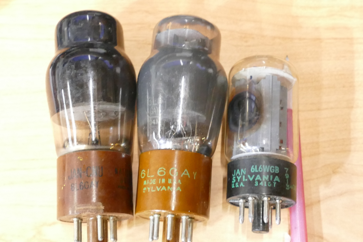

Micanol is the name of the low-loss yellow-brown tube bases. Y was added to the suffix of most tubes that used it. So a 6L6GC with micanol base would be a 6L6GCY. (I don't know if they were ever made.) Ceramic was also used in low-loss tube bases, normal suffix X. Both absorb less moisture than Bakelite, so were prefered in high humidity areas like the south pacific in WWII.
I don't ever remember seeing a 6L6GCY, but I did find some 6L6GAY's in my collection. I also found one of these oddities. It is a JAN (Joint Army Navy spec) 6L6WGB, except these have the guts of a 7027A stuffed inside. I had a bunch, but they went into guitar amps because they could be abused without fireworks.
After WWII there were lots of companies making 6L6 types with differing internals. There were some 6BG6GA's and even some 807's with these guts inside. 20+ years ago I helped clean out a warehouse full of post WWII military scrap in exchange for all the tubes, probably about 200,000 loose tubes, about half were broken or corroded beyond use. I saw "807's" and "1625's" with nearly every 6L6 variant stuffed inside, including a lot without the typical RF shielding below the internal structure. I kept the usable stuff, but sold or gave away most of it over the years.

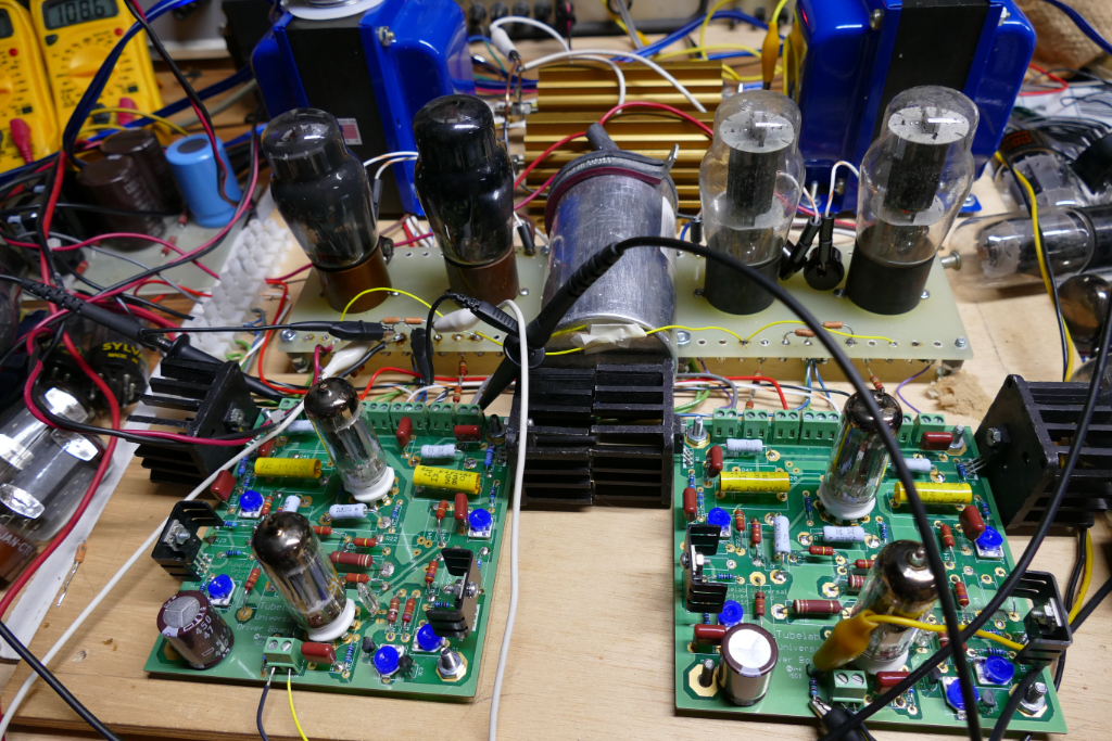

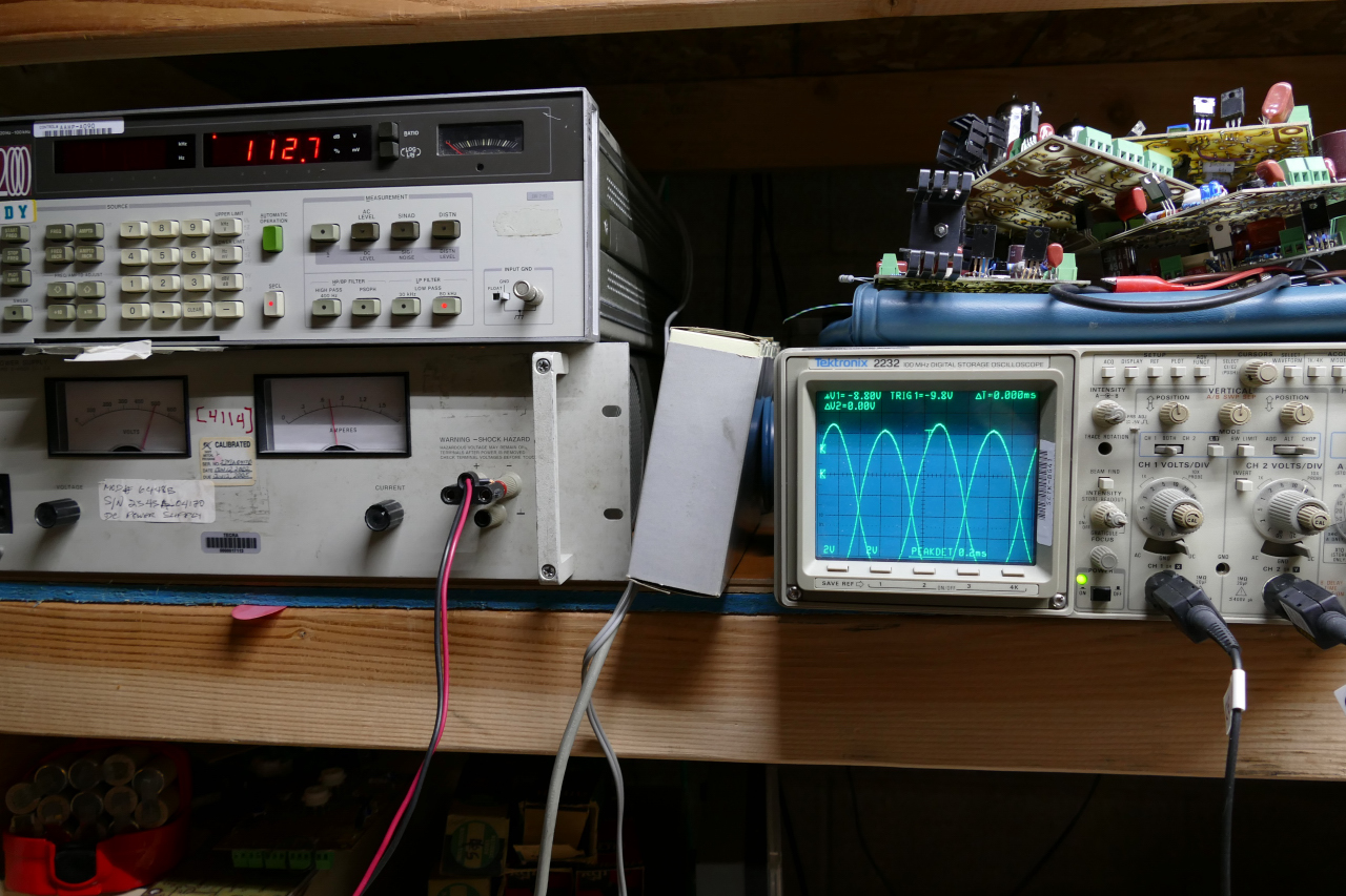

Some of the old 6L6's and 6L6GA's have been used for "testing." Yes, you can get 110 watts of clean audio power from a pair of vintage 6L6GA's without red glow or blown tubes in a breadboarded stereo test amp. The plate supply was 520 volts, screens at 300 volts, load 3300 ohms in AB2. They sound nice in this configuration too. Just don't try to make 125 watts. A tube arc will occur blowing the 2 watt cathode resistors, not once, but twice. All tubes are still good, only the resistors blew.
I have a (small) old AB2 amp with precisely the above conditions & can't get anywhere close to 110W clean, I get roughly 78W RMS.you can get 110 watts of clean audio power from a pair of vintage 6L6GA's without red glow or blown tubes in a breadboarded stereo test amp. The plate supply was 520 volts, screens at 300 volts, load 3300 ohms in AB2.
Anything over that is pretty ragged.
Screen is stabilised at 320V, OPV is matched 807s and anode supply is 580V.
(High levels of odd harmonic distortion have to be tamed with NFB)
The other amps I have run 835V on the anode, and are claimed to make 125W, but dirty, so I change them from pairs to matched quads.
PPP using 4 matched 7591 in AB1 can beat the 807 AB2 amps quite easily, doesn't produce anything like the levels of THD or IMD thrown out by 6L6 or 807, and needs less than half the drive, as well as much lower HT. The 7591 wins by being so small, although the STC 5B25x series can beat the old US 6L6 easy, as well as the much much better 5933 mil spec.

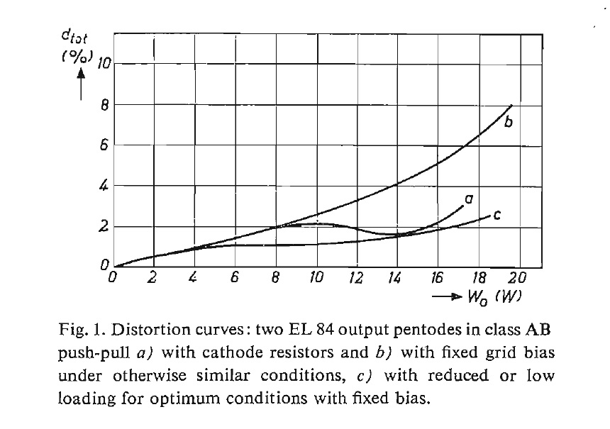

Cathode bias = easy, which would make sense if trying to really simplify things. But in those old tube receivers, I don’t see why they didn’t just add another winding to an already big power trafo, to make a -15 to 20 volt bias supply. When I make a transformer, it’s just as easy to add the bias winding and make better use of the tubes.
Cathode bias = high distortion/low power output/poor performance.
Since class B is not possible with cathode bias, fixed bias is needed for higher output power. But compared at equal power output, these curves for the EL84 show that distortion is higher with fixed bias than with cathode bias (unless you would use 'low loading" but that has some drawbacks).
Probably because for a low power design nobody want to rebias it for drifting/worn tubes every month (Yes, I've found that in 24/7 operation, bias adjustments are welcome each month). Not hard and doesn't take long but not everyone can / want to do it. Resistors compensate for worn tubes.
Now that automatic grid bias is a thing, the only reason to use cathode biasing is cost (and simplicity).
A few mA of imbalance, using fixed bias, non-excessive G1 resistance, and EI output transformers isn’t the end of the world, either. They get far enough out of balance and it’s time for a new pair of shoes anyway. If you’re keeping something in tip-top condition, you’re going to build it with 20 turn bias pots or use a servo. I *thought* about a bias servo on my big Williamson, but decided not to add yet still another low frequency pole. I bought about 200 20 turn bias pots surplus, for 63 cents each. Don’t think I’m going to run out any time soon.
