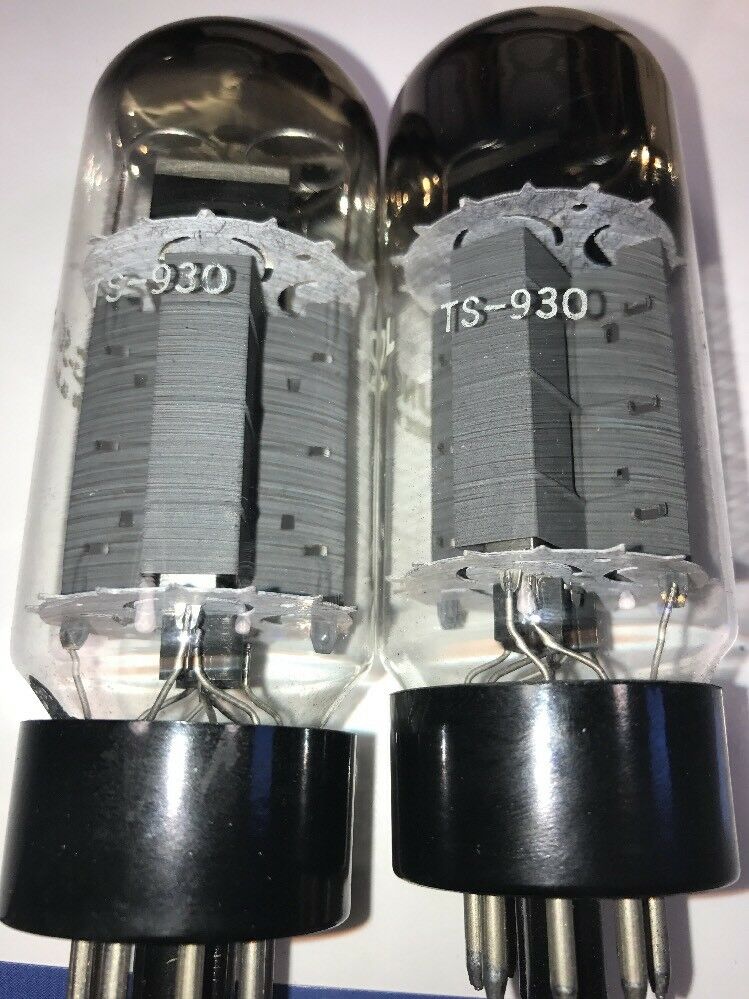

Two 21HB5A in parallel gives you an 8417
sorry the transconductance of the *HB5 doesn't come even close to the 8417, although clearly the anode structure looks pretty similar. (9100mhos).
Even semi dead 8417 hit around 18,000, and proper new condition ones are up right up there around 22000-24000.
I used the rare and expensive Toshiba xG-Bx as a substitute which seems to manage KT88 levels of HT and Pa (I get them to do 43W with no sign of red).
No worries at 700V and I reckon they can take more, despite it being totally undocumented in the Jap language docs.
Sadly if you use the Tosh tube in one channel of my "heavy metal" monoblocs compared with my other channel using Sylv 8417, there's a quite a significant difference in gain.
There are 2 types of glass envelope, one of them being pretty tall so that can cause space issues.
Then, when you use the OPT as cathode feedback (CT secondaries is great!), you need all the gain you can get, cos it doubles drive requirements.
In those amps, even a quad of 7591 would not cut it, (the amp was made for PPP using 8 x 8417!).
Having said that, there's something about those old "westy" US designed valves, that adds some magic to the sound, and I am not alone in saying so.
Curves from the manufacturer are not everything, something in the linearity department happens to make them have that peculiarly likeable sound signature....
(and I can listen to mine for hours and hours with zero listener fatigue!) 🙂

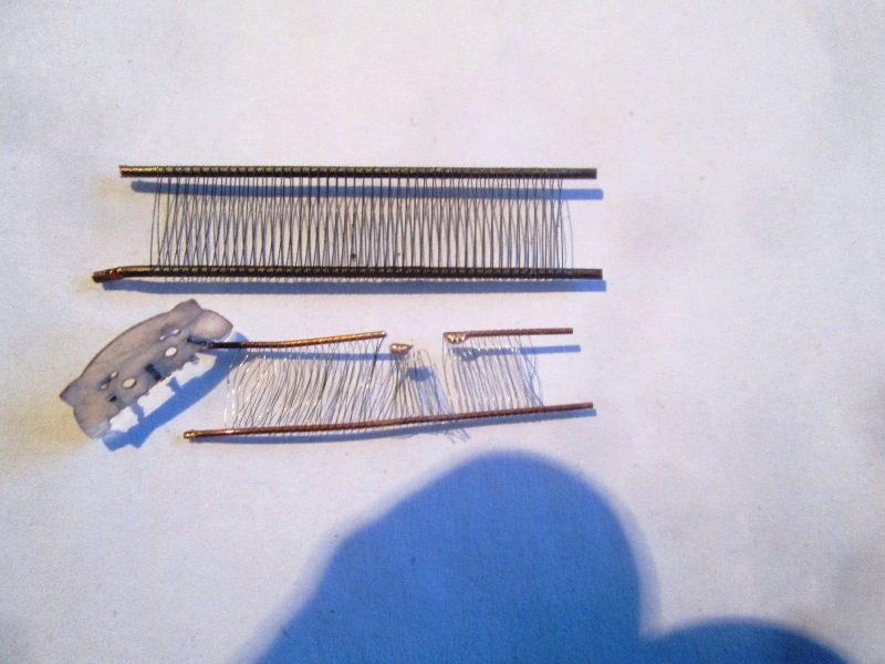

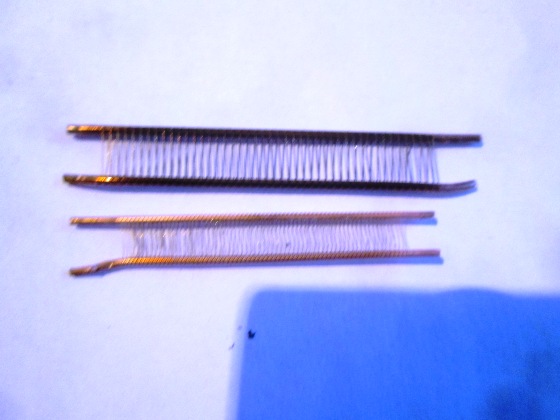

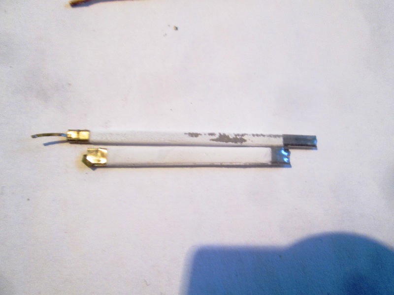

I have "dis-assembled" a Sylvania 10JA5 and a 12GE5 tube to see what is different between them, since they look alike.
The 10JA5 was of interest since it is a Vertical Sweep tube with curves similar to the 7591 to some extent. The 12GE5 is a Horiz. Sweep tube with efficient lower knee voltages. Vertical Sweep tubes need to be linear for their job. Horiz. sweeps not necessarily, they run as switches.
These two tubes were virtually identical inside except for a few small differences. The heater power of the 10/6JA5 is lower than the 12GE5. 1.0 Amp for 6JA5 versus 1.2 Amp for 6GE5. (0.8 Amp for 7591) And the cathode coating was 1/8 inch shorter for the 10JA5, although the cathode sleeve for both was identical size. The grids were all identical, except the 10JA5 grid1 was very slightly rounded out away from the cathode, while the 12GE5 has a perfectly flat grid1. Cathodes were flat. Plates were identical except the 10JA5 had notches running along near the seams. Grid 2 for both were identical pitch and wire aligned with grid 1. Grid 2 was flat for both tubes.
So apparently the 10/6JA5 does some gm modification across the surface to get the smoother curves it has.
The 10JA5 has a low voltage screen grid versus the 7591, so is not a quick and easy substitute.
It looks like the JJ KT77 may be doing a similar feat for curve modification. So that may be a similar sound substitute for the 7591, if the higher heater power ( 1.4 Amp at 6.3V) can be accommodated. As well as greater height due to being a bigger Wattage tube. And different pin-out.
By the way, the curve modification done to the 10/6JA5 makes for poorer triode curves than the 12GE5. Win some, loose some, trade-offs.
One smart thing about the 10JA5, you set up a stout 40V DC power supply for the heaters (38-42V will do) 1 x 24V winding + 1 x 6.3V winding + rects, and it sets you up a perfect stable multi tapped bias supply in 10.7V steps, 42, 31, 20.5 (CT)....to which you can chain any small pot to set up the -g1 bias.
I notice a number of 60s valve amps used this arrangement with great success.
