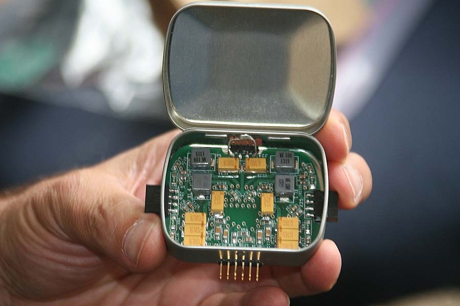

OK, so I've been playing with the PCB editor for a bit today... My wrist hurts now.
Ditching the terminals in favor of 100th pin headers means the current ferrite bead design can reduce to 1 inch square. For the same size as it is currently, I have redesigned the board with LC output filters.
Would it be worth building both? I can't really imagine who would need a square inch amp so I may switch entirely to inductors.
Mine is not as small.
Inductors used.
3116 and bootstrap caps on bottom of board.

That looks pretty slick Doug. Out of interest, what made you decide to use Tantalums? I'm aware of the electrical and size benefits, but given how many have blown up on me for no reason I find it hard to trust the darn things.
I have also had a bad experience once...one blew up and left a mark on my shoulder. 🙂
In this case they are 25V and I only use 12V on this amp.
The case is the heat sink so I did not want to run 19V as I usually do.
Ah right, plenty of leeway then. Still that design looks very low profile, nice job.

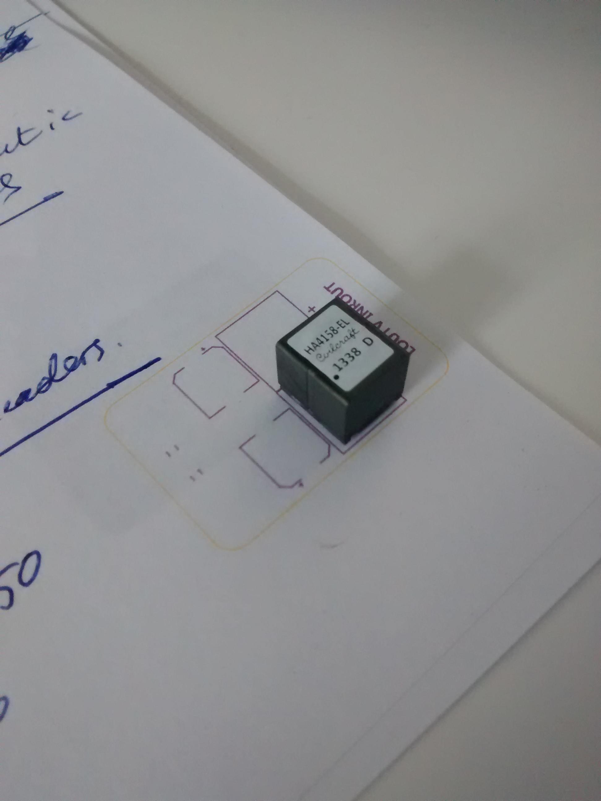

Anyway, got a couple Coilcraft inductors to play with. I really want to minimise SMD parts on the back side of the board, so I'll be using the through hole ones. This also means I don't have to worry about getting the power traces to the other side of the board as the pins are going right through, plus it makes it easier to hand assemble. And not to mention the huge mechanical benefits of through hole inductors. I'm a huge fan of SMD but especially in something such a portable speaker set, having large bulky SMD parts doesn't make a lot of sense if it can be avoided.
