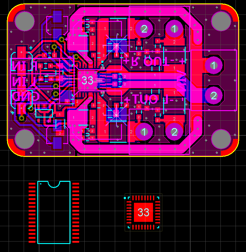

I did take a quick look (see attached) and I could probably make a TPA3116 fit on the board. I considered doing this but looking at my usual suppliers (Farnell, Digikey & Mouser) the TPA3116 is around double the price of the 3132 for small quantities, which is a surprise. I wonder why?

A browse through TI and I settled on the TPA3132. This is basically the same as the TPA3116 (I think) but in a QFN package. The first set of boards were 1.5x2.5" in size and were just the datasheet schematic. I was completely lazy and just stuck everything in one ground plane and didn't pay much attention to the layout.
So we built a few of the boards and even with the sloppy layout they sounded MUCH better than the ebay ones, and were already much smaller. He had paid for all the parts so he took the boards and left me one to play with. I gradually cut the thing up and tried different components to improve it as one of my projects on the side.
Fast forwarding to now, I've completed the assembly of a new amp, which measures 1.5x1", by about 3/4" high when populated, uses the TPA3132 with ferrite bead output filters, has far more responsible use of ground planes among other improvements. I also shoehorned screw terminals and connectors onto it, so it can be used with no soldering. BTW the input is single ended, as the idea of this thing is just to be plugged into a phone or something.

That's interesting. To be quite honest I've not done any more than glanced at the TPA3116 datasheet so I wasn't aware of the 1SPW option.

To take the last bit first. Yes, they were supplied as kits but the SMD parts were of physically largest kind that could fit in order to make it possible for even reasonably novice builders to DIY.
As you can see from this picture below the TA2021 is much larger than the TPA3116 (similar size to STmicro HSSOP36 size) so it is certainly possible. And it had full LC output filter as was required for that chip as it did not feature a filterfree operation mode like is standard on the TPA3116 (and the only option on TPA3132).
The size of the chip especially it's thickness allowed other components to mounted on the same side without interfering with the direct heat slug to cabinet bolting. Just like a TPA3116 a regular heat sink isn't really needed. To do the same with the TPA3116 you'd probably need some heat transfer material in order to fit components on the same side as the chip as the TPA3116 is too thin to allow this otherwise.
It's important to note that if you want to experiment with the 1SWP modulation mode on the TPA3116 that is it not a filterfree modulation mode. You must use full LC output filtering which leads me back to one of the most interesting parts on the amp32, the custom made dual output inductors. The only writing on them is "100 QY-" and I have no idea who made/makes them but they are very similar to the ones referred to below. It's the same incredibly compact physical package and most of the characteristics are the same as well.

As for heatsinking, the TPA3132 has the pad down of course, and with a fair bit of via stitching to the other side of the board I've had no issues with heat. Into a 4 ohm load at max input voltage it gets hot, probably about 60-70C. But at that power it distorts like hell anyway, and during all normal use it just rises in temperature, but doesn't get warm.

Also, I went to a bit of effort to source nice Camdenboss screw terminals and fit them on the board. Without the terminals I could decrease the size, although this would remove the plug and play capability. What are your thoughts on this?
If you're using the TPA3116 it's probably advisable to use an inductor capable of the full current even though it would hardly ever be used but it ensures you're reasonably safe even with low impedance loads. Coilcraft HA4158-EL (and similar) are still compact enough to fit but has even better data.
The idea behind using the TA2021 which is slug up (similar to TPA3116) instead of the TA2024 which is slug down (similar to TPA3118) is that you can route power plane directly under the chip and have ground plane exclusively on the reverse side. This makes routing far more optimal at the expense of requiring some kind of heat spreader, usually the casing itself.
I prefer (vertical) pin terminals for such compact boards. Screw terminals really takes up a lot of room, and anyone using such compact boards probably don't mind the small extra hassle. There's a lot of options of larger boards with screw terminals around for the multi-thumbed people.

They look like nice inductors. Not cheap though, to use such parts would increase the cost of the board by about £4-5, so if I was going to invest in a batch I'd have to be sure I'd have interest. Still, £22 or so isn't too bad... Or is it?
Well if I could do away with the screw terminals then I'd be able to have a much more convenient layout. Some beefy 100th spacing pin terminals would be much easier.

Please note that you should only do a TPA3116 version for your own interest to begin with at least. What you already have built fills the niche left and already ticks off all the boxes plus some.
I am still planning to use TPA3132, I'm simply looking at using full LC output filters. This would enable the amp to be used in a normal system without having to worry about short speaker wires etc... Anyway I ordered a couple items from Coilcraft and Ill modify one of the existing boards and see how it goes.
I was thinking I could perhaps have the existing version plus the LC filter model at a slightly higher price perhaps (still £25 or less).
