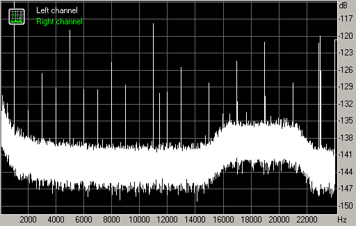

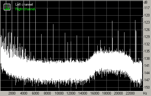

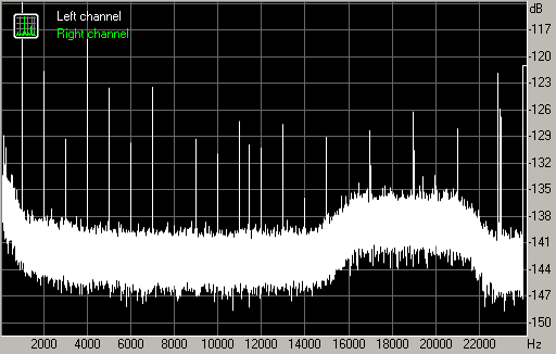

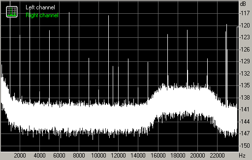

As an exercise I've taken the files I made of a selection of PCM63P-Y chips and edited together slices of about 6 secs for 7 of the chips. I then applied a notch filter to remove the 997hz test tone, and applied 60dB gain to the file. Because the gain is quite high you can hear low level digital noise bursts from the recorder writing to compactflash. The distortion from the PCM63's will be steady noise. There are glitches were the files are edited together so it's pretty easy to hear where one chip finishes and the next starts.
These chips were tested under identical conditions. The only change was to power down the D1V3, swap the chip over and power up. Nothing was physically moved, and no settings were changed. The differences are ENTIRELY due to the difference between chips.
The first 5 chips are from the batch A'af sent last week, and last two from the first four I received.
I measured the worst of the first six harmonics for each chip and got the following:
1. 53.4 dB
2. 55.1 dB
3. 52.9 dB
4. 55.9 dB
5. 47.0 dB
6. 54.0 dB
7. 57.2 dB
