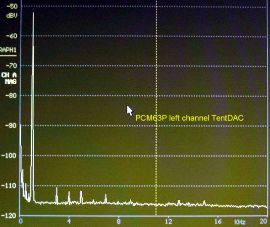

The measurements above concerned the left channel. The picture here is of the right channel.
With a signal of 0 dB the graphs from the left and right channel are equal.
Be aware that the noise flour depends on the FFT Size (4096).
I am using the Hanning Window.
Any comments?
Any comments?

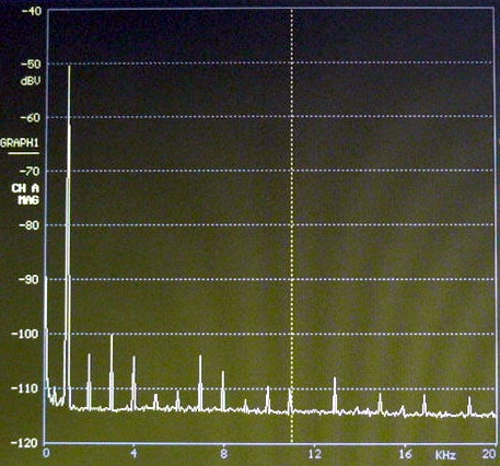

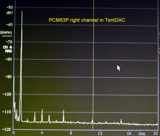

PA0SU said:and here is the right channel........
Remember the 10 dB shift of the analyser!
The P's are at least 10 dB better than the P....K's !!!
With signals of 0 dB the P's are equal to the P....K's.

In this picture -108 - -52 = -56 and other picture -58 which is normal, could be better, could be worse.
-50 for the K is bad.
Maybe swap chips between CD624 and tent and see what happens.

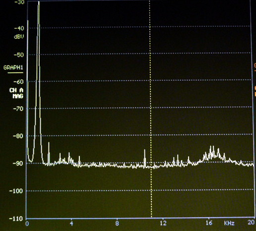

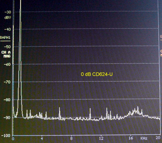

and the 0 dB measurement has been attatched here, but
WHAT (KIND OF) PLAYER IS THIS ????
Yes, it is a Philips CD624, BUT:
UNmodified. again: UN-MO-DI-FIED !!! with the SAA7320 as digital filter + DAC + IV-converter which sounds so poor that I use it to demonstrate the influence of a low-jitter-clock, reclocking of the digital signals just before the DAC (a PCM63P in my case) and a correct lay out of the PCB. These three subjects have been dissolved in the TentLabs-DAC.
My conclusion again is that the low signal distorsion far below the noise level of a recording (a concert hall has a noise flour of about -60 dB) is ABSOLUTELY not important!
I do not say that there is no difference between the sound of different DAC's of the same type, but it has NOTHING to do with the low level distortion you all are looking after. 😀 😀
The measured figures of this unmodified CD624 are better or at least equal to those of my PCM63P's end/or PCM63P..K's in the TantLabs-DAC-construction, but the sound from it is UNCOMPARIBLE WORSE !

Hi PA0SU,
Your tests don't seem to back up your claims.
The noise floor on the -60dB links CD624-U is clearly less smooth that the one you show for the tent dac. I'm contending that the spikes visible in the noise floor are just as important as the peaks of harmonic distortion.
Referring to your graphs the noise floor in the tent-labs dac drops as frequency increases and is relatively smooth. The CD624 displays numerous spikes, and a rising noise floor. I'd say there is more than ample difference visible in your posts to suggest the DACs will perform differently.
I've reread the Audio Precision app note AN-5 - "Measurement Techniques for Digital Audio" and the author recommends using dithered test signals to get best detail from low level signals. I'll stick with my current test tones for the moment.
Also take a look at http://www.digido.com/bob-katz/dither.html Part II is most relevant.
Bob Katz claims that sounds down to -115dB are audible on a well dithered CD. That's just a little lower level than -60dB.

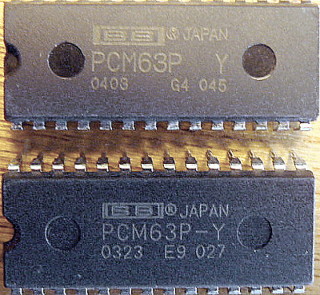

By the way, my further experiments can go on. I just received a number of PCM63P (-) Y's from our friend A'af......
