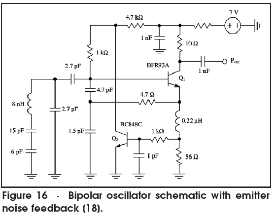

I have always had this curiosity, about the circuit attached here - this would act on the lower spectra 1/f noise - why is it that nobody is using it in audio Xtal oscillators? There are some hidden drawbacks maybe?
Otherways, as regards your oscillator, -110db at 10Hz, very nice!

George: Figure 16. Bipolar oscillator schematic with emitter noise feedback (18)
Quote
Unquote
I missed the attachment of you for one reason or another.
My comments are:
- this oscillator runs on 1 GHz or about,
- the current in Q1 is at least 15 mA,
- the behaviour of oscillators on frequencies 100x higher than the frequencies we are talking about, is totally different,
- the circuit is for a dedicated frequency,
- the circuit is hardly reproducible.
For this reasons the diagramm is useless for our purposes.
I leave it to these comments...........

Dear Herb,
I know that the shown circuit, as a whole, was designed for HF, and as such, much more noisy than a 10MHz oscillator. I just wanted to point out the application of the emitter noise feedback technique, which is effective only in the low frequency range, and to quote the orig. article, "leads to a significant reduction of the low freq. noise to carrier modulation or flicker noise upconversion." They claim a simulated 40db, real ~20db reduction close to the carrier. [They show it from 100 Hz - 100KHz, but it works from DC]. In other words, [still from the article] this feedback acts on the nonlinearity of the active element, in a similar [?] way like your AGC kills one of the birds..
But I'm ready to accept the bashing, this is exactly why I was asking it from an expert like You, what is the possible drawback for it in an audio application...
Ciao, George
Ps.: As regards your circuit, I think I did not make it a secret that I find it really attractive, especially the clear and simple way as You deducted in the paper - it is to be tried, without doubts!

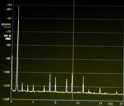

Hi folks,
here are my first measurements on my CD624 with a PCM63P....K. For pictures: see the home page of my web site.....
On my analyser a -60 dB signal has been displayed as -50 dB, so the noise flour is more than 120 dB down with an FFT size of 4096.
The 7th and 11th harmonics are more than 50 dB down the -60 dB signal of 991 Hz from a home made test disk.
