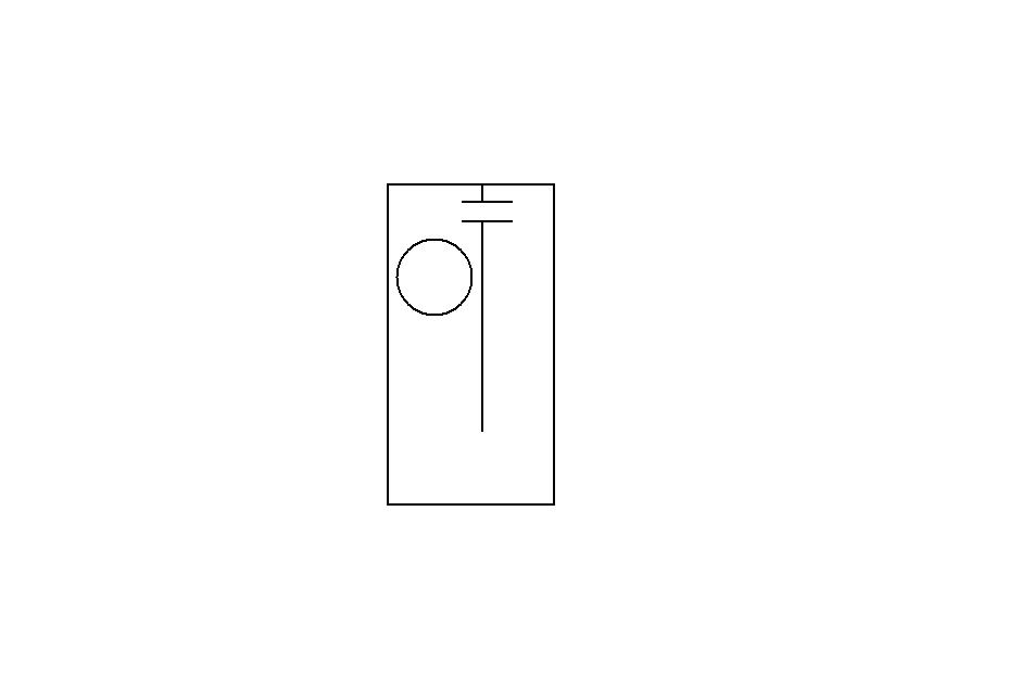

Let me ask you, does the box you are showing have any port going outside the box?
I expected it would look strange
No, completely closed
Closed mass loaded pseudo TL🙄
I will see if I can spot a good woofer
Which direction to take it depends on whether it works and how
If at best, low bass with low Qts driver, and still being a closed system
