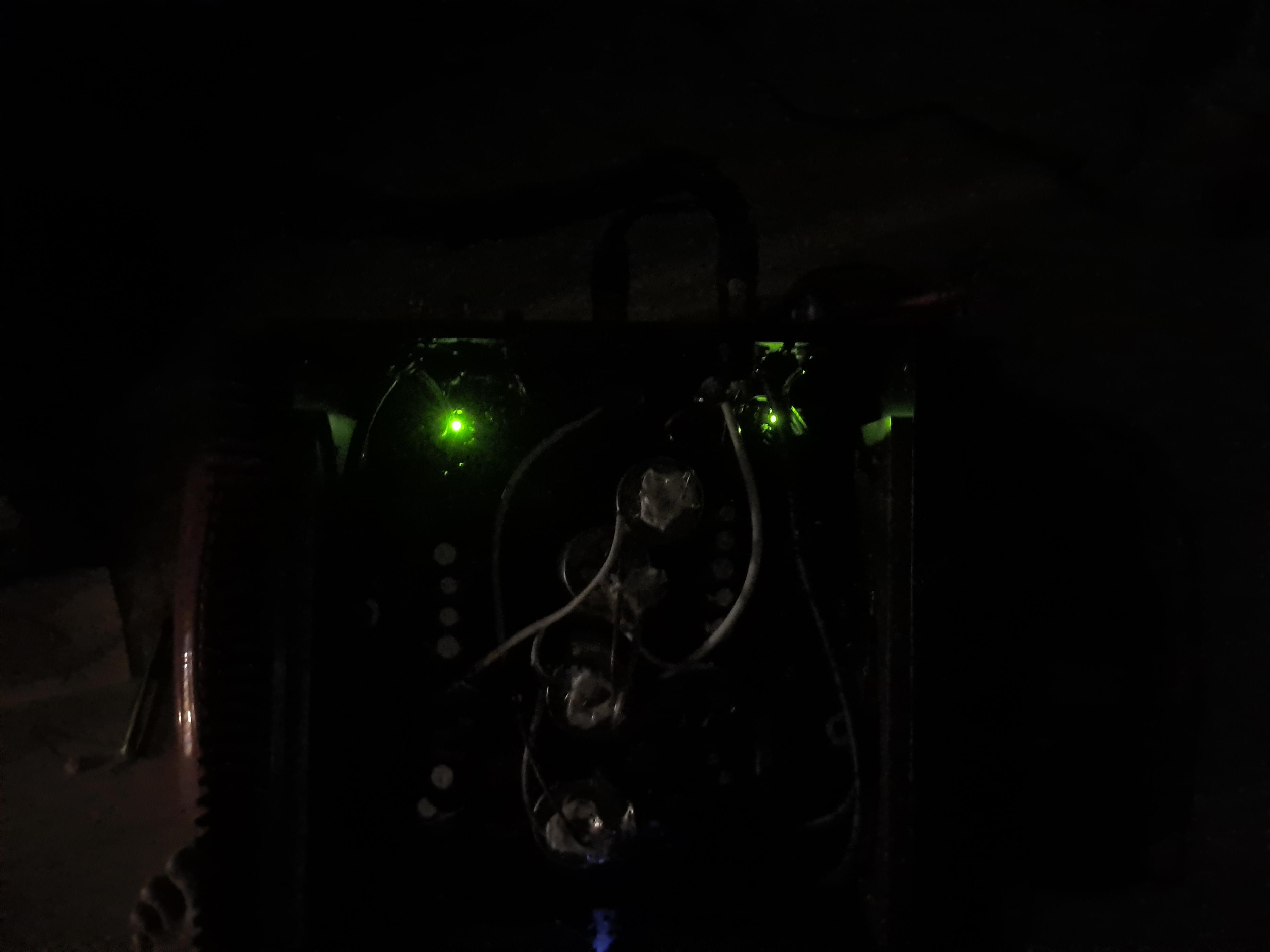

Its alive with bonus board!!
Planning to add RC delay later.
Hi Fff0,
Nice! Your photo is of darkness and two LEDs which I presume are the SSRs? Do you have a lighted photo you can share?
Ha, my work is messy and lousy thus didnt dare to take a brighter work. Added 88Mohm to form a RC delay with the 4.7uf.
Tapped from existing supplies, luckily no ground loop heard on test speakers.
Initially, the bonus board output is wrongly connected but the 3 boards tolerated the error.
Somehow i believed it work as i accidentally short the speaker output and it turned off.

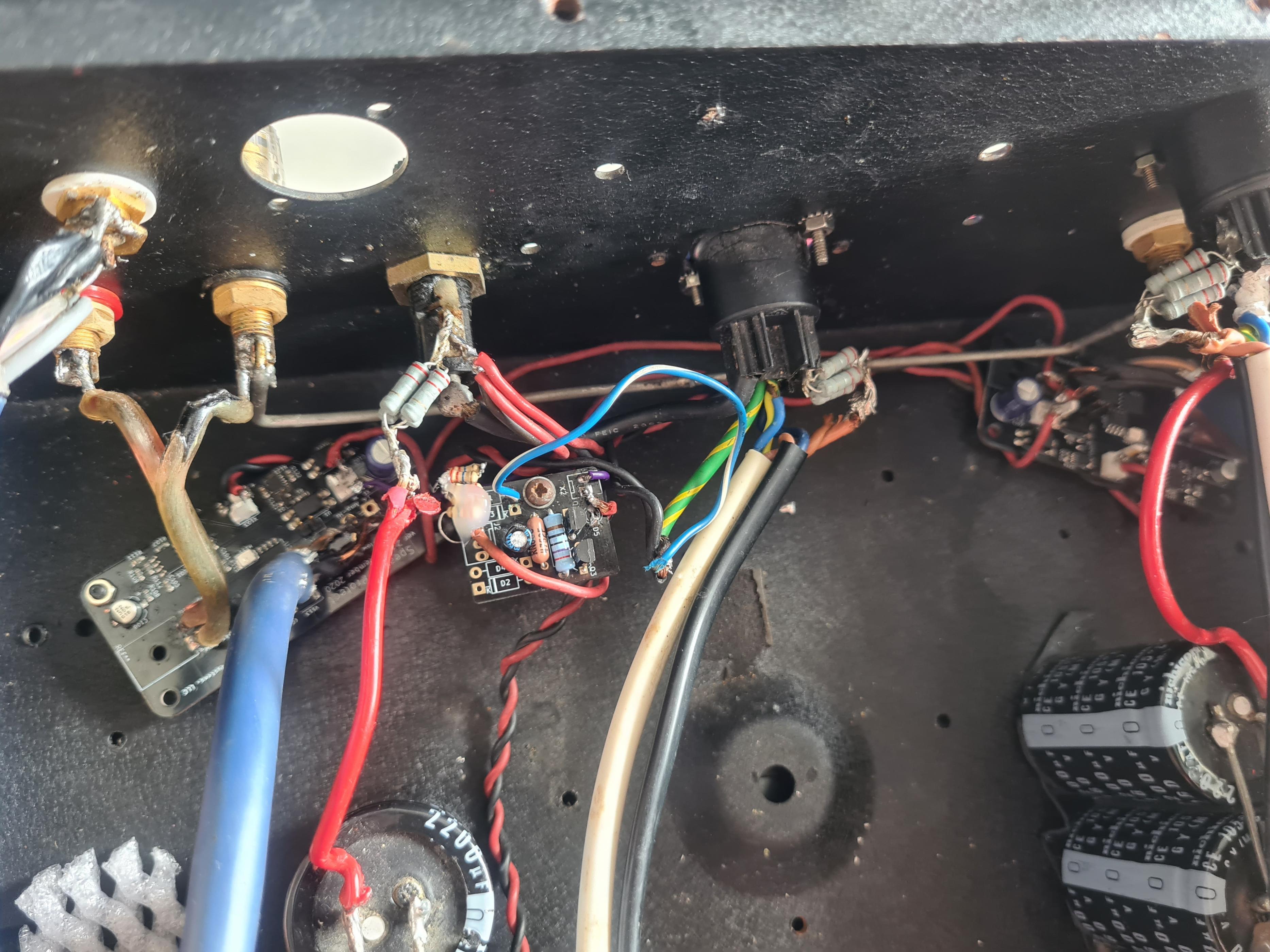

I’ll try to provide a better connection picture for the instant shutoff bonus circuit. Your solder joints could use a hotter iron. I feel like you may get some cold joints. Crimp Molex connectors were provided with the SSR. If you want to solder wires directly, remove the Molex KK header pins and solder to the board - not to the tips of the pins without insulation that’s asking for trouble. Also, you have a lot of exposed solder joints on what looks like high current or high voltage circuits. Be careful! Use crimp connectors for best reliability.
I have the bonus boards setup on the Xmas Amp and will go in and take some closeup photos of how this is hooked up:

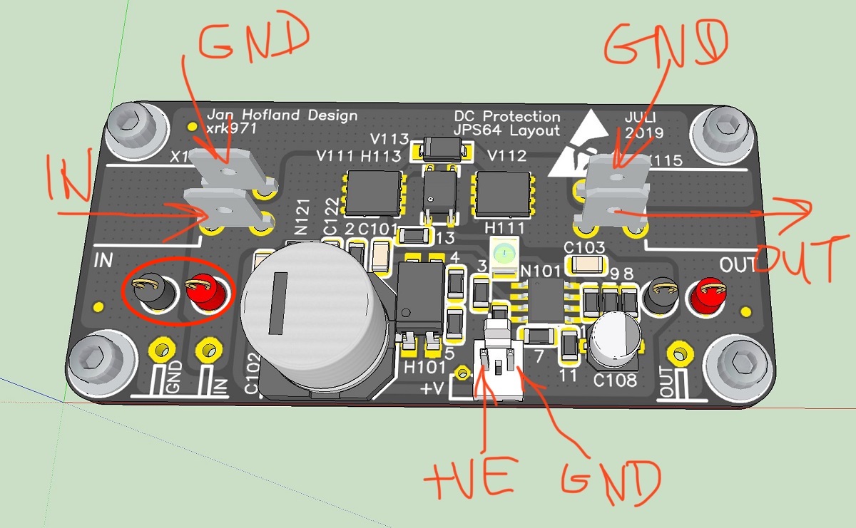

I would use the larger holes where the Fastons are soldered. The circled is for test leads but could work.

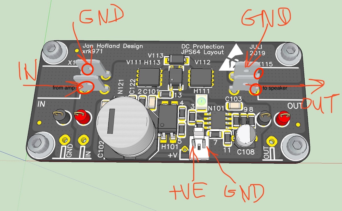

Is your amp a BTL (bridge tied load) amp where the -ve terminal is not 0vdc? The gen1 SSR does not have an isolated -ve speaker connection. On Gen2 it is isolated.

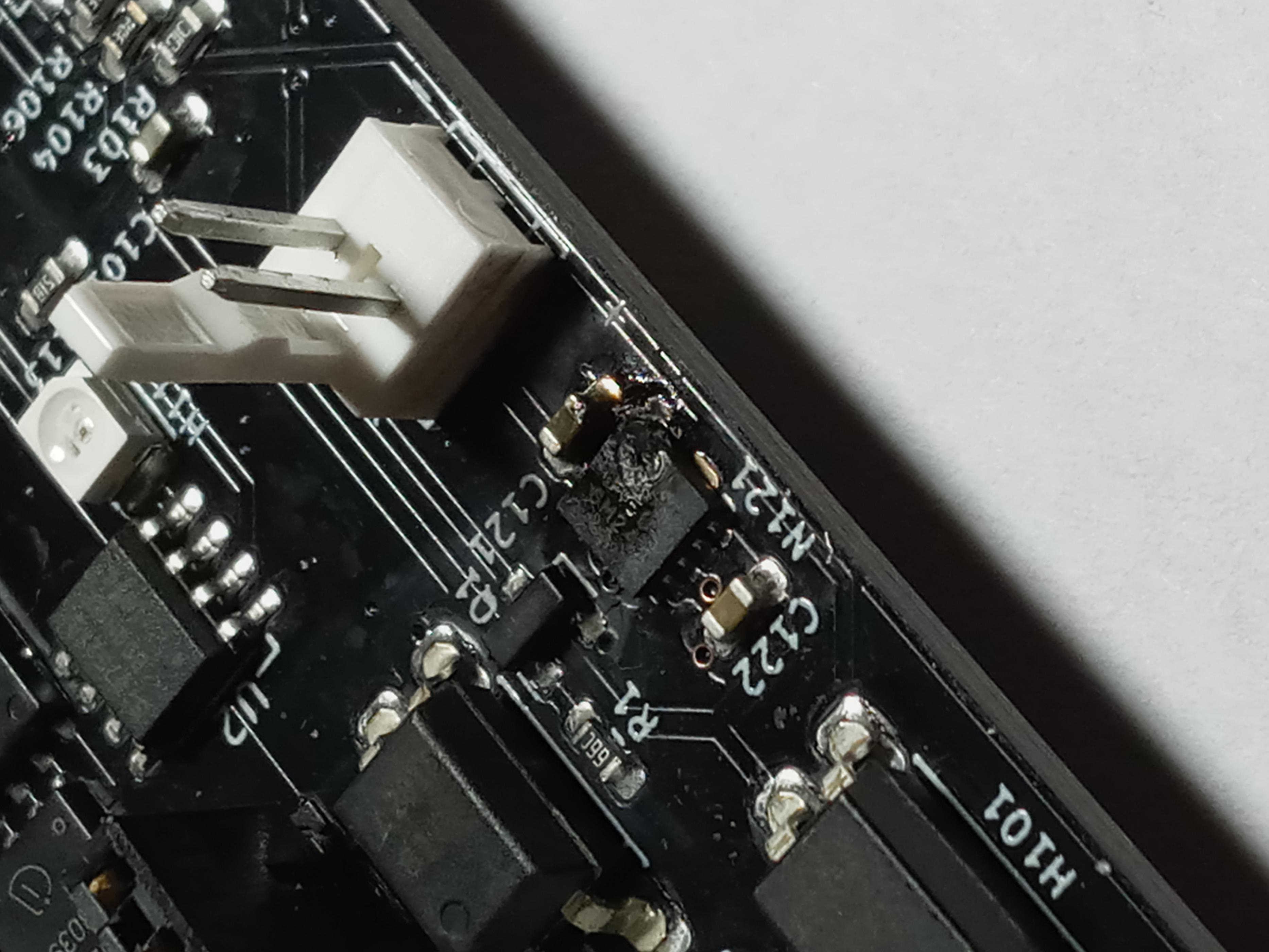

In over 27 years of slinging solder, I just failed my first smoke test! Before & after this bit of excitement I checked and double checked all the wiring connections to the SSR boards so I'm at a bit of a loss to explain this. It was installed on the left channel of my fh9hvx.
I removed the board right after it went bang but I could hook it all up again if you want pics but here's a bit of info:
Neither boards LEDs lit up.
I was not yet using the remote boards as I hadn't populated them yet. They were powered from the amp boards' SSR 2 pin headers. The All C's psu tested near perfect at +/- 51v but I didn't check the voltage at the molex pins which might have been a bad decision but other than a catastrophic short somewhere, what could have caused this if the fault wasn't on the ssr board itself?
