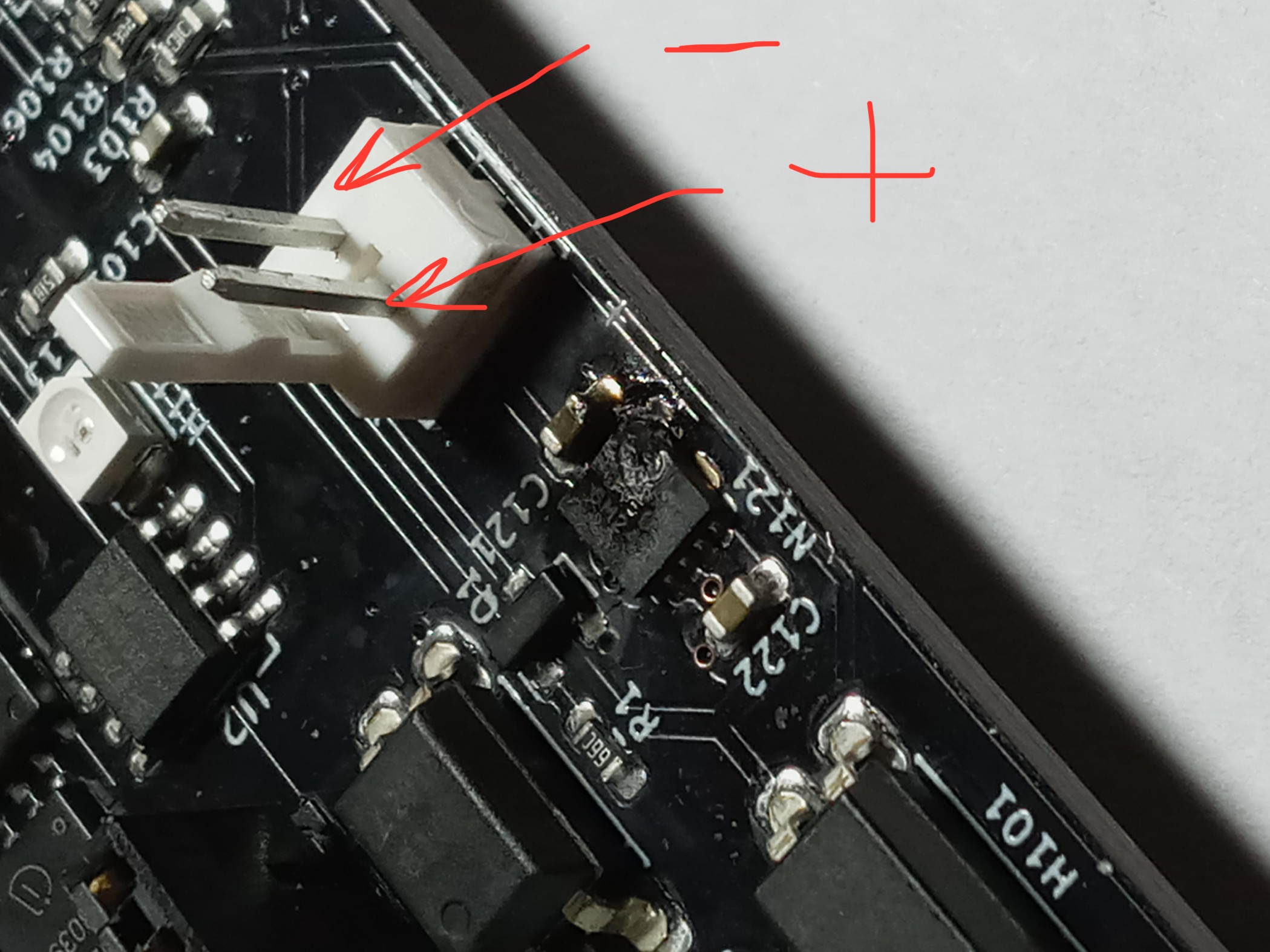

You have fried the on board 15V regulator. The only obvious thing that comes to mind that might have caused this is a reversal of the input power connections. The regulator itself is rated to 150V.

Sorry about your magic smoke session! 🙂 Did you have your power supply polarity hooked up as follows? This is the correct way.
It’s an easy fix - I can swap out a new voltage regulator for you. Send them back to me and I’ll take care of it, you just pay for shipping. If I can’t fix it, I’ll send you a replacement Gen2.

X & Vunce,
The board was wired exactly the way you show in the pic.

Hi Legis,
Are these Gen2 SSR’s - I think so, because I notice the markings show a + next to the power input header.
That’s strange that neither of the LEDs lit up because I test each one for that fact before shipping them.
Can you take the one that did not blow up and apply something like 19v or 24v from a small power supply like a laptop brick? See if the LED works then.

SSR output voltage
Before I try what you suggested I have to ask this question. I checked the ssr output header by placing my dmm black lead on pin 1 & red on pin 2 & got -51vdc on both boards. Shouldn't it be + 51v?

It seems I fried the regulators on both SSR boards! There just wasn't any fireworks on the right board & I couldn't see the damage untill I removed it from under everything on the back panel. Dang!

There are two Molex KK output headers on the All Cee’s psu board,
X121 = +/G
X124 = -/G
You need to use X121 to power your SSR protection boards. You would get -51vdc if X124 was used.

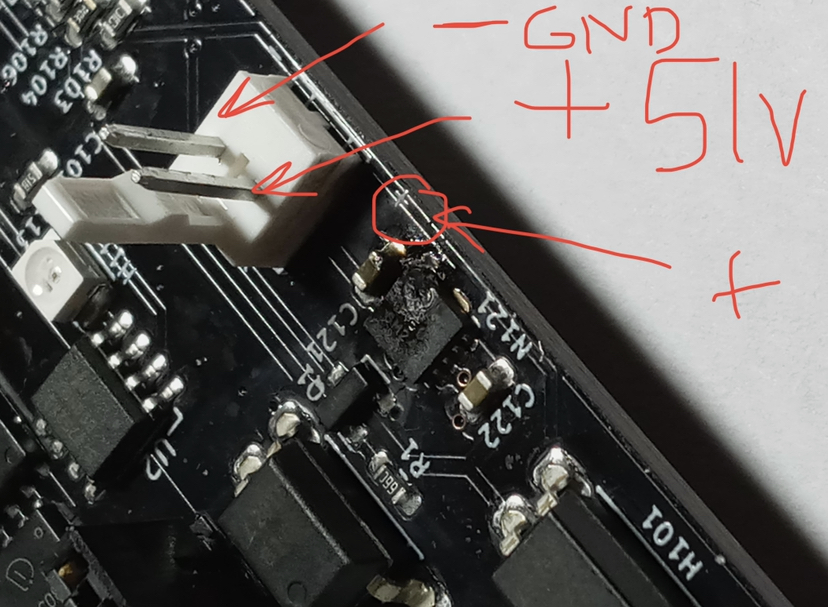

Hi Legis,
I am sorry, but there may be some confusion as to what is pin 1 and pin 2. And it depends on which way the tab is etc. please check your voltages according to the pin designation shown marked up in my photo. You can see a small +ve symbol on the silkscreen next to the side that is +ve.
So is your power cable from the PSU providing +ve 51v relative to the labeled +ve pin? That’s all that matters. Don’t go by pin 1 or 2.
It sounds like you had the polarity reversed - and I will need to put out a warning in the thread and on the shop listing saying this. It happens to all of us, and when in doubt always look at traces and see which is connected to the ground plane. No worries though, I’ll get you a replacement no charge.

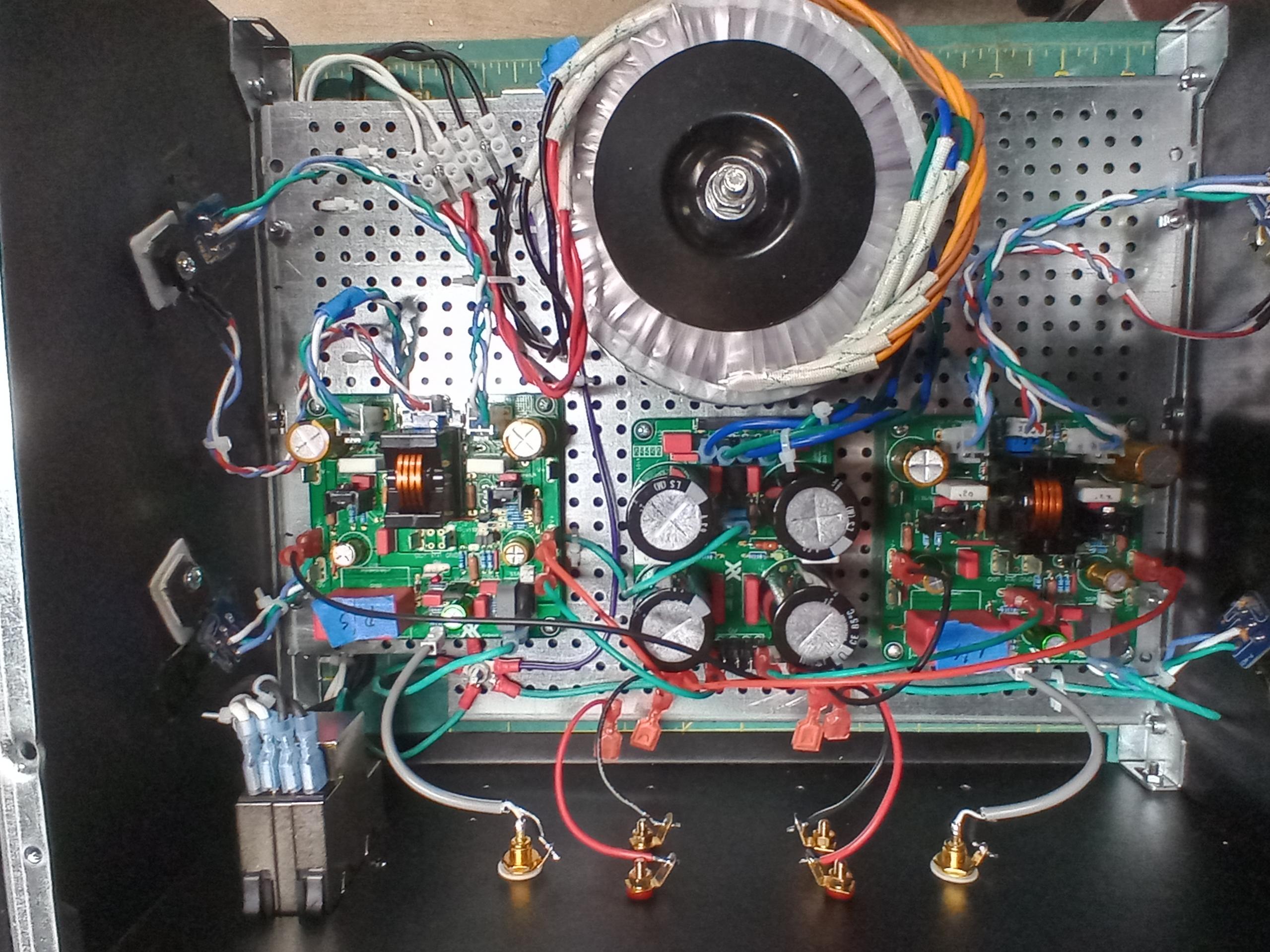

Powering the ssr boards
Vunce,
I had powered the ssr's from the amp boards & not the psu. If I use the + psu header do I have to hook up the ssr boards in series like X has suggested. When using the remote bonus board?
Gotta run some errands & I'll try and post a pic or two of the whole amp innards minus the now defunct ssr boards when I return.

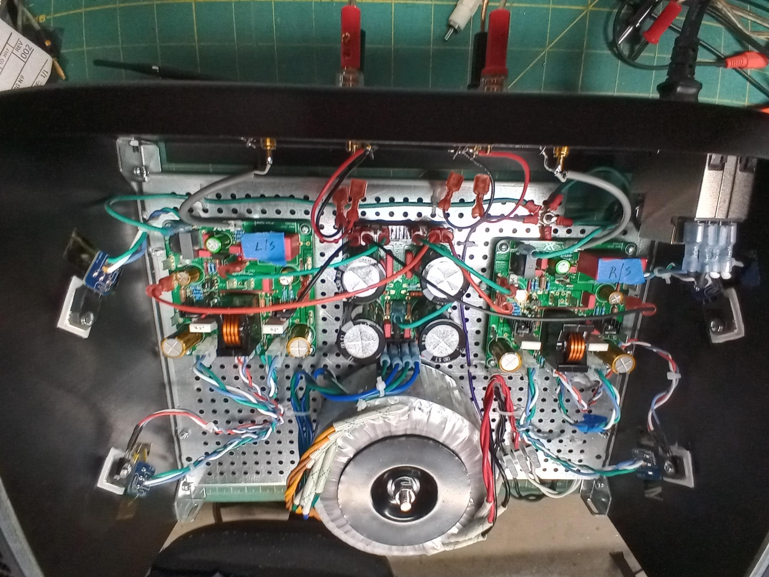

Yup, pics help lots 😉

Very neat work on your amplifier chassis installation. Superb work! Sorry about the SSR blowing up on you.
