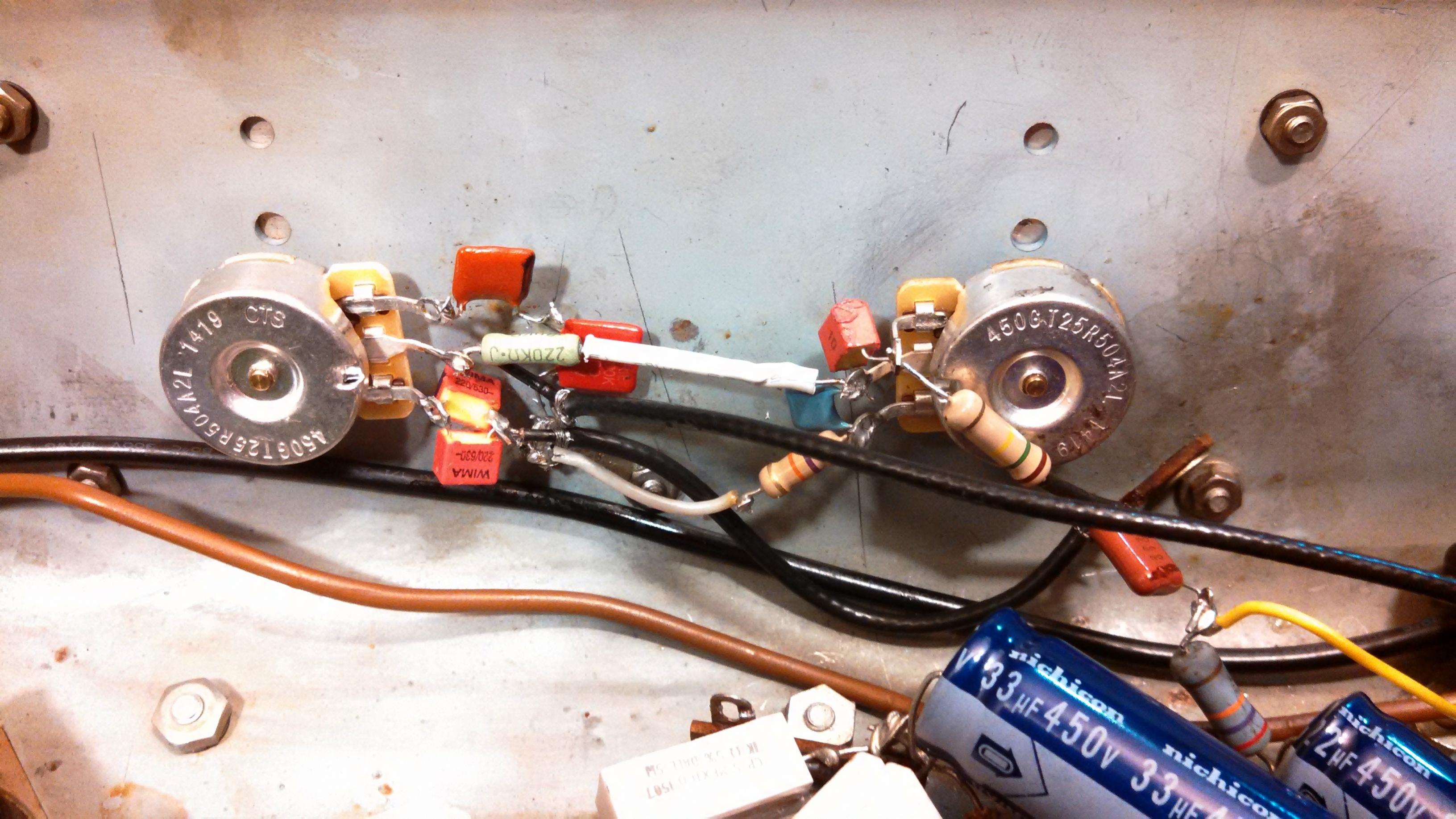

Question about Tonestack layout, antenna for 120Hz
Must be 18 or older to view this picture, because the Tone Stack is Dirrrty!

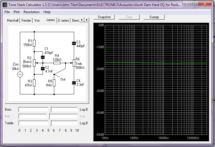

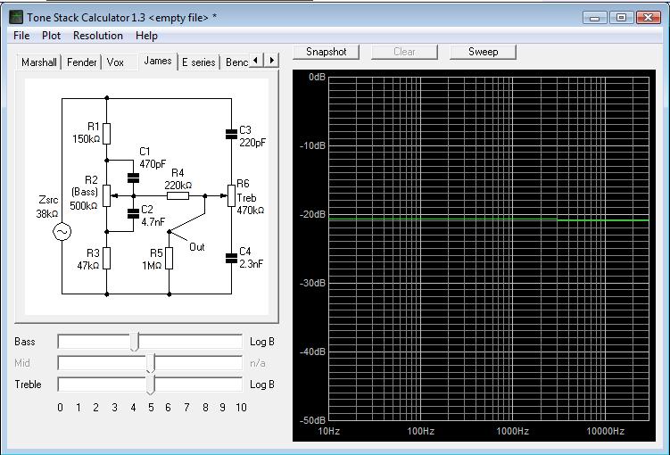

The second photo is the schematic of the tone stack. Why is it that the conductor that transfers signal directly from the coupling cap to the treble cap introduces much more 120Hz noise than if it was non-shielded? I have installed this wire both ways, shielded and non-shielded, and there is more than twice the peak voltage entering the signal path. Is the cable "capacitive coupling" the signal from the shield to the center conductor? Is there anything I can do?
Orientation: The bass pot is on the right, treble pot on the left. Bottom left you will see two wima's in parallel, this is the treble cap. Originally, the bass pot was mounted with the terminals facing right, and the cabling was much longer. I rewired with the goal of stopping a HF oscillation that occurs when the treble pot moves past 60% of full rotation in the "treble boost" direction.
I'm going to post this message, then build a faraday cage around the sucker, using the four screws in the photo to mount the metal cover. I've got to finish this amp tonight, and I'll do whatever it takes, but I'd also like to learn how to prevent real issues like this from an electrical standpoint (ie: without tin shears!)
I think the leads are still too long, and the treble-lead is the most troublesome. I moved the 150k and 47k resistors right to the edge of the high impedance soldering point, the same way that we would mount a grid stopper. I wasn't sure which side the 220k should go on. Some of the caps, the non-wima's, are sensitive antennas, but they are the only caps I have with the value I require. I have tested the cases of the pots by connecting a ground lead to their shell, and it appears to have no effect. I will run a buss wire from both shells to ground.
