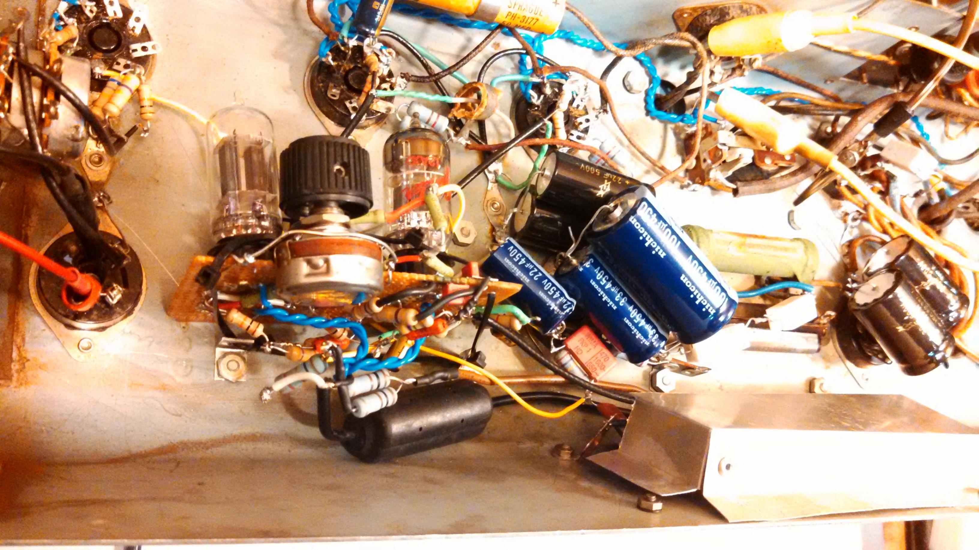

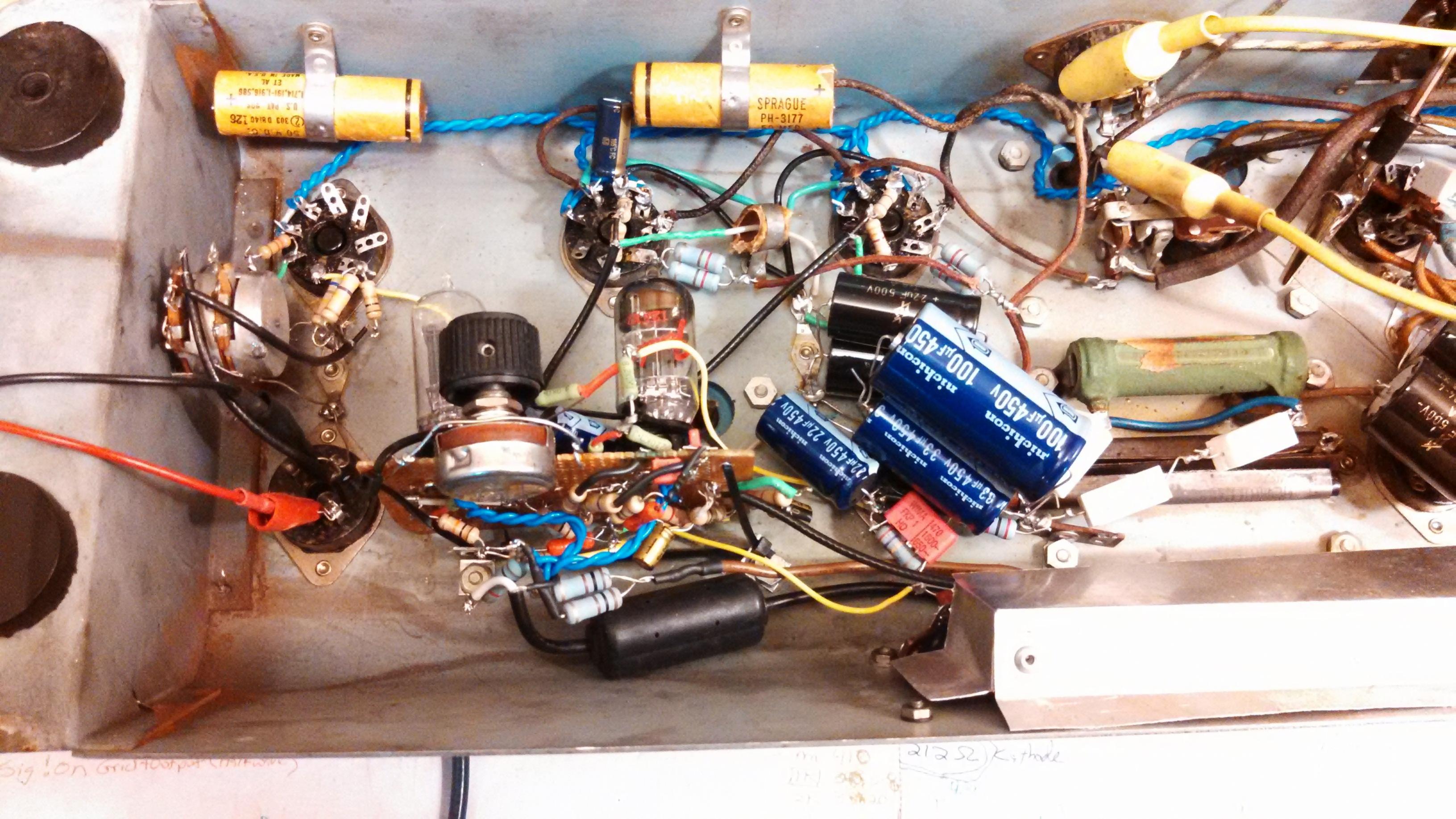

Isn't that a B+ cap right below the tone controls? If it is an "early stage" B+ filter, that's big buzz voltage a few cm away from your sensitive tone network.
Yeah, I know. The caps will have to be moved if this TS shield doesn't work. The caps are mounted to the socket pins of a former "canister" style cap that housed two or three smaller value caps. The canister was mounted using an octal socket base.

Output ripple is magnified with use of the bass control (input signal related). What can be done to shield the 8" of B+ conductor bringing the audio signal from 6J5 to plate resistor to TS (long yellow wire from top left of amp, underneath "card" and to shielded TS)? The plate resistor is right underneath a bunch of filter caps, as is the coupling cap leading to the TS. The shield is not fully mounted, but is grounded.

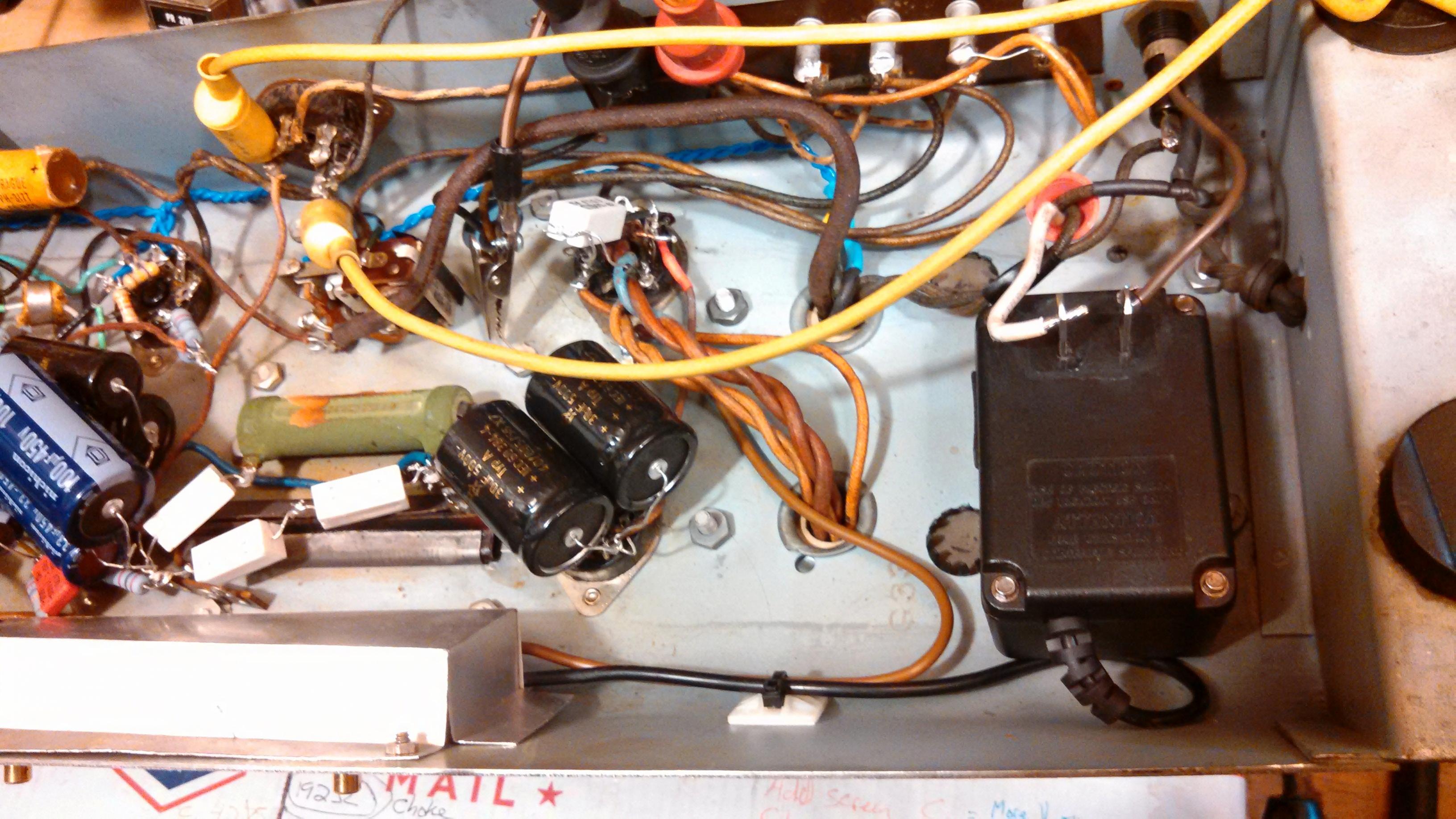

More pictures and questions about layout. I won't be hurt by comments about how "back alley" this looks, it's my first expression of audio engineering and I'm damned proud of all that it takes to get this far.
So far, it looks like there's something to be learned about the placement of filter capacitors. In reading, it sounds like a good idea to place a filter capacitor nearest the stage it is filtering. To expand on this topic, the placement of filter capacitors must also depend on how much ripple current is remaining on their supply when it leaves the capacitor. Is this solid theory so far? If so, I will likely be moving all of the filter capacitors in the middle of the amp, nearest the TS, power tubes and DIY card, to the right hand side where C1 sits. I will also order some larger value caps so that they aren't "double-stacked" everywhere. Would some like to comment on this idea? My customer wants the amp now... I want it done right.

Wires that need shielding "usually" don't carry high DC voltage.
Shield the signal wires (low volt), don't try to shield B+ wires.
Plagiarize, plagiarize, plagiarize!! "Study" every gut-photo you can find. Guitar amps often have layout diagrams.
