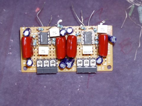

I’m sorry I didn’t explain myself clearly. I put all the components for the servo circuit on a board and I was wondering if I could test it without connecting it to the preamp. I would like to check for mistakes.
Hi Jaudio
you will have to connect it to the preamp. it works by checking the voltage on the output and compensating for it on the input. (just dont connect the preamp to you power amp)

jaudio i assume that you have a AD815 working. if so you can test it directly on the module, that is to say if you build it according to my schematic. if so then you will be ok and it should work first time
Would a single 160VAC, 0-18, 0-18 torodial be enough to power both channels or do you need one for each channel?
rudi said:jaudio i assume that you have a AD815 working. if so you can test it directly on the module, that is to say if you build it according to my schematic. if so then you will be ok and it should work first time
I tried the servo today, the ad815 got hot. I checked Rudi’s servo schematic and noticed that the 100K resistor to ground is not on the schematic. So I have two questions.
1 There should be no 100K resistor
2 How warm should the ad815 get.
